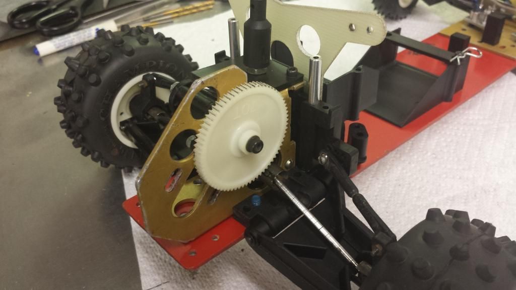

saved from the closet: late 80's RC10 with vintage hop-ups
- mk-Zero
- Business Member
- Posts: 1678
- Location: Orange, CA
- Has thanked: 4 times
- Been thanked: 21 times
Re: saved from the closet: late 80's RC10 with vintage hop-u
Thanks guys. I'm pretty happy with how it's coming out so far.
- Asso_man!
- Posts: 3960
- Location: EU
- Has thanked: 40 times
- Been thanked: 82 times
Looks great indeed, I would get rid of the blue screws that are not really period correct and ditch teh front shock tower, replacing it with either a stock or long Jammin Jay one. Now we want to see that nice restored early MIP tranny back on it!

Thanks. Yeah, I'm going to swap the screws out. As for the tower, its something I made many many years ago and is part of the history of this car. I know most of you guys probably don't like it, but as long as this car is on my shelf it will remain
Yes, next up is the MIP trans restoration and the shocks. I also contacted UltraHive about reproducing the label for the Trinity Joel Johnson 1987 World Championship motor, hopefully he'll be willing to do so.

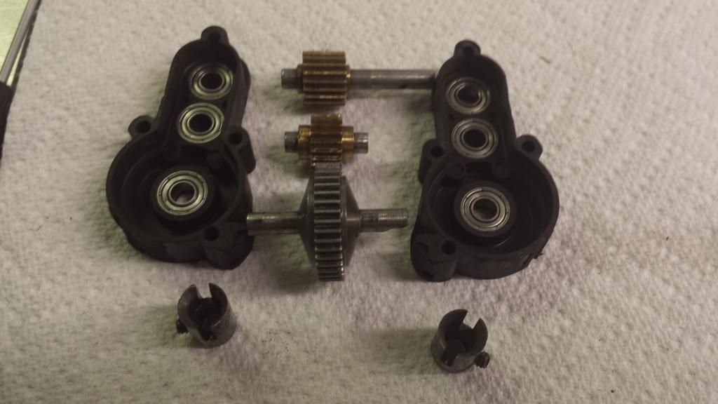

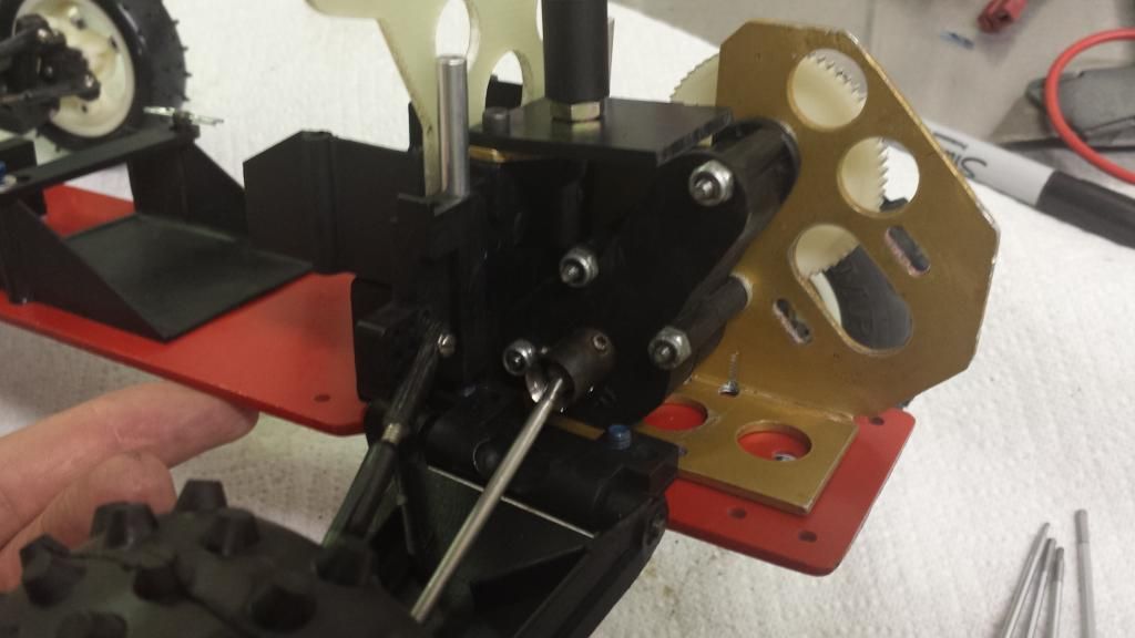

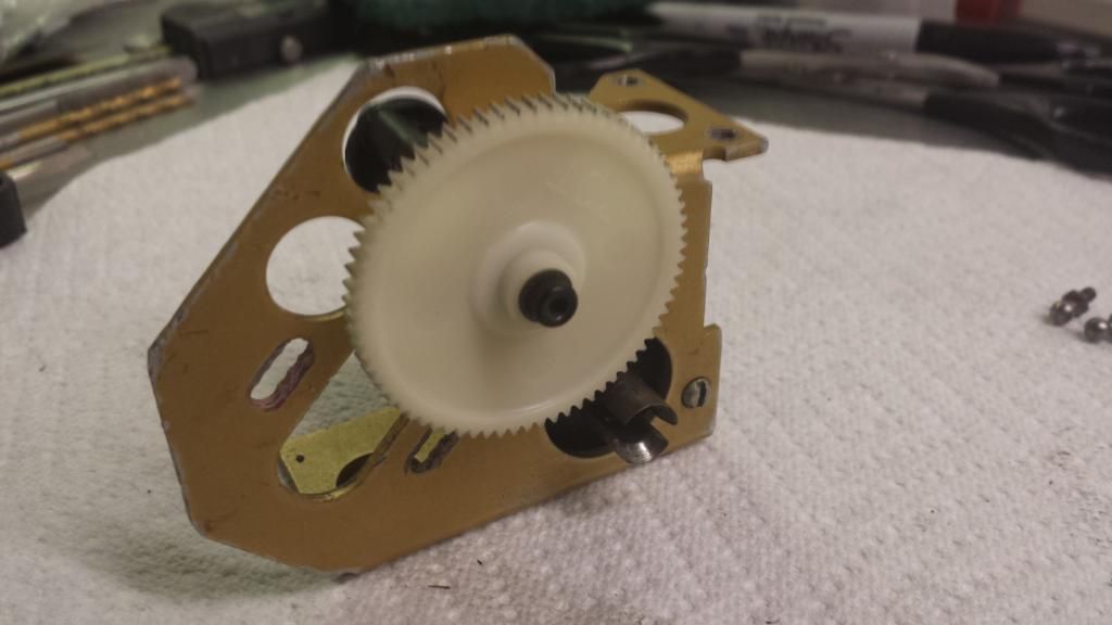

Went through the MIP trans tonight. Disassembled and cleaned

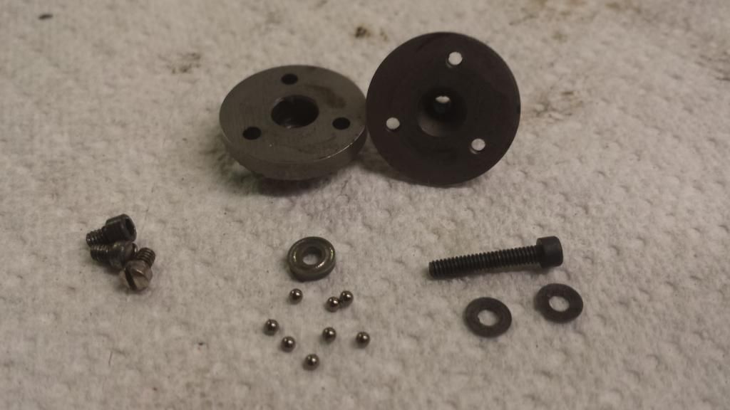

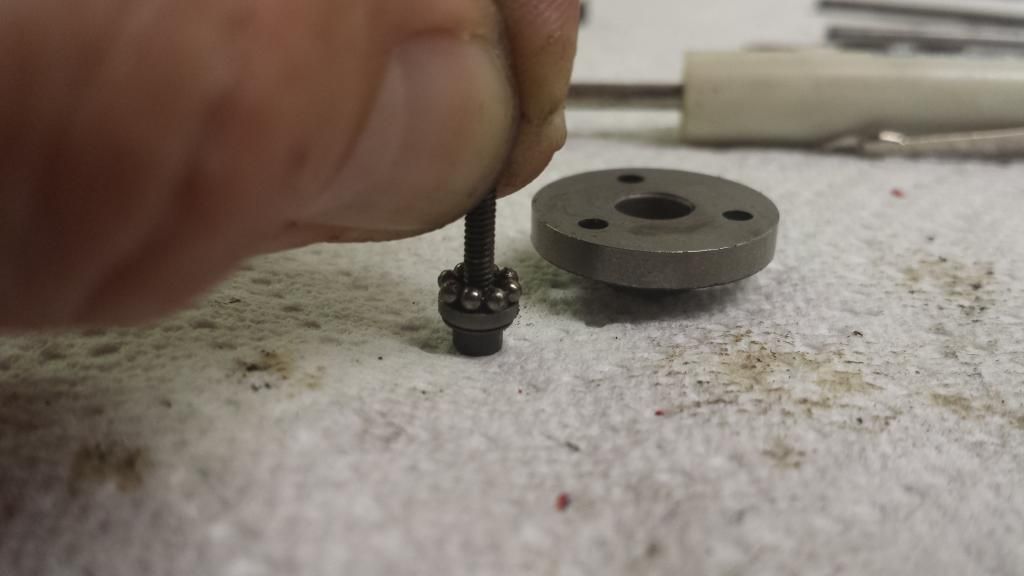

Thrust assembly. Note there is no compression spring, just two belville washers. Not much adjustability in there...

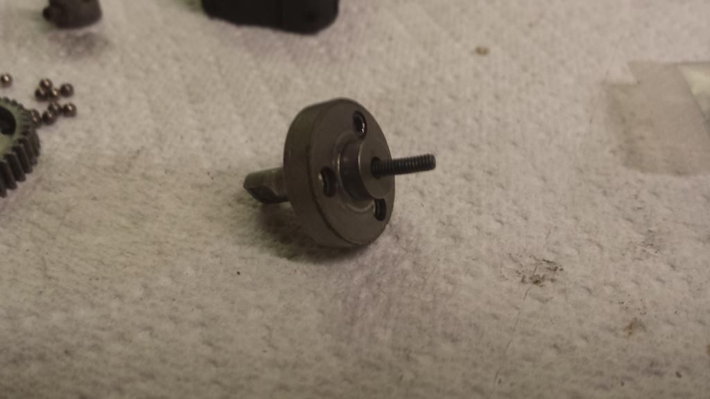

Putting the thrust assembly back together...

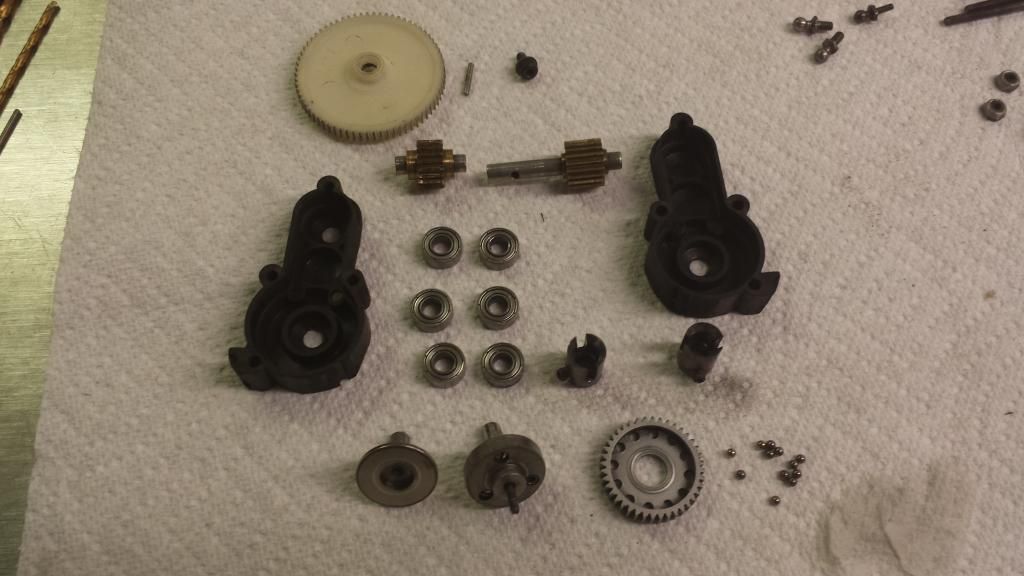

Ready for a little diff lube and reassembly

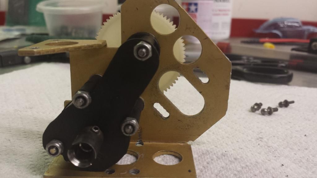

The two case halves are held together by 4 screws that run through the Hot Trick motor plate

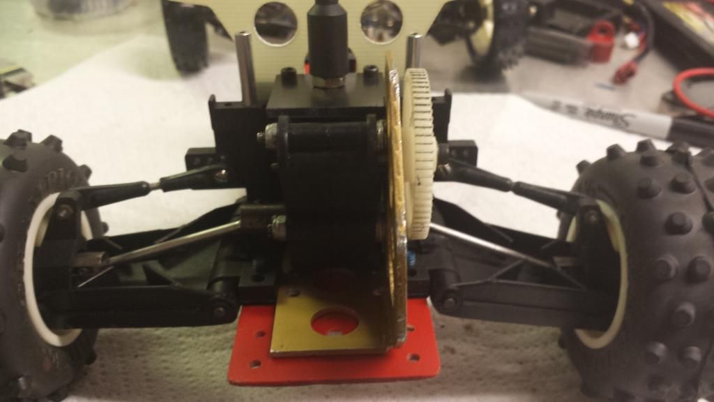

And finally back on the car.

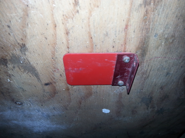

I have this old hot trick esc shelf that would be perfect for this if you want it!
Not sure why the pic keeps flipping upside down.
- mk-Zero
- Business Member
- Posts: 1678
Oooooo, cool, got pics, I've never seen one?
Oops, nevermind, didnt see the pic at first.
Where does it mount?
- Posts: 3608
- Joined: Thu Oct 01, 2009 4:34 pm
- Location: Puyallup, WA
- Has thanked: 668 times
- Been thanked: 881 times
It was mounted to a shock tower on a car I got along time ago I think you have to drill your own holes.
- mk-Zero
- Business Member
- Posts: 1678
Thats cool, I think it would be pretty neat on there. Let me know how much shipped to 92867.
