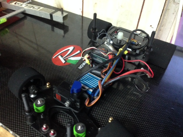

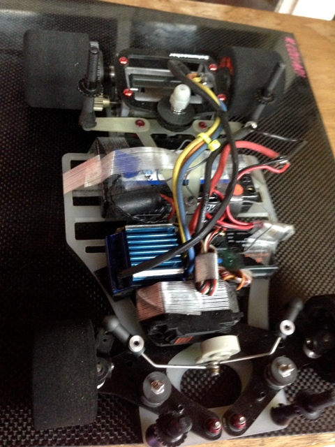

Just tried the C car on the track. Need some more modification to cope with the modern Brushless motor.

I use these spec:Peakey wrote:Looks good pal what setup do you have in it and how dose it drive
LRP 4.5T X 12 motor
LRP TC spec. ESC ( almose 8 years old !)
IP 3.7 LiPO 90C 7000
Since the CG of the battery is too high, the car rear end will "swing" in the end of the long straight road, before entering the sweeper.
I will try to lower mounted the battery next time.
BTW, do u have the C car ?

Are your chassis parts copied in another material or dyed?

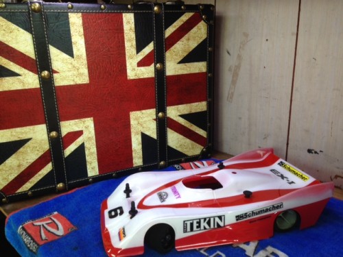

Awesome stuff! Would love to see some video of this running... looks ace with the TOJ body (I wonder if this may be contributing to the 'loose' rear end - if you've been used to a modern 1/12" car & shell?)
Can i ask what wheels & tyres you are using, i've often been tempted to get my RC12L up & running again - but with the different wheel fitment I either need to make some adaptors to run modern wheels or mount/glue & true new tyres onto old wheels... which all seems like alot of hassle!

It is all graphite material not dyed.LurkingCAT wrote:Good to se a C car rolling!

Will take a video when probably setup . I will use this C car to battle with the modern 1/12. You will see !!DerbyDan wrote:Awesome stuff! Would love to see some video of this running... looks ace with the TOJ body (I wonder if this may be contributing to the 'loose' rear end - if you've been used to a modern 1/12" car & shell?)
The front wheel is original Schumacher rims with Yokomo donut #3660M3, the rear is GQ tyres Super Soft, in black Yokomo rims and modern Yokomo diff. Super smooth diff. !

No, the TOJ should work well in my track. Of course the modern shell will give more advantages.
