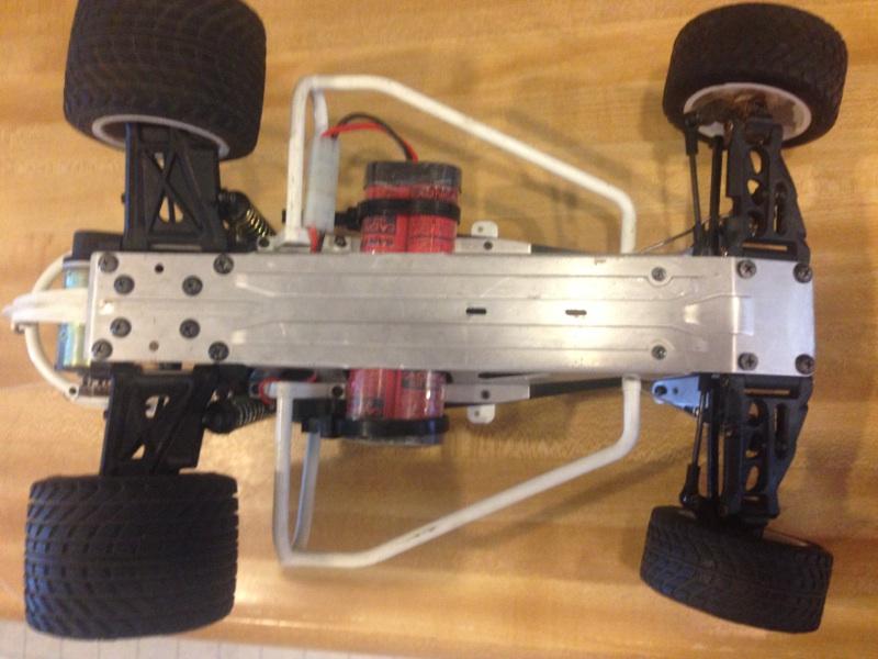

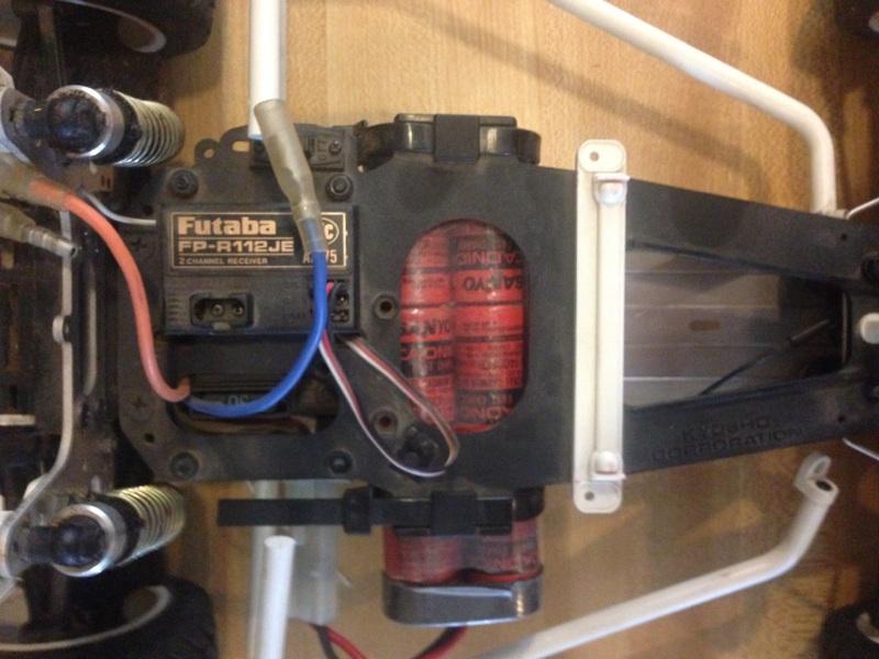

Thanks guys, finally something in black & white. My buddy has been sending in pics. Looks like nothing is broken. So might not need any parts. Still the ugliest sprint car I ever saw. The Losi Slider was even better looking. Lol

Looks like it is in great shape
I think you may just need a teardown/cleaning/reassembly.
I may have some parts for it if you find anything broken/missing. I got one as part of a trade.
Unfortunately, there were too many parts missing to rebuild the car
