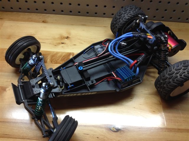

So, did you use the 3/3 rear arm mounts? With the washer underneath?JK Racing wrote:I ran this weekendlets just say, my set up was just fine. After running the gold pan for so long, jumping to the B3 feels like cheating. Car is so smooth and whisper quiet. I did lead the A main for a bit until my nerves got the best of me and I beefed it a couple times. Held onto third so I could make the podium.
Looks like a bit of toe-out in the front?
Did you run the shorty pack all the way to the back? (like the pic you posted earlier)
-dldiaz

I ran the 3/3 with the washer, I think the toe out is a picture thing, but I will look again when I get a minute. I ran the battery forward, and 5 squares of lead in the back to make minimum weight. I used a stud in front with a thumbscrew for the battery strap, the venom packs seem to be a touch shorter than most other shorty lipos, so they dont seem to flex the battery strap as much. I run one pad up front, then a long pad laid down after the battery.
