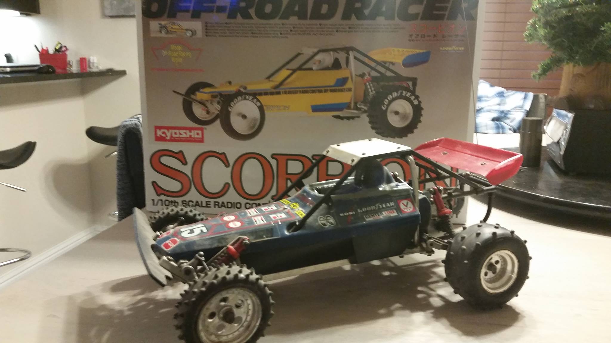

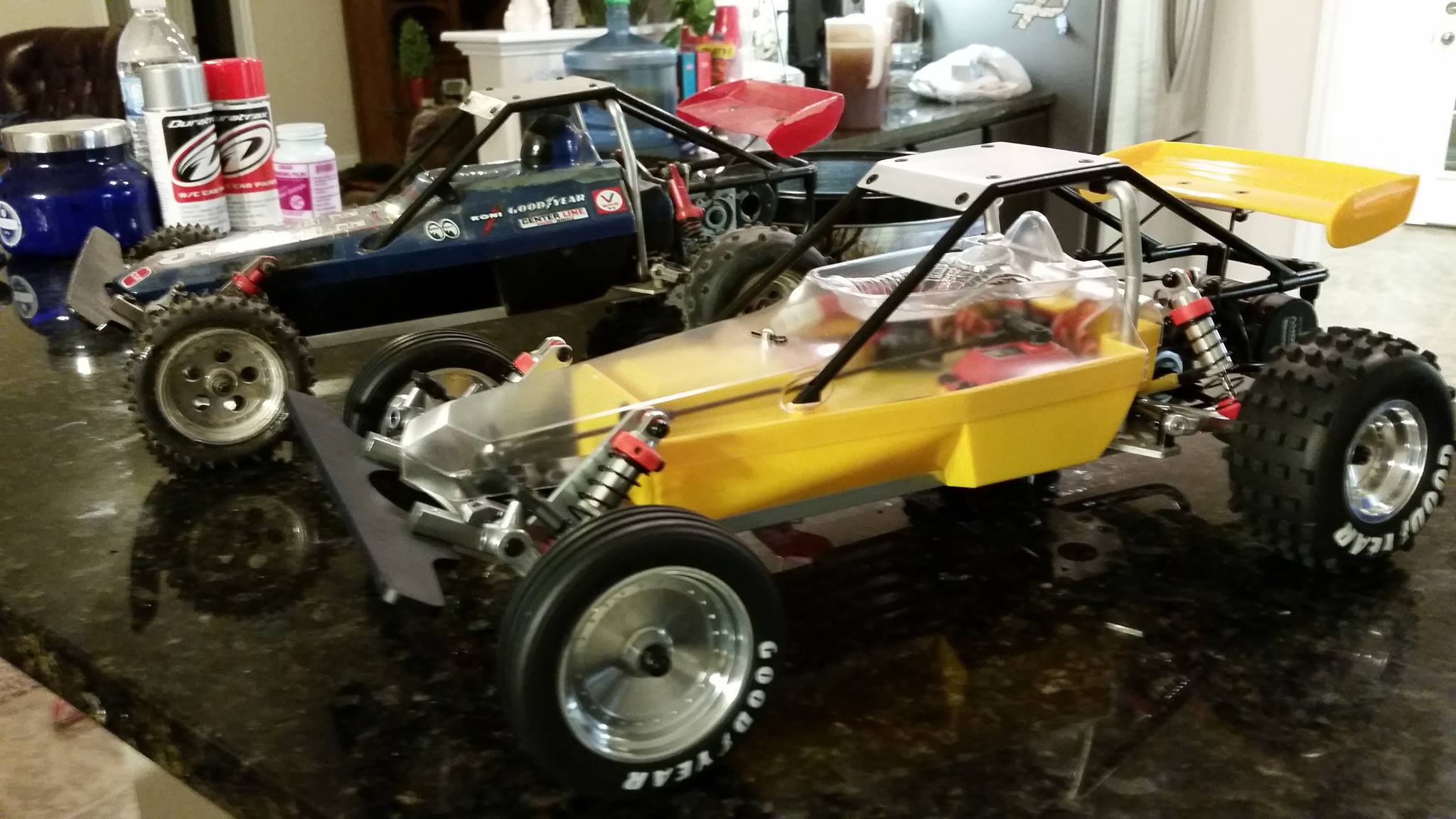

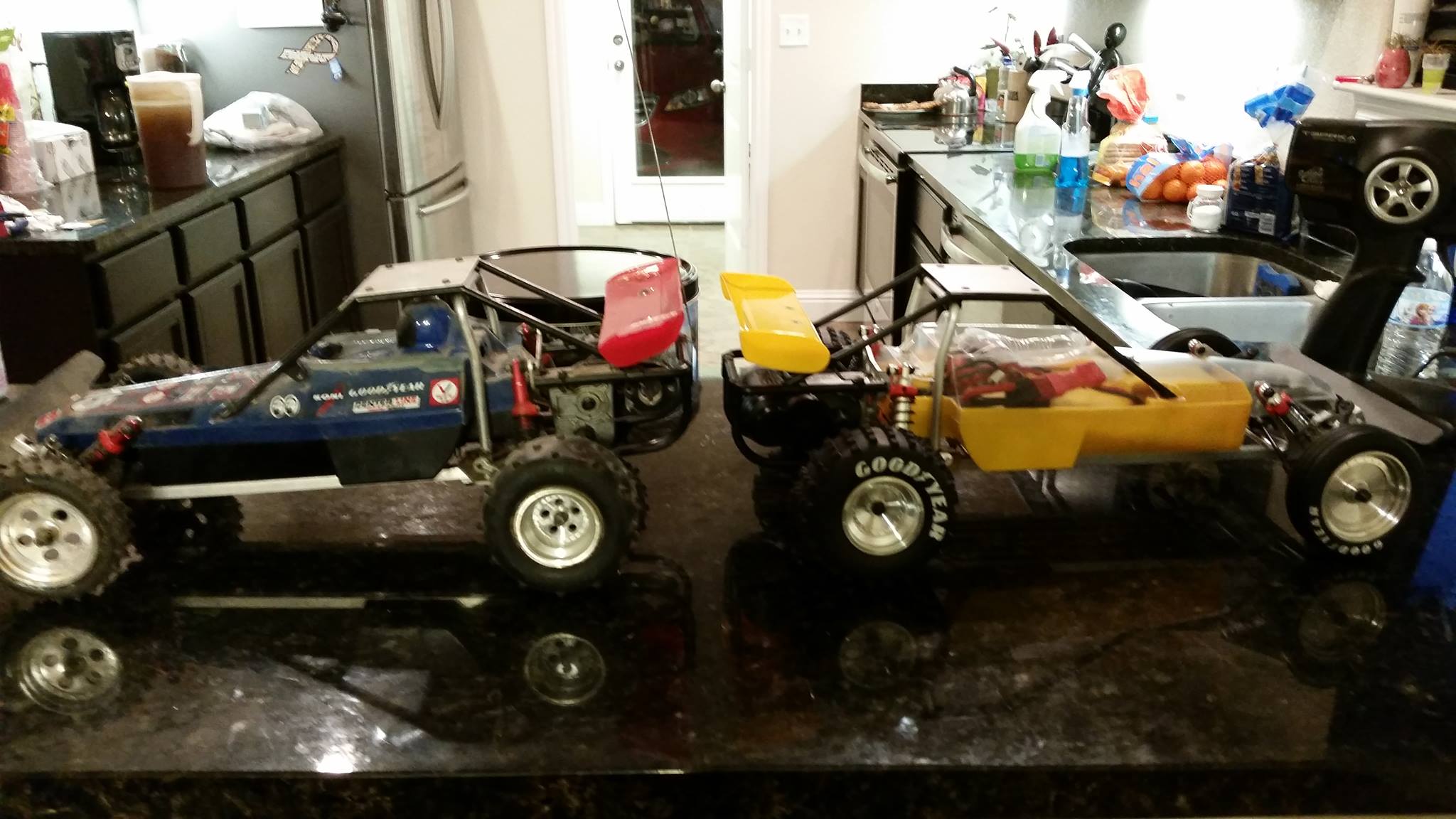

Just spent The Day Building My New Scorpion Here Are Some Almost Finished Shots With My Turbo Scorpion.

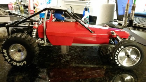

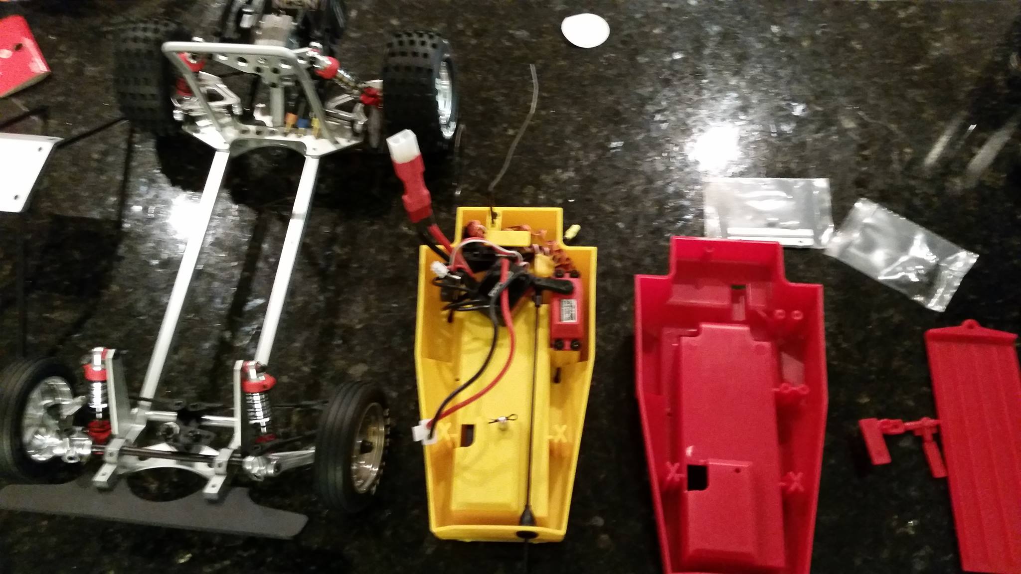

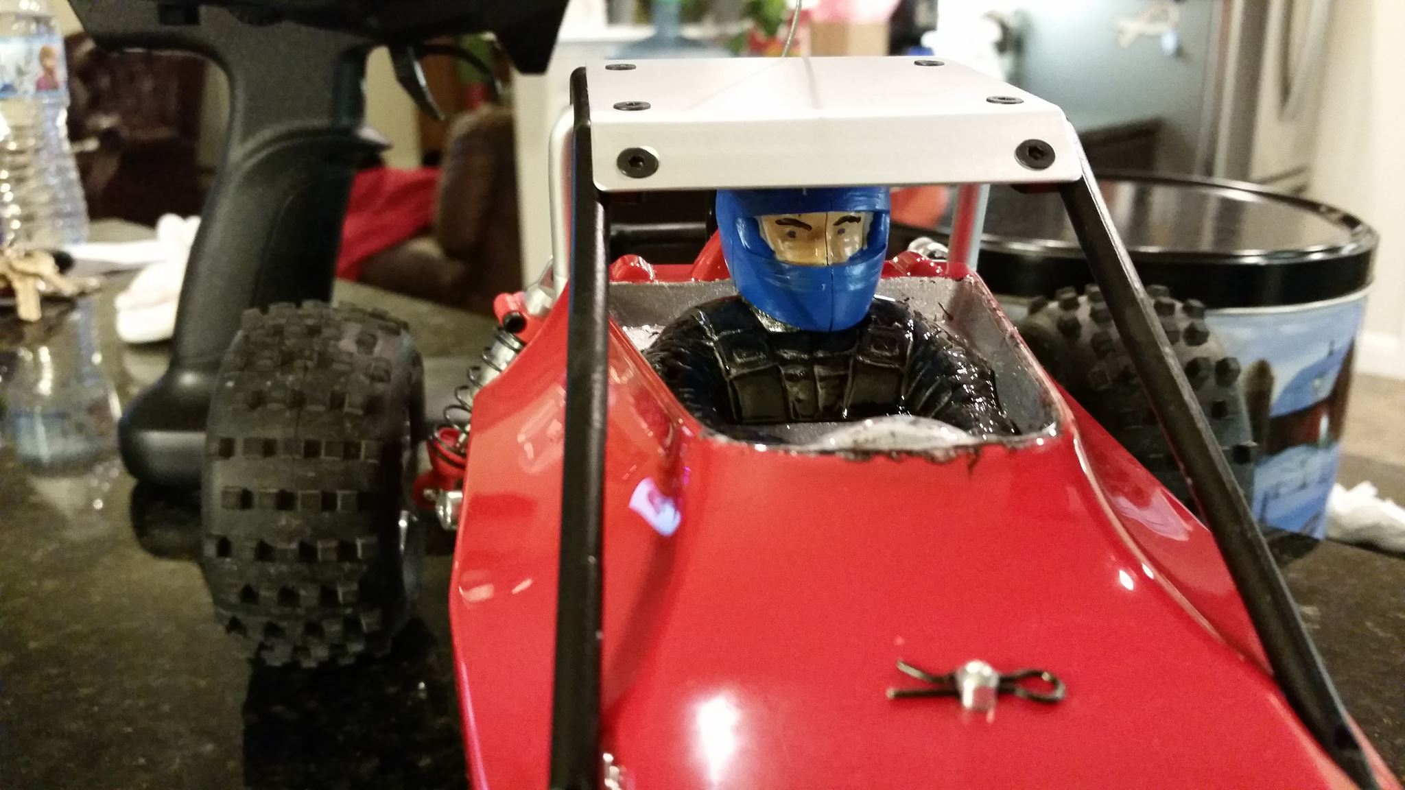

Did some work on the Kyosho Scorpion ,Changed the Main Tub Had a Red one come in the mail to day. finished the paint to just need to add some sponsors and logo's !!!!!
