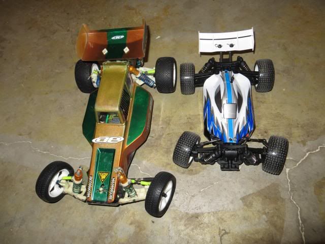

They are not really 1/16 scale; dimensionally, they are almost identical to the 1/14 mini-8ight.

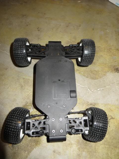

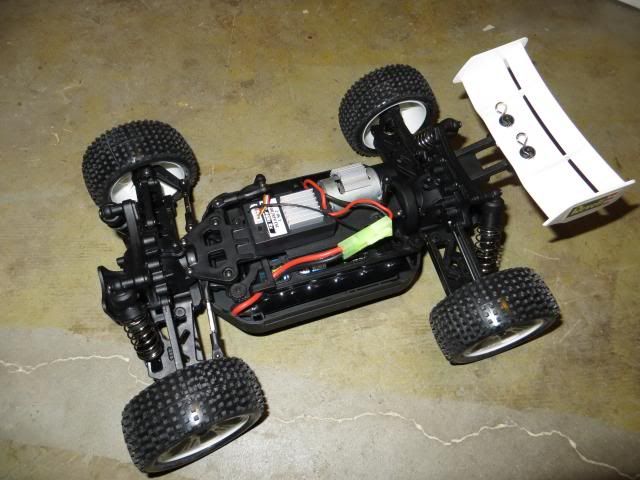

First pic is from Revell, the other 3 I just took:
First, we'll highlight the positives.
-Chassis layout. These things are like miniature 1/8 buggies, right down to the easily serviced differentials with sway bar mounting provisions. The chassis are plastic, but seem robust. All fasteners are button head or flat head socket screws, 1.5mm or 2mm drive, except for the Phillips heads that hold the ring gear to the diff case.
-Drive train. The biggest difference between these and their larger brethren is that they have a typical small scale primary drive train, meaning no center differential or slipper clutch. Just pinion mated to spur, which is rigidly attached to the center drive shaft. Plastic spur, steel dogbone type center drive shaft and steel dogbone axles. True gear differentials with 4+2 steel bevel gears, steel pinion gears, plastic ring gear. The diffs have gaskets and look like they could hold fluid, but I don't think there are O-rings to seal the outdrives. I did not tear it down far enough to investigate that, as the diffs felt pretty good with the heavy grease that was already in them. The Ring and pinion were dry as delivered; probably OK with steel on plastic, but I decided to apply ceramic grease anyway. Diff outdrives are steel, but the outdrive cups are polymer, affixed with pins. Axle stubs are steel with plastic hexes.
-Suspension. Seems to move well, compliant. The arms look sturdy. Camber links are non-adjustable, but that would be easily remedied with something like mini-8eight turnbuckles and Associated 4-40 rod ends and ball studs. The steering turnbuckles are adjustable, with conventional left-and-right hand threads on either end. Shocks are polymer, threaded coil-over oil filled design with captive balls on the bottom. Arms use captured steel hinge pins inboard and outboard.

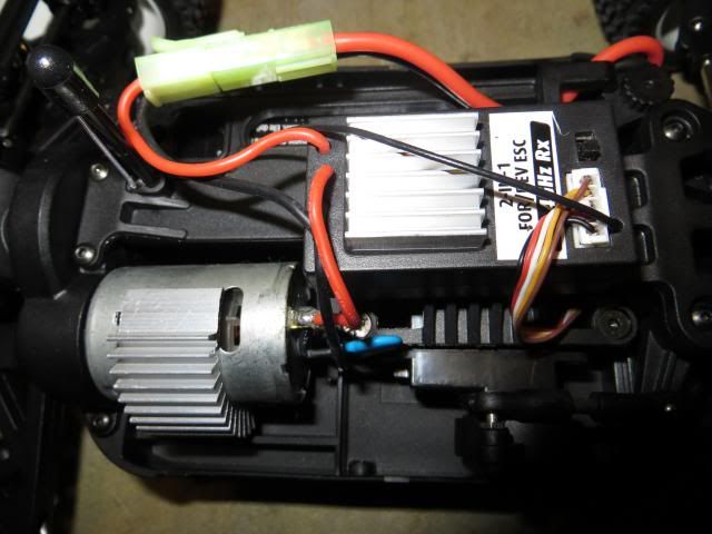

-Electronics. Simple, but functional. These use an integrated ESC/receiver like the Losi micro vehicles. They are brushed, using a 380 size motor (RS380SM). 2.4 GHz equipped, though the transmitter is very basic, with only steering trim adjustment. Both throttle and steering seem quite smooth for what I would imagine are pretty cheap components, uses conventional forward/brake with double-tap for reverse. Reverse power is about 25%, and is not adjustable that I've found. These come with an 1,100 mAh NiMH pack and wall charger, using miniature Tamiya-style connectors. Battery hold down is a pretty solid plastic strap that uses thumb screws on either end, and serves to route the wires.
Tires & wheels. Seem pretty decent for an inexpensive RTR. Tires are pin-block type, I'd say between a medium and soft compound. The 2.0", 12mm hex wheels seem fairly sturdy.

-Motor. It's a cheap brushed can, I think a Mabuchi unit. Moves them OK, but definitely something I will upgrade when either the kiddos are ready for more power, or when they burn up. I may go brushless, inexpensive as it is these days.
