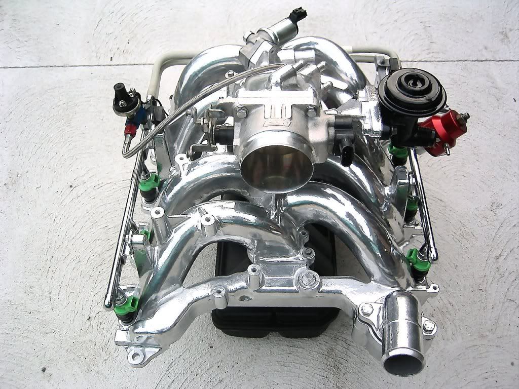

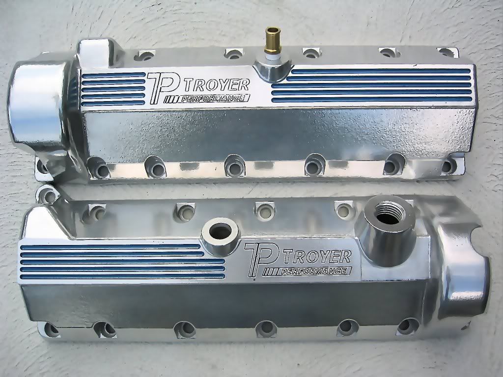

Re: Cerakoted chassis - anybody done this?
Sort of. Cerakote is a brand of coating that was originally developed for headers, but eventually wound up being most popular on firearms. Generally this stuff goes on thin enough not to mess up the action on firearms, and is strong enough to hold up on bolt carriers and other high wear components, plus it's self-lubricating. The major advantage from my perspective is that it cures at low temps (250 degrees) as opposed to most ceramic products that need 600-700 degrees, so I can do this right in my oven like I do with powder coating.
