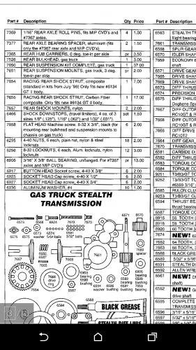

I'm looking for a 7200 front Suspension Kit and 7650 Rear Suspension Kit for an RC10GT. I'm also looking for a 6200 FRONT SUSPENSION KIT and a 6350 REAR SUSPENSION KIT for an RC10. what is INCLUDED, and a parts breakdown of the part numbers. Can Someone help?

I don't recall those kits coming with any paperwork which would rule out an easy way to show you the pieces included. I have seen plenty of the front and rear kits sold for the buggy but extremely few of the truck. It's going to be quite a challenge finding the bagged kits.
In short the front came complete minus front nose plate, shocks, steering and ball joints. The rear came with dog bones, axles, carriers and mounts, as well as hardware. Again no turnbuckles and ball joints, and no bulkhead or trans.

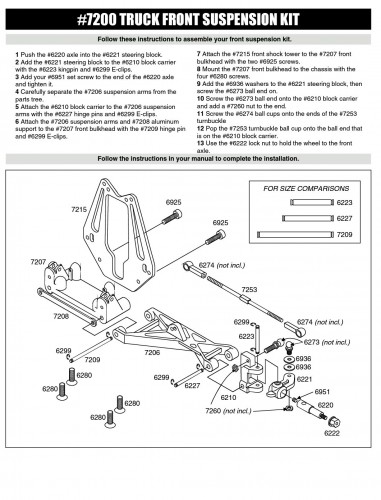

Hi Bearcat_2001,
All those parts are extremely rare, I have only seen one ASC7200 kit on eBay in years.
http://www.teamassociated.com/pdf/discontinued_items/7200.PDF
When you get B.S.T access, try the wanted section, again good luck

Dang, look at that, I lied to ya. I had the 7200 sheet all along on my website.
Edit... And Dave beat me to it! I'm losing my touch!

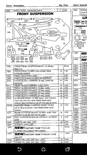

Hi Guys,
This parts break down for the GT shows
ASC 7200 and ASC 7650,
http://www.teamassociated.com/pdf/cars_and_trucks/RC10GT/Team/cat_tubgt.pdf
Cheers, DaveM.

On the same breakdown of shows the 7200 as "parts bag 7-1, so using the manual I would look at the rear suspension bag for a list of contents to the 7650 kit. The kits were always evolving so you could have early, mid or t2 style arms, black or white nylon, std or t2 front tower etc)
6200 (listed as "bag 6-1") and 6350 (listed as "bag 6-8") are much more common. 6202 was same bag with long front arms, inline axles, and updated CE style tower. Same deal as above, parts bags direct from kits so contents are same
