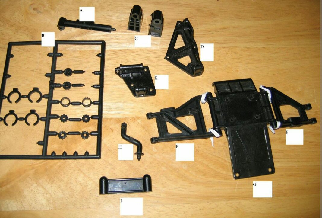

E: Tamiya Fox right front arm mount.

Thanks for moving and re-posting the pics. Tried to post directly but it was too big. King cab makes sense as I have never seen them before. I did get a Fox somewhere so maybe that is where E came from.
A. is a Blackfoot rear body mount..
D. * Kingcab D6 part left upper suspension mount/shock tower bracket..
E. Fox part..
F & G. * Kingcab lower front suspension mount and arms.
H. Kingcab front body mount.
(* Kingcab and 58086 Toyota Hilux..)

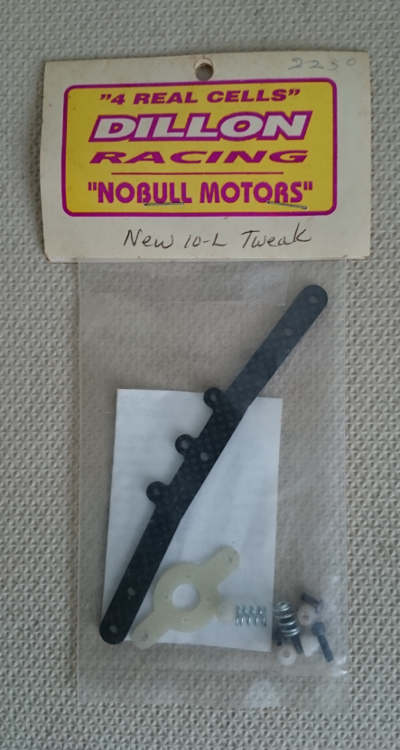

Okay I know what it is...it's a pan car cross brace that adds lateral springs to a t-bar car that uses damper discs. What I need help ID'ing is what car they actually go for because they're mislabeled and don't fit a 10L. Or a 12L/LW.
I'm thinking they may fit a 10L2 or 12L3 instead so I'm asking for help from somebody with either of those cars to check some measurements for me. I'm looking for the center to center distance of the two rear posts that mount the cross brace as well as the measurement for how far back those holes are from the center of the rear t-bar pivot screw hole.
The measurement for the Dillon cross brace holes are 127mm for the 2 holes furthest out and 100mm for the next two closer in towards center. These holes are 11mm and 10mm back from the center of the rear t-bar pivot.
Any help would be very much appreciated.

I don´t think it is for a 10L2. Have an original 10L2 brace here what looks same shape but measurements are different. The 2 holes furthest out are for body mounts and distance is about 152mm. Next two holes are for chassis standoffs, distance is about 127mm.

Thanks for taking the time to measure.V12 wrote:I don´t think it is for a 10L2. Have an original 10L2 brace here what looks same shape but measurements are different. The 2 holes furthest out are for body mounts and distance is about 152mm. Next two holes are for chassis standoffs, distance is about 127mm.
The 127mm sounds good...how far back are the standoff holes from the center of the rear t-bar pivot? Could be the Dillon brace is for a 10L2 Oval which has the body mount holes to the inside of the chassis standoffs.

Sounds about right. These probably fit the 10L2 oval and I suppose they'd also fit the 10L3 tourer and sport too. No reason to use them on the 10L3 oval though since that car has already got side shocks.

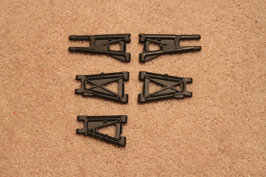

Trying to figure out what these arms go to. My best guess is that the long top set are Yokomo YZ-10 front arms and the others are Optima (not sure which Optima) or Ultima rear and front arms. Am I close?
