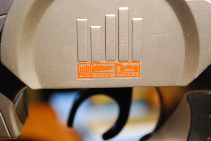

I have a DX3S - how can I find out if its DSM2 or not?

On the left side of the unit, there are some stickers placed there from the factory, just above the trigger area. they are orange and it shows what specs yours has.
When I got mine back from Horizon, new stickers showing what it will do. The old sticker just showed DSM and surface.

RC104ever wrote:I have a DX3S - how can I find out if its DSM2 or not?
The DX3S is DSM not DSM2 or DSMR.

The Gen 1 DX3S is DSM, the Gen 2 DX3S is DSM/DSM2. So you need to know what version you have, or send it to Horizon for a firmware upgrade to make a Gen 1 into a Gen 2 radio. I still need to send mine in, but not in a hurry right nowbiff85ta wrote:RC104ever wrote:I have a DX3S - how can I find out if its DSM2 or not?

You are correct on all that, send it in!!
Well worth it. Might be a few bucks, what look at what you get in the long run.
