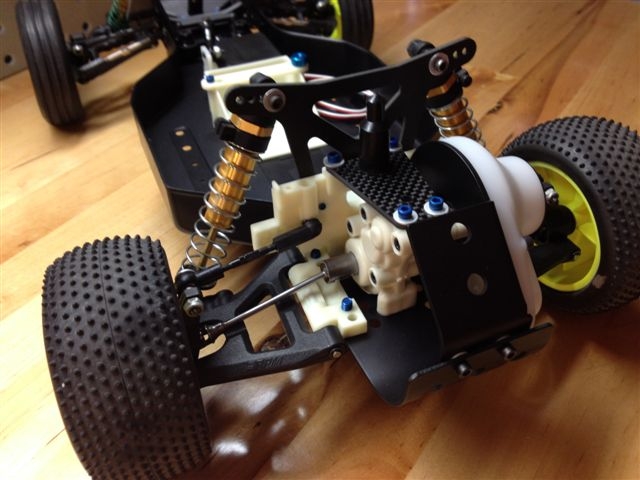

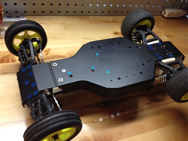

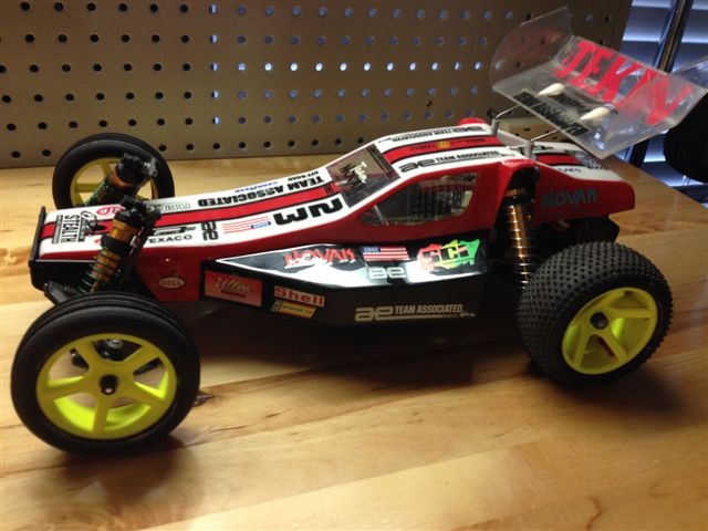

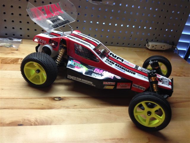

Rolling chassis is finally together:

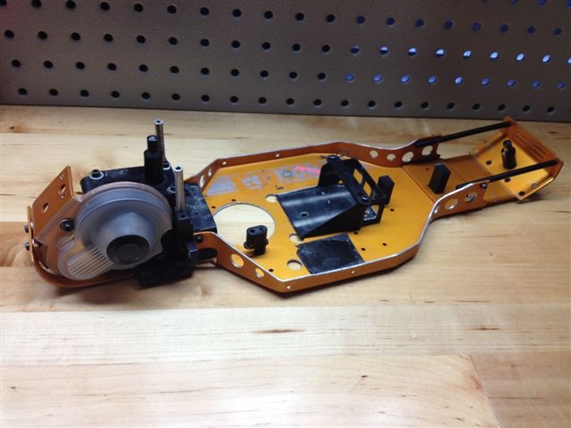

Here is the leftover gold pan carcass from this rebuild:

Nice! Serious weight savings on that old chassis lol.

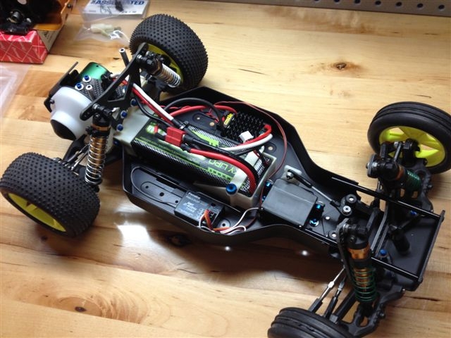

It is finally a runner! And it runs Great!
I am very happy with this rebuilt runner.
I installed a Castle Sidewinder ESC and 5700kV motor - I would've chosen a lower kV motor, but this is what I had...
I turned the punch and timing both to their lowest settings, but this thing will still wheelie when you punch it halfway down the straight!
Also:
Futaba s3004 servo (again, I had it in my tool box)
Futaba 2.4 GHz Tx/Rx
The handling is surprisingly forgiving, pretty stable with a bit of understeer.
I added an ounce of weight to the nose, but I haven't tested the new setup yet.
((I may also install shorter wing tubes :lol: ))
Check it out:

I have run this one with an ounce of weight at the nose,
and the front shocks moved to the innermost upper mounting point (more horizontal).
It really handles nicely!
I am pleasantly surprised, as are others who see me running it.
