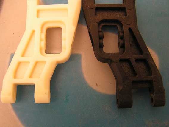

LONG FRONT ARMS...ACTUAL vs. BOX ART. The box art,black,long arms appear to have slot machined in them. I recently purchased a TCP that had what I believed to be short front arms that were dyed black. The car also came with a set of white,short arms that were new in package. I searched all over the web for pictures of TCP long front arms like the ones one the TCP box......never found any! So I decided to compare the black arms that are on my car with the new white arms......to my surprise the black ones are longer, and have more material out at the caster block opening
. So my question is do I have a car with the long front arms, and were the ones on the box prototypes that were changed to the ones included in the kit

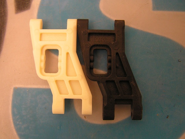

another pic

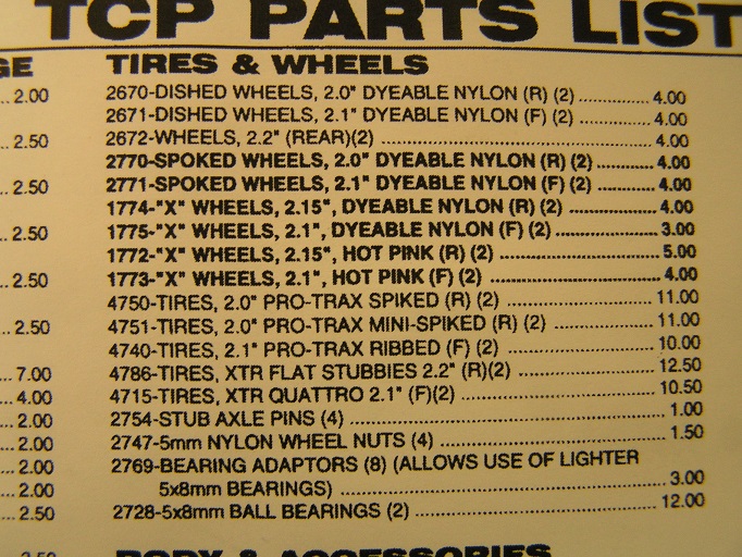

People also claim that there are 2.2 front wheels with a TCP kit. The parts list has several wheels listed .....none of which are 2.2 fronts!? My final question is which steering knuckles does a TCP manual tell you to use with the short arms , and which with the long. The TCP parts list has the original trx1 knuckles think 2737 white, and it also has the black ones listed that came with the SRT. Any help clearing these thing s up would be appreciated

Since I have the trx-3 arms a.k.a. "short", and also have a pair of black ones that are longer, I suspect that I have the long arms. They are definetly not SRT arms, already compared them to those. I think the ones on the box are prototypes.

Since this thread started I've gone thru some of my stuff I've accumulated over the years and have found one white arm that I would assume be the same as your white arms dyed black. Side by side comparison to the trx3 arms look to be approx. the same differences in length. Looks to have a few scratches on it but would almost guarantee that they were replaced with the stock trx3 arms when they broke one side since I don't have any others the same size sitting on the shelf.

I luckily can help you out. I own a running TCP and a NIB TCP. There was never a 2.2 front wheel option by traxxas. I believe the Bandit received the 2.2 later on(they do not share the same wheels as the TCP). The A-arms you have are legit. The white (also available in black) ones are the original shorter TRX3 arms and the black ones are the longer TCP arms and come in the kit as a solid design (I believe the box art designs were prototypes). The TCP came with 2 different size front shocks. The shorter shocks were for the shorter arms and the longer shocks were for the longer arms. You can use the long shocks with the shorter arms but in the manual it stated should be used by experienced racers only. Last but not least . The TRX3 and TCP came were different types of steering knuckles. The TRX3 version had a option to adjust the the axle height but were uses with the shorter arms. The TCP version are the same ones used on the SRT and did not have a option to adjust the axle height (same setting as the TRX3 middle option) and are used with the longer arms without using a longer length turnbuckle. Steering turn is about the same and you can use either setup on both arms as long as use have the right length turnbuckle. The nicest setup is the long arms with long shocks and trx3 steering knuckles. Hope this helps answer your questions!

Emaxx2.0 wrote:I luckily can help you out. I own a running TCP and a NIB TCP. There was never a 2.2 front wheel option by traxxas. I believe the Bandit received the 2.2 later on(they do not share the same wheels as the TCP). The A-arms you have are legit. The white (also available in black) ones are the original shorter TRX3 arms and the black ones are the longer TCP arms and come in the kit as a solid design (I believe the box art designs were prototypes). The TCP came with 2 different size front shocks. The shorter shocks were for the shorter arms and the longer shocks were for the longer arms. You can use the long shocks with the shorter arms but in the manual it stated should be used by experienced racers only. Last but not least . The TRX3 and TCP came were different types of steering knuckles. The TRX3 version had a option to adjust the the axle height but were uses with the shorter arms. The TCP version are the same ones used on the SRT and did not have a option to adjust the axle height (same setting as the TRX3 middle option) and are used with the longer arms without using a longer length turnbuckle. Steering turn is about the same and you can use either setup on both arms as long as use have the right length turnbuckle. The nicest setup is the long arms with long shocks and trx3 steering knuckles. Hope this helps answer your questions!
