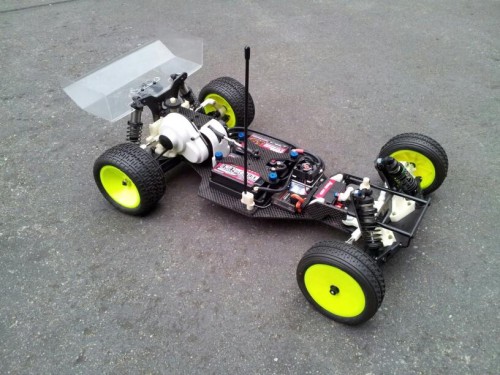

i am going out on a limb here and guessing this car needs more front end weight. how do you current owners have your chassis layouts?

Like this :D

RC10th wrote:Like this :D
yea thats pretty trick. is that the b5 battery cradle?

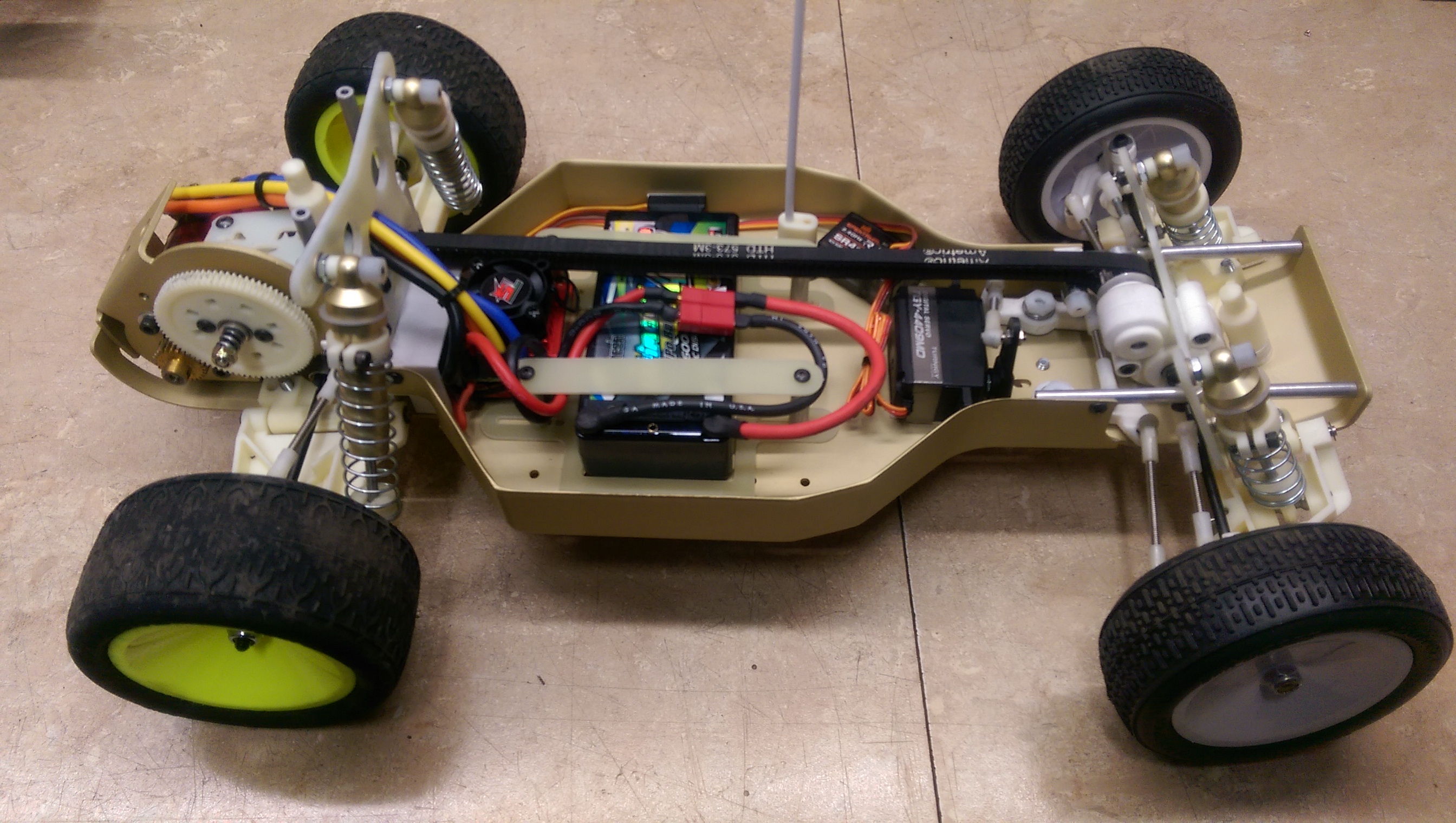

I like to put the esc on the right side of the car to help account for the motor hanging out on the left of the car. The wiring probably doesnt end up quite as tidy, but i believe in function over form.

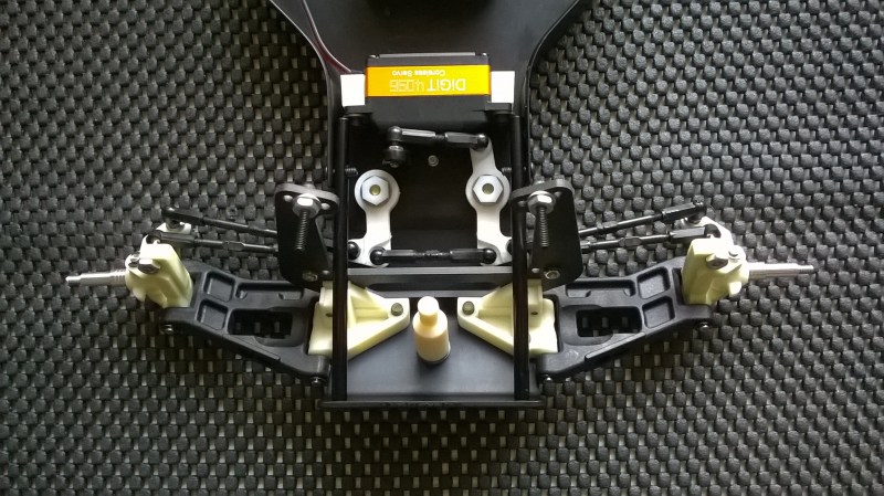

Same bellcranks as RC10th posted earlier... B44.2 battery craddle is perfect for various layouts.

i like the bellcranks. i was wondering how i was going to stuff a standard sized servo in there.

It's Savox SC-1251MG in picture. Standard size, only low profile.

My layout is the same as most of the chassis above, ESC on left hand side, RX on right. Shorty lipo pushed forwards. As we run on high grip astro I also have 120 grams of weight stuck in the front of the nose.
