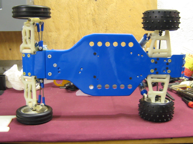

scr8p wrote: the rear rpm bulkheads pop up on ebay every now and then. but be prepaired to shell out some dough for one. :wink:
i live in the UK so ebay is pretty much my only avenue, i'm getting quickly used to paying high :( but when you want something, you have to have it :wink: .

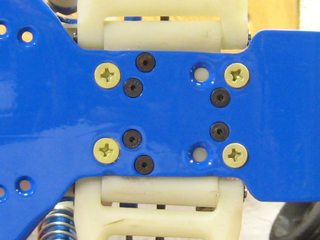

scr8p, how much modification to the pan did it take to get those wide rear RPM arms to fit. does the pan have to be cut (i can see yours looks like it has) and if so, which holes are you using to fix the suspension mounts in place?
a nice photo of the underside would be nice :wink:
"I want to die peacefully in my sleep like my grandfather, not screaming in terror like his passengers!" The late great Bob Monkhouse 1928 - 2003.
Posts: 16826
Been thanked: 1321 times
when you get the worlds rear suspension kit, it comes with a template to do the mods to the chassis. after the chassis is cut out, you'll only need to drill 2 holes for the front of the arm mounts. the back of them attach through the existing stock trans mounting holes.

scr8p wrote:well, the front bulkhead on this car is a standard rc10t. the narrow rpm bulkhead will not let you attach the nose brace tubes to it. rpm front bulkheads are almost non existant, from what i've seen. the rear rpm bulkheads pop up on ebay every now and then. but be prepaired to shell out some dough for one. :wink:
I am working on getting some, will start a new thread if/when it comes through. Some meaning more than I need.....
