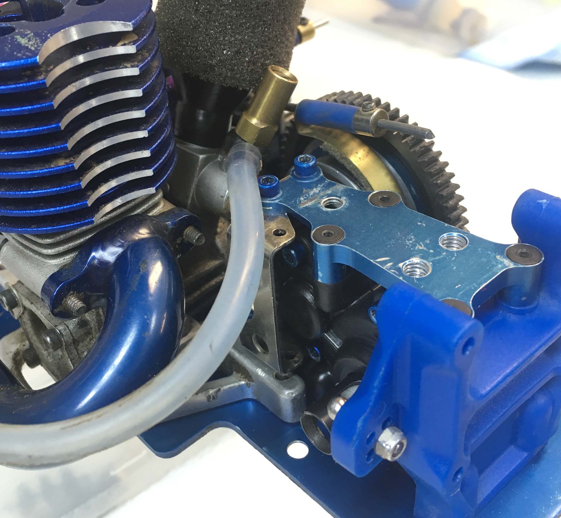

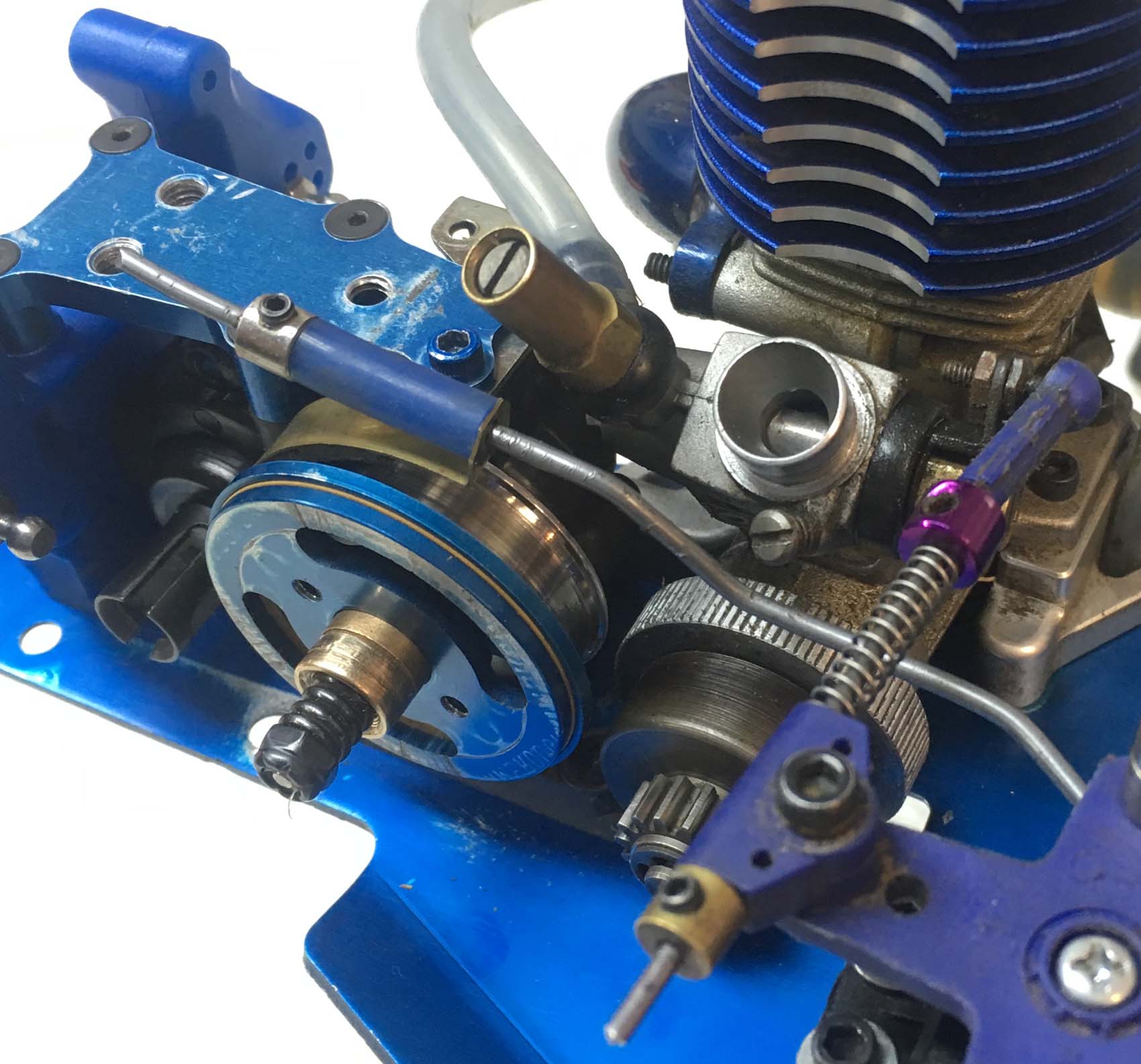

I finally got around to installing the brake. Had to do some searching with the wayback machine to find some pictures and info on the setup.
The brake mount bracket gets flipped around to the wrong side of the trans case as it is easier to do this than to try to get washers lined up between the trans case and chassis mount points to take up the space.
I Haven't gotten it back together completely yet to test out how it works compared to the stock caliper and disc setup.
Need to get a proper thrust bushing. I was running a dirt oval slipper eliminator prior to adding this brake setup.

One of the best mods ever for the gt. I still use one on my main runner. The only thing you need to look out for is the leather pad coming unglued from the brass strap, but a little ca will take care of it. I put so many miles on the first one I had I wore clean through the aluminum drum.

Close, but it's the other way around, you have to use the factory team trans mount/chassis brace. The strap mounts to the "brace" side.klavy69 wrote:Yes. justinspeed79 was a mod over at Dave's board so he'll pry be back to chime in but they were AWESOME! vs. the original set ups. I wanna say you had to use the RTR tranny mount with the brake though but if yours was a rtr you should be set. I wanna say that I might've seen that lot but passed on it...picture looks very familiar. Might not have been the one but wished I would've seen the CR brake setup. You'll be very happy with it.
