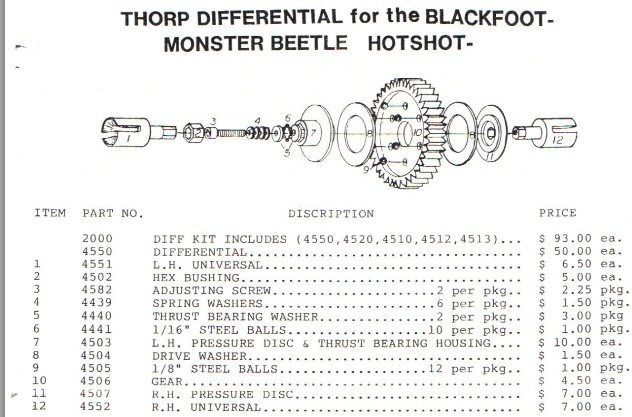

What are the parts I should be looking for from a Supershot to put onto a Hotshot? Also, are the Thorp ball diffs the same as any other models? Found a Thorp ball diff for a blackfoot / frog / monster beetle on ebay.

My thorp book shows the complete diff for the hotshot is the same as frog/blackfoot. The difference would be the dogbone vs sliders that some for the frog series came with

So then would this work? http://www.ebay.ca/itm/Vintage-THORP-4500-Tamiya-Blackfoot-Frog-Monster-Beetle-Ball-Diff-Differential-/191256668812?pt=Radio_Control_Parts_Accessories&hash=item2c87c92a8c

I think you want the one with traditional dogbone cups, not the hex style dogbone or sliders
#4550
Completed auction: http://www.ebay.com/itm/191188396305
