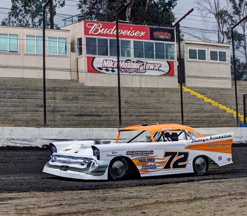

A slight mix up on the front bumper so I told Fred not to worry. Least I could do was fab up a simple bumper and let him get back to his work. Plus I knew one of our tracks is like Bristol. So I fabricated a lexan bumper that I can easily recreate if it breaks. I was almost scared to put this car on the track because I know it's a special car. But mounted the Viper body up. Looks slick and not boxy like the modern stuff.
And I was out of paint. Nearest open hobby shop was 70 miles away. Luckily my cousin owns a vinyl shop so I stole some scraps!

Bad ass ride John, love the '57 paint theme. Someone should pop the Dragonslayer body :-) it's my new favorite late model
