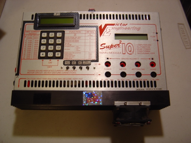

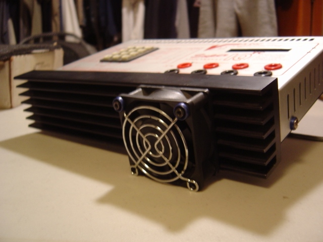

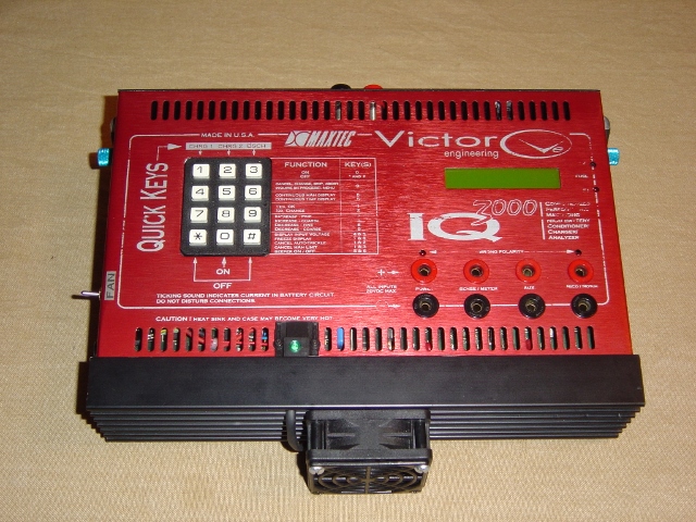

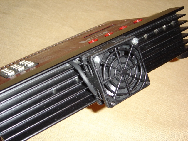

This is my IQ3000 with a fan added to the heatsink. This was done by drilling and tapping 2 holes in the heatsink, and then using long screws to attach the fan. There is another hole drilled to run the power wires thru.

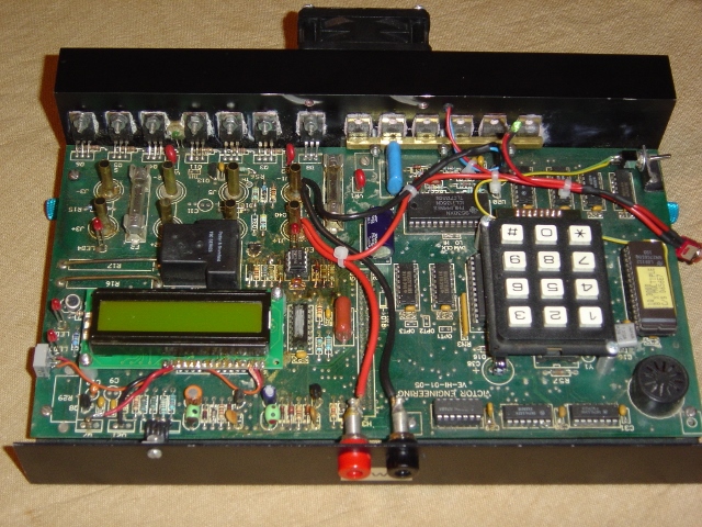

The fan was mounted in the center on this one because its been modified with additional FETs on the left side of the heatsink (to handle heavy-duty discharging).
thepistol
Posts: 10
Joined: Tue May 10, 2011 12:57 am
Re: Victor Engineering Charger Setup Question
Post by thepistol »

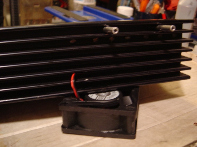

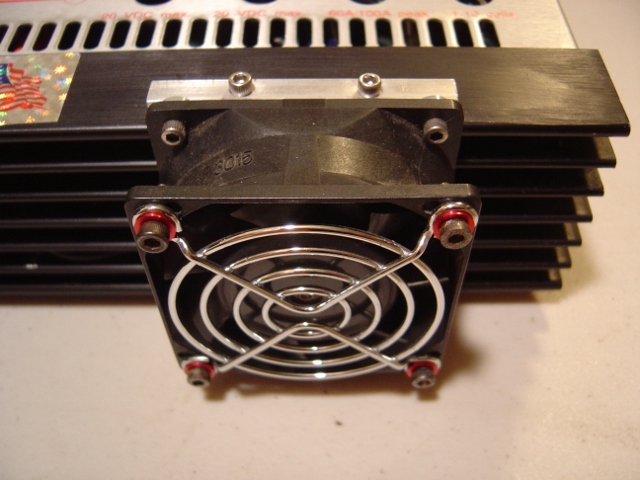

The fan was added to this one by using aluminum tubing which I tap threaded on each end. A small piece of 4-40 rod is threaded into one side, with maybe 1/4" sticking out. That end is threaded into the drilled & tapped heatsink side, then the fan is slid on the tubing to attach it.

And yet another way to attach a fan.....

Very nice! I like the re-location of a second set of power input jacks as well. Of course now that you mentioned the extra fets on the discharge side.......you need to elaborate :) I picked up a pair of 50mm muffins and will add them, but those extra fets are looking darn tempting........

Sorry, I can't take credit for those extra FETs. Those were added by a guy named Sam Capri in Canada many years ago, and they are beyond my expertise or knowledge. They are soldered to a custom pc board strip he made. That IQ3000 also has a custom 2-in-1 eprom with the IQ3000 and Pro-Matcher Cell Grading software by him. They are accessed by flipping the toggle switch (with the power off of course) to the left of the main pc board. The switch is just barely reachable thru one of the side vents of the faceplate cover, so its not easily flipped by accident. I've also got another IQ3000 with a 3-in-1 eprom from Sam (IQ3000/Super-IQ/Promatch softwares). Sam was the master. Sadly, I do not believe he is dealing with them anymore, as his website has been gone for probably 6-7 years.
