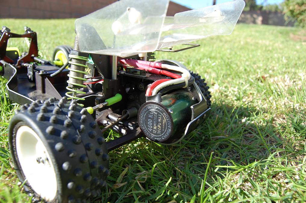

It may not be much help but there is no magic number, mainly trial and error. Do to the variables you can get it roughly in the ballpark and go from there.
For what it's worth I ran a 20t pinion and 84t spur gear giving a final drive ratio of 9.45 with a 6.5t motor (5340kv, 390w) Runs were limited to 5 minutes.

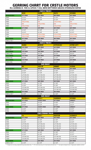

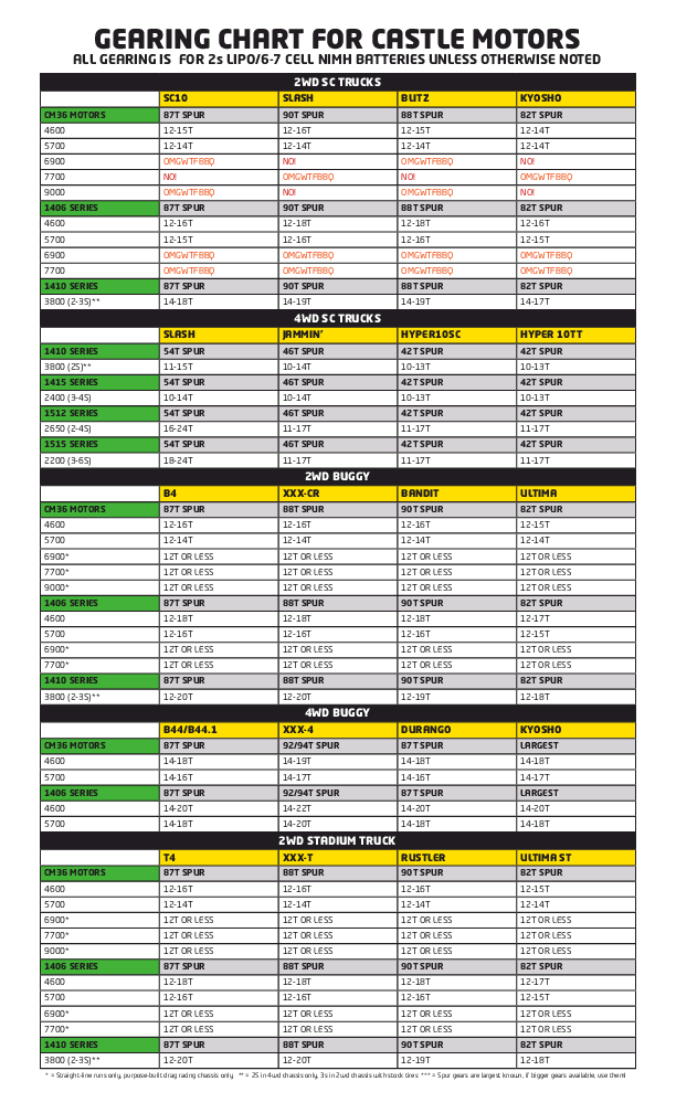

Wow, the castle CM36 4600 motors recommend a low gear ratio according to their gearing chart, 14.137 to 18.85 FDR.
Taking the B4 gearing as a baseline;
87 ÷ 12 × 2.6 = 18.85
87 ÷ 16 × 2.6 = 14.137
