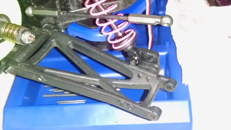

Took delivery of another lot of parts. Most of the stuff appears to be for a XXX, but there was some XX/XX-T stuff in there. I have a few questions...

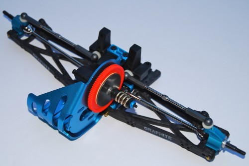

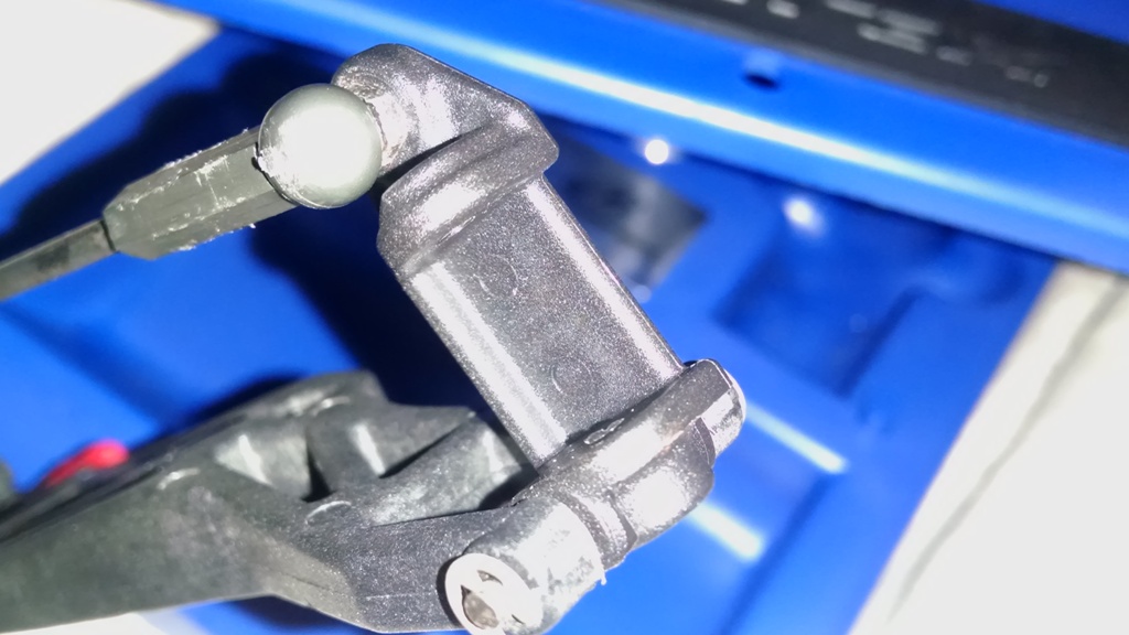

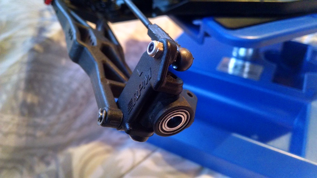

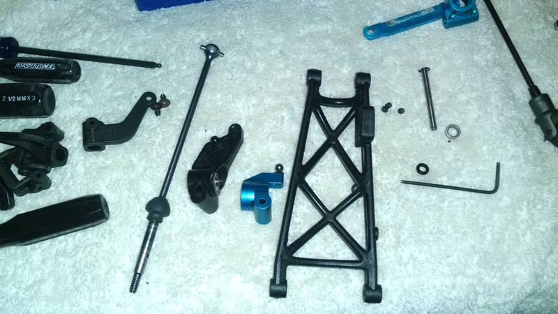

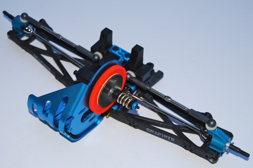

1) This is in reference to @Jamin with regard to one of his XX-T G+ pictures (see below). I tried to mock up the XXX aluminum rear bearing carrier and it put the bearings too far out, so the axle would barely touch the out-drive cup. Is there a solution to this? Jamin's pic shows a different a-arm, is that one narrower? Or is the axle shaft longer in his photo? I tried both the standard and CR style rear a-arm, both appear to be the same length.

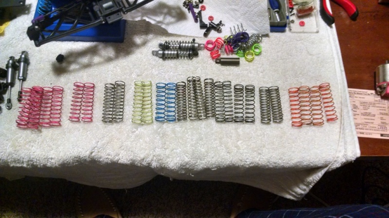

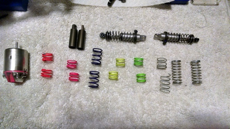

2) In the parts lot, I got a ton of springs, can someone help me "decode" the rates? I posted a pic before (on page 2 of this thread), but was told that rate chartwas inaccurate. The following colors are there: pink, silver, yellow, blue, grey, black, orange.
3) The parts lot also had a bunch of small (short springs). What are these for?

Hey Alex,sunshineFC3s wrote:Took delivery of another lot of parts. Most of the stuff appears to be for a XXX, but there was some XX/XX-T stuff in there. I have a few questions...
As always, much appreciate the help!
-Alex
I feel like I am obliged to reply since its my build that is causing the confusion, sorry!
Check out the parts below I used for that rear end - if you look closely I used XXX parts - VLA rear arms (longer than the XX), XXX inner pivot block (narrower than the XX) and XXX rear hubs. Using all three means you can still run the same length drive shafts (axle). You are using a XX pivot block and wishbones, which is fine, but as those hubs are XXX you will have the problem you describe. In fact from the picture you have posted below you can see that the pivot hole on the hub is wildly different between the trinity (near the inner bearing) and plastic (almost centre of bearings) versions. The best thing you can do is get a set of Trinity XX hubs - I think there are some on ebay currently and ditch those hubs you have. Hope that helps.
I ended up using a full XX rear end after a few months after these picture anyway!
