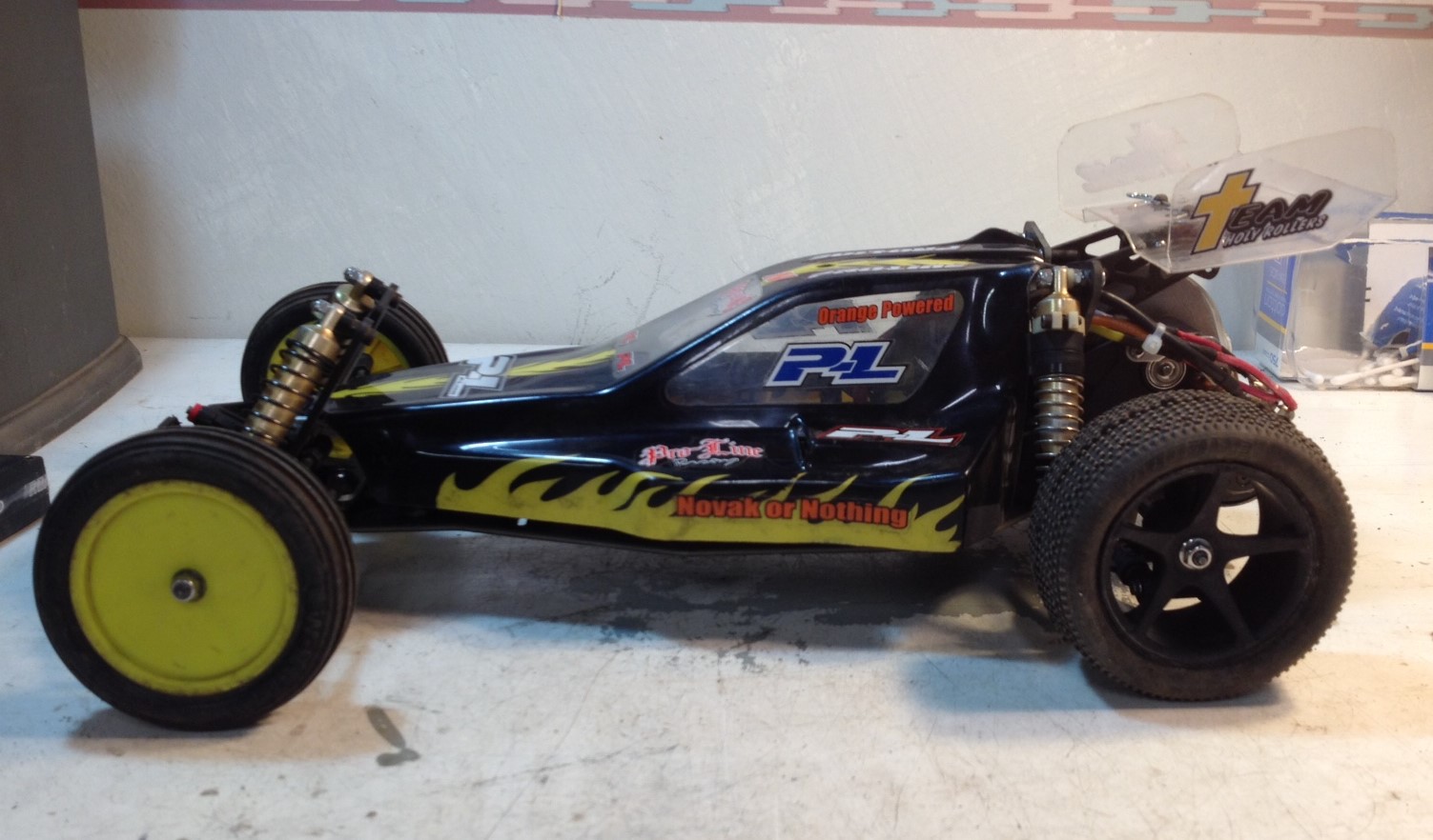

Here are some pics as it currently exists. My brother (and nephew???) painted the body. I don't know what body it is, but it's not the original Triumph body. I still have that, but like this one better. At least for now......

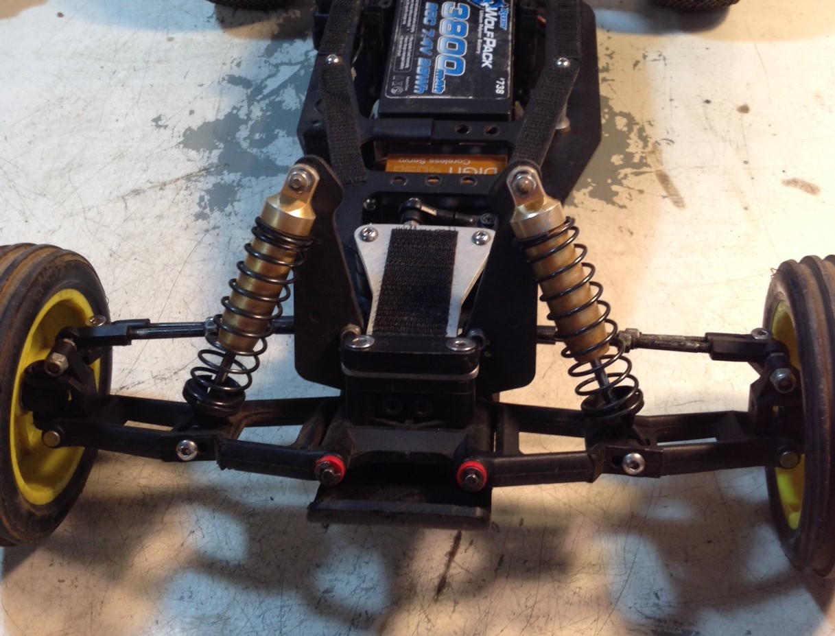

Stock 24 year old ribs on the front. I've tried saucing them back to life, but they are still part of the understeer issue. AKA Impacts on the back with some 5 spoke HPI rims that came with an Optima I bought on E-Bay several years ago. Stock shocks with "modern" small bore Kyosho pistons. Ho me made skid plate covering the tranny hole in the chassis made out of some thin copper plate that my supportive wife had in her crafting supplies. I'm limited on screw variety, and installing a thicker aluminum skid plate would have limited the amount of screw depth into the tranny, etc. Maybe it would matter, maybe not. Copper held up OK, considering it is copper, although will likely need replacement on regular intervals. I think it's a B2 or B3 wing. I just bought that a week or two ago, and forgot what it was already. Its a wing....

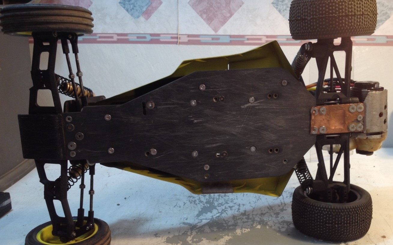

During it's time with my nephew, he broke the front chassis brace. My brother made the aluminum one in the pictures. Heavier than the original by a fair stretch, but the car is still right on the lower weight limit, and could use more weight up front, anyway.

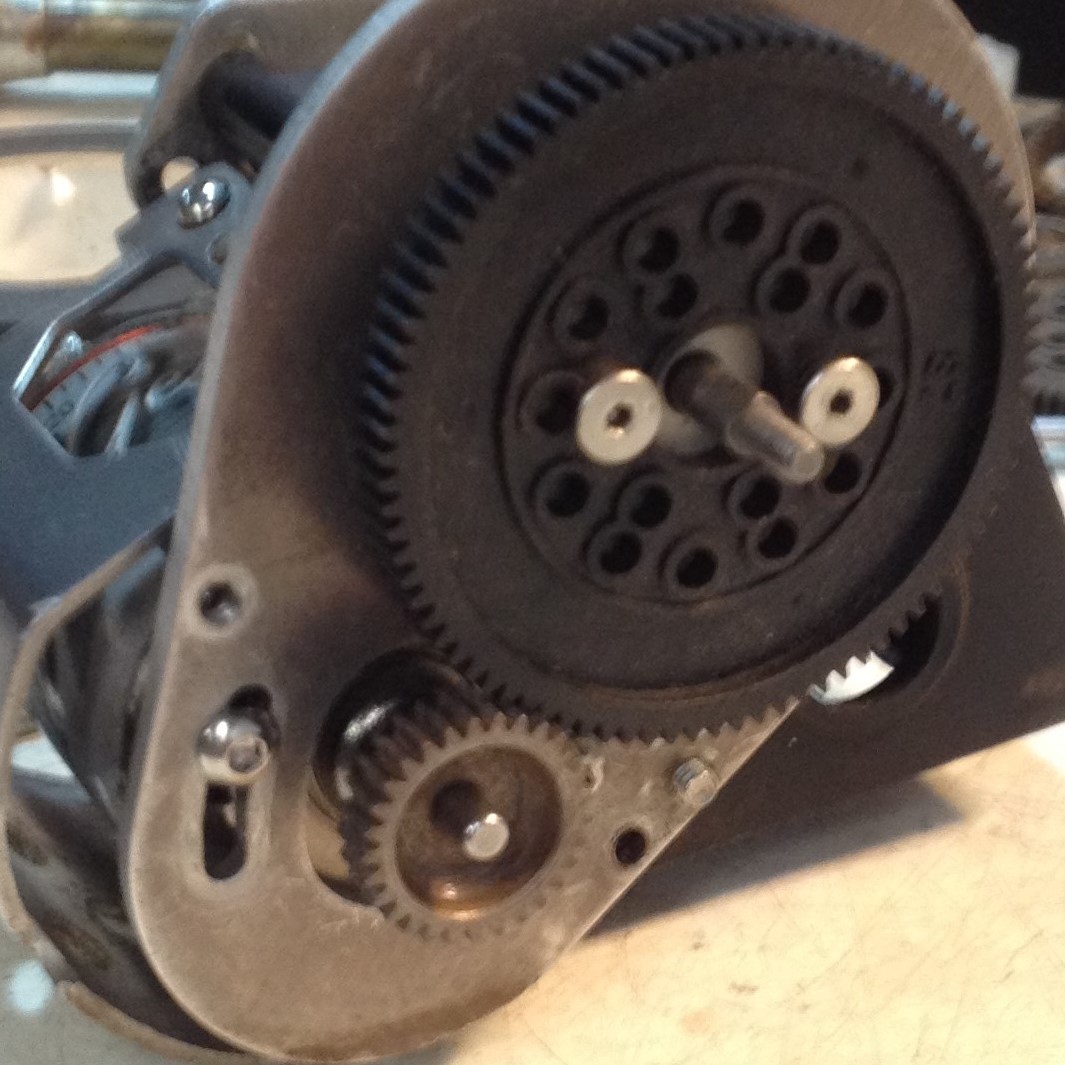

The Triumph came originally with a slipper and a BIG spur gear. The internal tranny (hard not to call it a gearbox) ratio is something around 2.215:1 IIRC, but that's not enough to make the thing fast with a 17.5 motor. There simply isn't enough motor positioning adjustment to get a big enough pinion installed to run a "stock" motor. Maybe Kyosho learned a lesson with the original rear drive Optima, which ran out of gearing the other way. I remember running a 9 tooth 32 pitch pinion in that with whatever monster brushed modified motor I ran with it in the 80s and it came off HOT and ran for about 4 minutes plus the remainder of the lap.

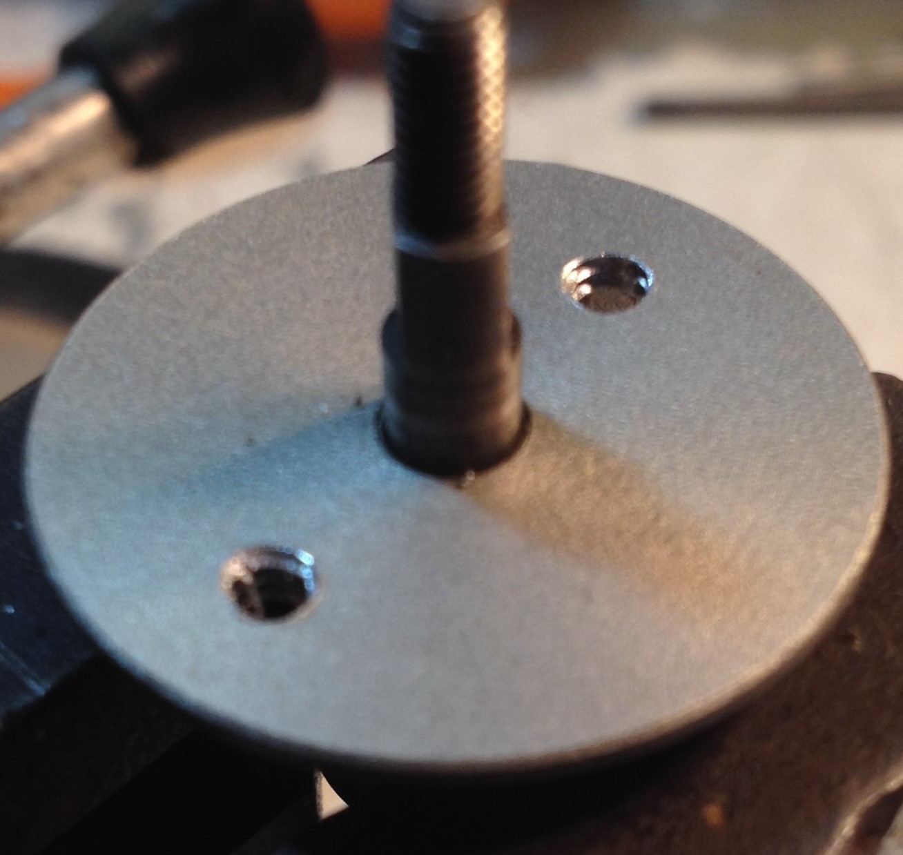

Back to the Triumph. I ended up drilling and tapping holes in the drive plate and screwing a 87t Kimbrough gear right to it. Sort of a slipper eliminator. There isn't much thickness for cutting threads in the drive plate, but it seems to be working so far. Threadlock is my friend with this one. Sort of like on an SC10 tranny. That being said, my machining skills aren't exemplary, and I have a slight amount of runout in the spur gear now, so I need to run the gear mesh a little tighter than I would like. I found that out the hard way after stripping two spurs; one during a bench test of the ball diff and one in practice before the first qualifier trying to get out from under an e-buggy who was stuck on top of me. Should've waited for help. Whatever the case, the thing made it through two 6 minute quals and an 8 minute main. The motor never came off at more than 115-120 deg F, so I think I can go up more on the pinion, but the 29t is the biggest I have for now. So, it's 29/87 on the pinion/spur at this point. It had decent speed. Like I said, the biggest issue is the push. Maybe once I get that improved, we can work on more gearing, but for now I'm happy with the speed.
