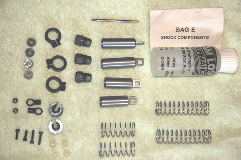

This Losi shock kit came with an RC10 parts lot i got off the bay.
Unfortunately, the bag was torn open, and clearly some parts are missing.
No, the missing parts aren't in the bottom of the box. :(
Can anyone tell me what Losi Kit these are for?
Thanks in advance!

They look a lot like the JRX2 shocks in shodog's post, but i want to be sure.

If I had to guess, I would say junior 2 or junior T. Looks like a .6" body, and a .9" body shock. Original cartridges, so they are from an older car.

bngiles wrote:If I had to guess, I would say junior 2 or junior T. Looks like a .6" body, and a .9" body shock. Original cartridges, so they are from an older car.
Most likely correct. the junior had the darker grey shock bodies. I will check with my nip junior-T kit to check the shock bag letter. I don't have any other NIP kits, but IIRC, the tags on the x-2 were pink with a jrx-2 logo.
The shock collars are the older skinny ones which are harder to find, good bonus score there.

My guess is that those are from a jrx2 kit. You'll need the following:
1 shock cartridge: A-5006
1 spring collars (old style thin...not thick): A-5010
2 lower shock mounts for 5 link suspension: A-5010 (included with the item above)
1 long shock shaft: A-5005
2 short shock shafts: A-5004
8 e-clips (standard size)
2 4-40 x 3/8 socket head screws (for the shock collars)
hope this helps,
regards,
highwayracer

Thanks to all for the help!
Especially for the part numbers. 8)
Wish me luck finding the parts.

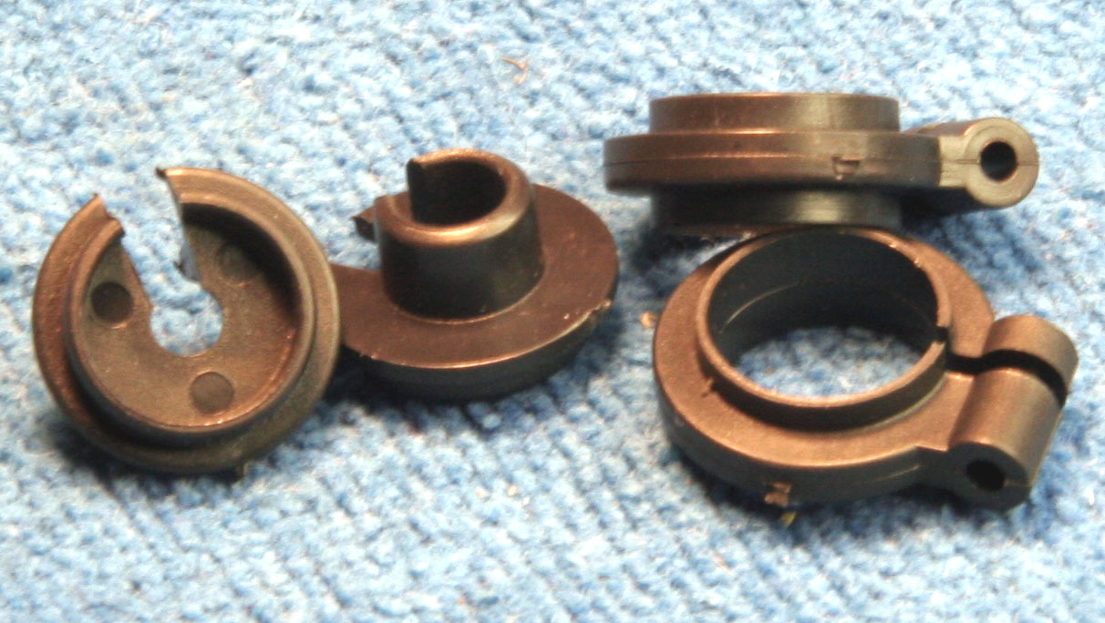

Looks like the lower spring retainers might be early ones as well. I have noticed that the later ones have three tooling marks in the bottom surface that are 120 degrees from one another (form a triangle). The older ones are smooth and have a glossier finidh to them. If you would like to trade those earlier lower and upper spring retainers and for a set of wide later ones, just let me know. I could also throw in all the parts you need to make a complete set.

Looks like these have the marks. :|
losi cups and clamps.jpg (196.89 KiB) Viewed 1283 times

MikeyD wrote:Looks like these have the marks. :|
the newer ones have the 3 marks on the outside flat surface, the older ones have the marks on the inside of the cup.

What Anthony said. Interested in the trade?
