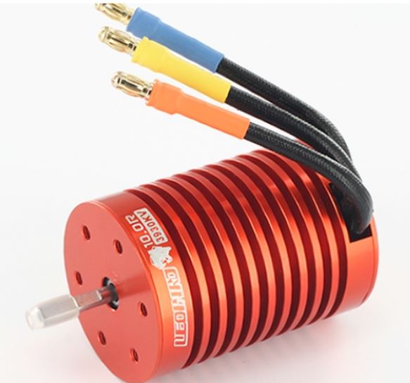

I spied a 380 sized brushless motor rated at 4400kV and it got me to thinking that the beginner Tamiya cars came with 380s... Then I stopped and realized that 4400kV is a fair amount of power and if the rest of the car was made as light as possible... Might be an interesting experiment. Any other ideas of how to "add lightness" to add to the list below?

Many of the 540-sized brushless motors are actually 380-sized motors in oversized cans...for example, this Leopard Toro 12T motor I'm using in one of my cars. The ribbed can actually houses a 380 inside.
That motor has more power than I'll ever need for a 1/10-scale car with my driving abilities, and I already had to dial down the punch a lot.

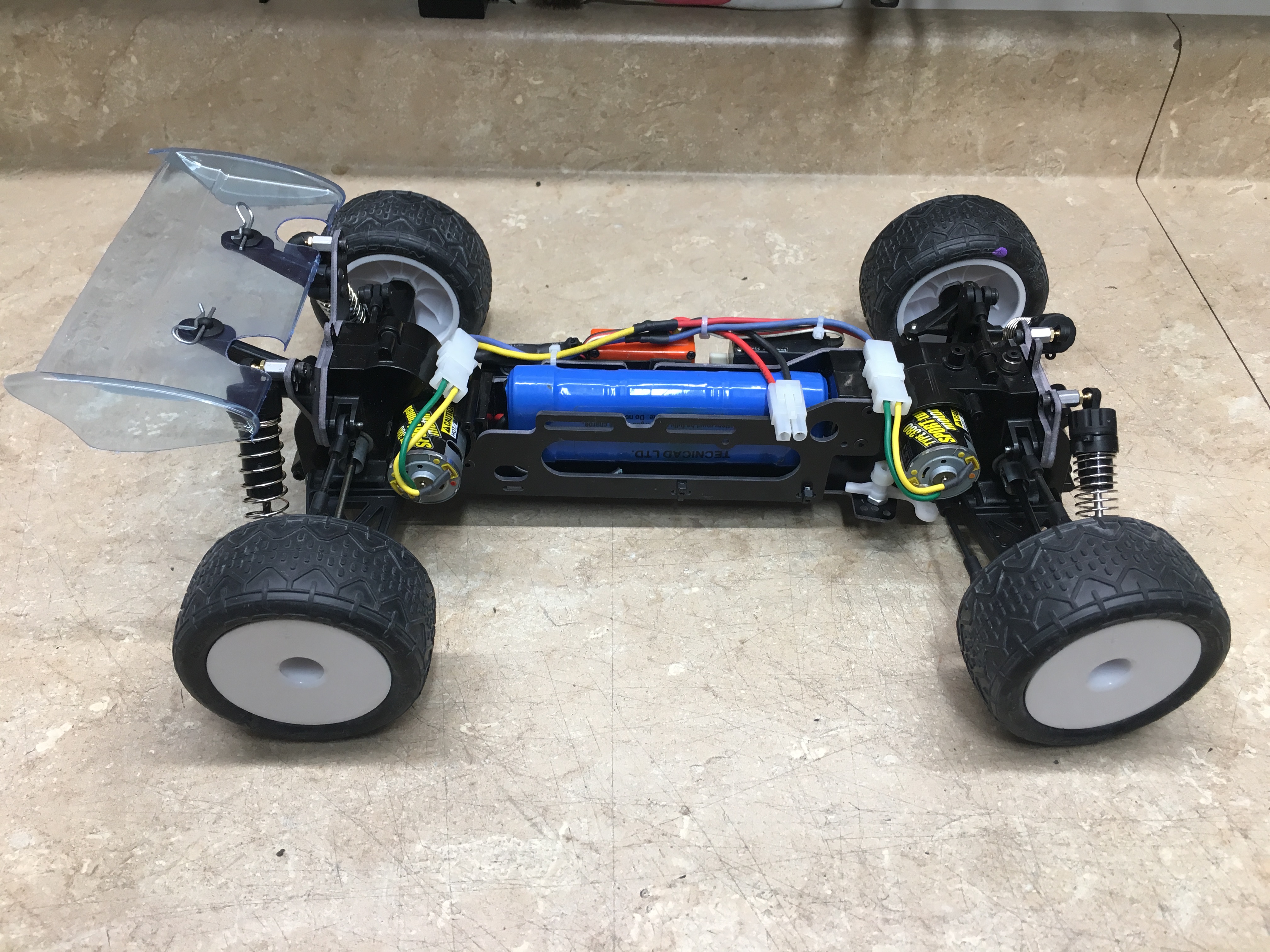

Now someone needs to take an actual 380 and mount it into their car.
- Posts: 12255
- Has thanked: 1105 times
- Been thanked: 3809 times
Re: How light could you get an RC10?
The thought of dual brushless 380's in my Dictator has crossed my mind!

I have been checking out that motor on eBay. I have seen a few bad reviews. How has it worked for you? I am building a mid motor rc10 with a stealth GT trans and have considered that motor/esc combo.Coelacanth wrote:Many of the 540-sized brushless motors are actually 380-sized motors in oversized cans...for example, this Leopard Toro 12T motor I'm using in one of my cars. The ribbed can actually houses a 380 inside.
That said, there's such a thing as too light, as well. As you decrease weight and increase power, your traction and driveability will suffer, unless you also implement some way to add a lot more downforce.
