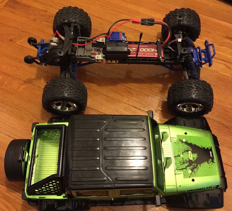

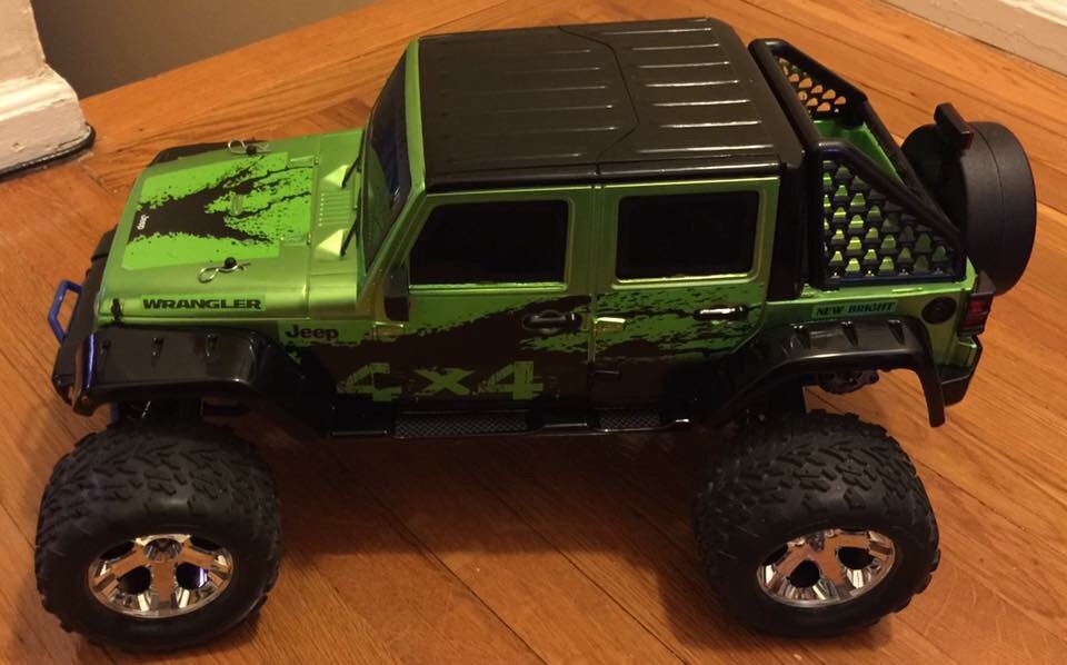

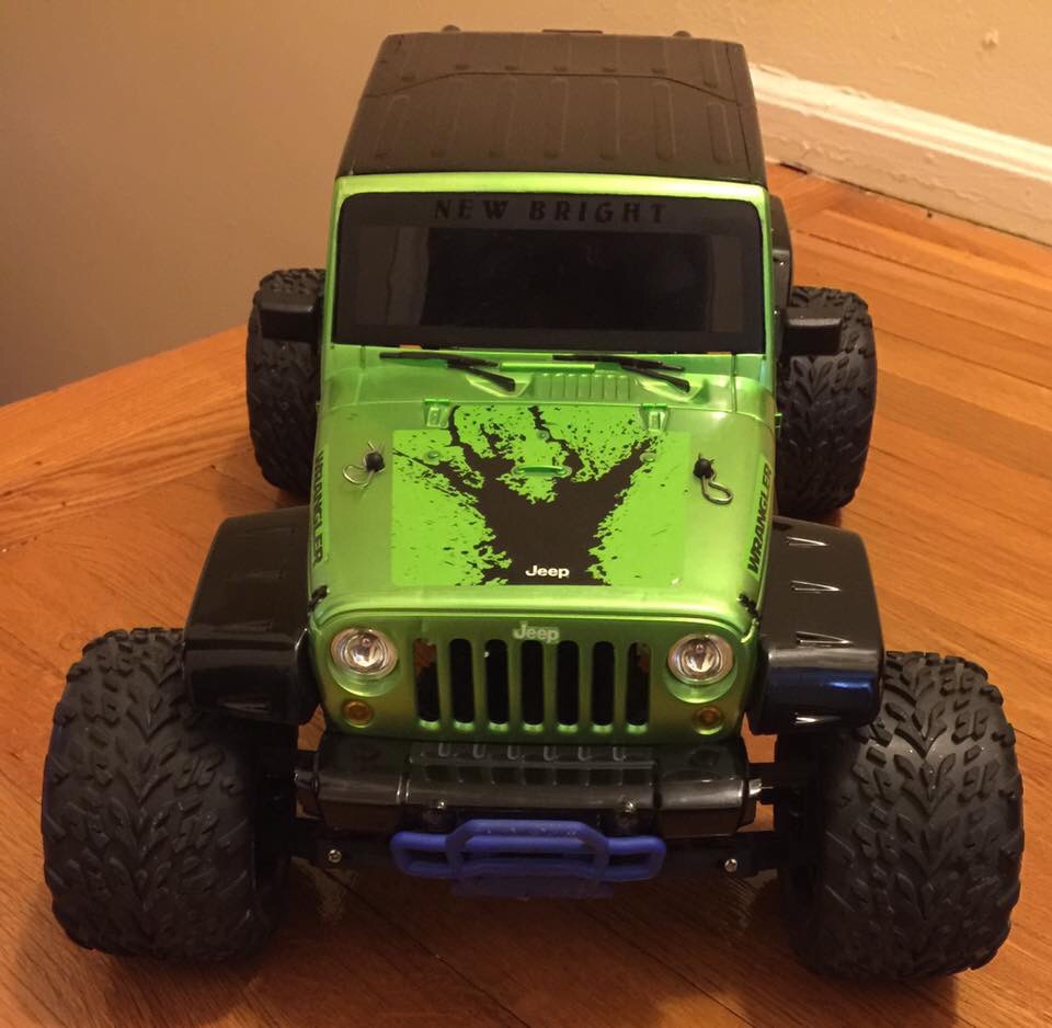

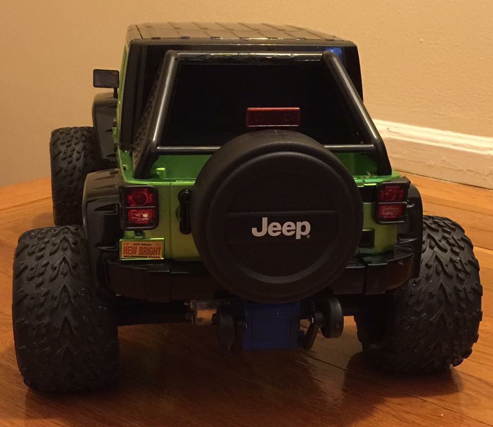

I've had this Stampede for over a year, and though I've had many rc cars, from the low budget, to the high end racing stuff, I gotta say, this thing is super fun.....but I was never happy with the way the body looked on it, and the other options don't sit quite right on the chassis, so I bought this newbright body for it.

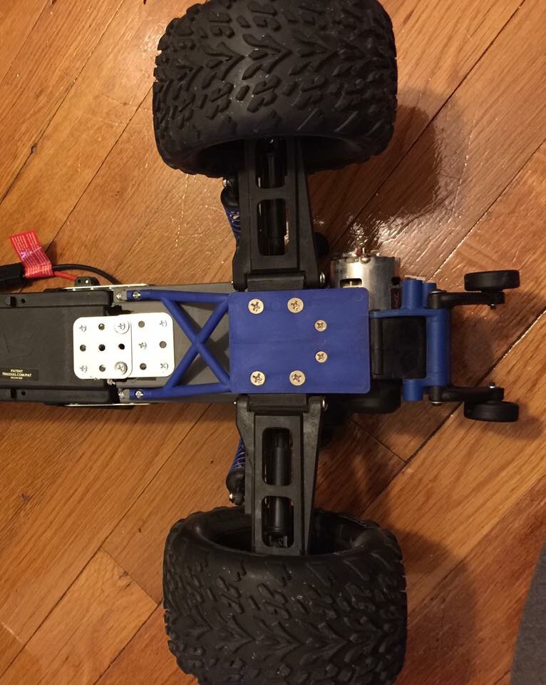

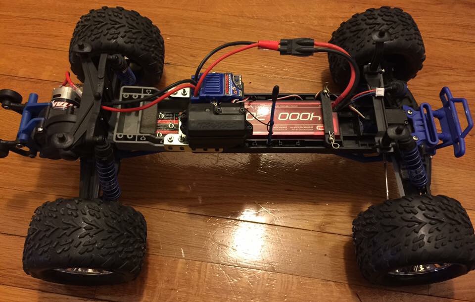

I had to extend the wheelbase quite a bit on it by using a spare chassis that I had laying around, basically bolted the rear end to the spare chassis, cut it down and joined it to the other chassis, using some specialty hardware from Lowe's....
Stampede -- Newbright Jeep Jk On Extended chassis...
