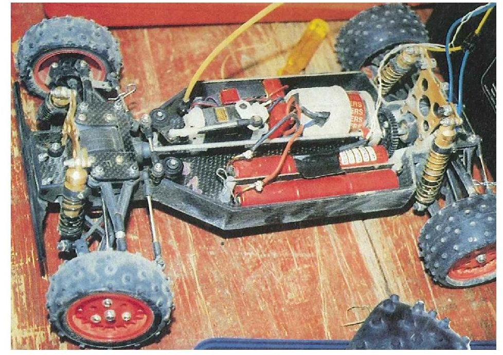

Also found this review (in French) which included a shot and description of a Works Coyote driven by M. Pernice, which includes a carbon fibre chassis fabricated by Ferrari(!) Also has the motor canted over to one side to lower the centre of gravity, as well as carbon fibre additions atop the gearboxes/suspension mounts. Pretty cool.
And another shot of the same car taken from a different thread on this forum:-

Both pics from '87.
