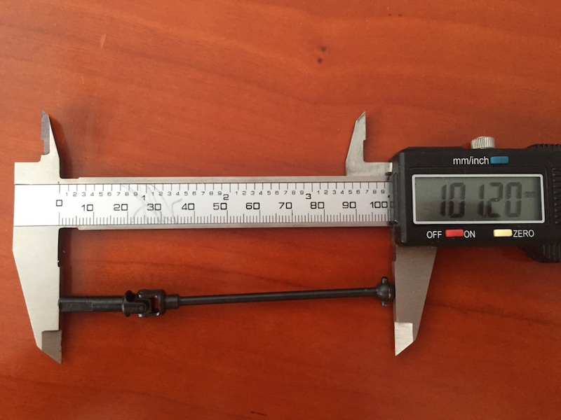

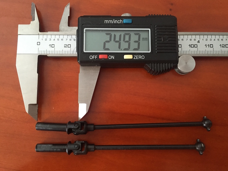

the universal drive is 101mm long. and it's 25mm from the the end to the joint center on the axle
