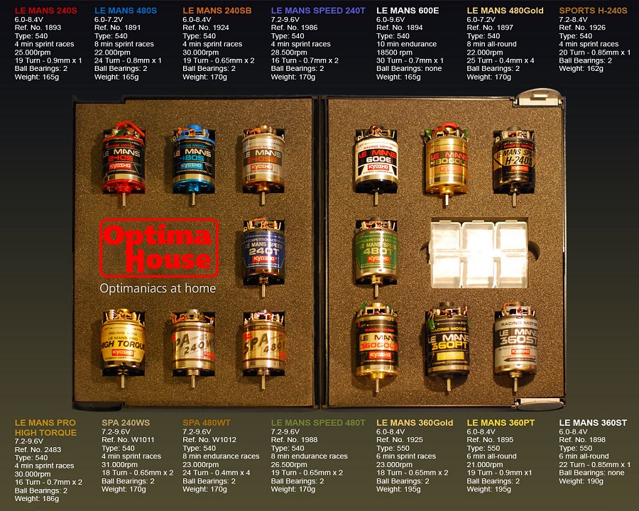

I think the only way you can compare brushless vs. brushed motors is to go by RPM. Number of turns doesn't directly correlate with how fast a motor spins, but kV ratings do. A 3000 kV motor will spin at around 22,200 RPM at 7.4V. You'd need a motor dyno to test actual RPM of a brushed motor, but you can find charts with pretty accurate estimates for vintage brushed motors...like the Kyosho one. The fastest Le Mans motors back in the day--the 240SB and the SPA 240WS--barely broke 30,000 RPM, which was considered very powerful back then. Any current brushless motor over 4000 kV will be in that range or better...and that's not even very powerful by modern brushless standards.
A motor that spins more than 35,000 RPM, all else being equal, spins the tires more times per minute than just about anything vintage...regardless of the estimated "T" rating.

BL's torque means you can gear them much, MUCH higher. So while 30krpm and 4000kv might look about similar on paper, it feels very different in the track with a totally different fdr. That's without even getting into static and dynamic BL timing, let alone discuss whether those rpm numbers (be they brushed or kV*V) are even reached on the track...Coelacanth wrote: ↑Thu Apr 20, 2017 7:04 pm I think the only way you can compare brushless vs. brushed motors is to go by RPM. Number of turns doesn't directly correlate with how fast a motor spins, but kV ratings do. A 3000 kV motor will spin at around 22,200 RPM at 7.4V. You'd need a motor dyno to test actual RPM of a brushed motor, but you can find charts with pretty accurate estimates for vintage brushed motors...like the Kyosho one. The fastest Le Mans motors back in the day--the 240SB and the SPA 240WS--barely broke 30,000 RPM, which was considered very powerful back then. Any current brushless motor over 4000 kV will be in that range or better...and that's not even very powerful by modern brushless standards.
Nice Le Mans chart no matter what
