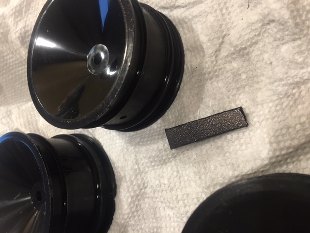

Simple question... anyone know if white kydex is dye-able?

Red, too...aftermarket Kydex bumpers were made for the Optima that were bright red. I subsequently sprayed mine with black Krylon Fusion for Plastic, which is more like a dye than a paint...but I believe SEM Trim Black would be even better.
As for dyeing white Kydex another color than black...might be worth a shot with RIT dye and see what happens. I don't think anybody here has tried that yet.

I wouldn't try to rit dye kydex. Usually rit is used with hot or boiling water.
Kydex is thermoformable, if you boil it it will get soft and lose its bends. not necessarily a problem for flat parts if you expect it and prepare a flat drying/cooling spot, but things like bumpers that have bends in them will all lose shape.

I was wondering about that. I was wondering if I could dye it, then re-heat and form it. Or I guess I could dye it and then pull it out and put it right on the form to get the bends I want if boiling water will get it to the right temp.aconsola wrote: ↑Tue May 16, 2017 6:26 am I wouldn't try to rit dye kydex. Usually rit is used with hot or boiling water.

Very true, I forgot about that. Kydex would probably melt and deform in a pot of boiling water. Duh...aconsola wrote: ↑Tue May 16, 2017 6:26 am I wouldn't try to rit dye kydex. Usually rit is used with hot or boiling water.

I tossed a small piece of white kydex in when I was dying my wheels black. It worked. Didn't see signs of any deformation, but it was a very small piece sitting in the bottom of the basket.
