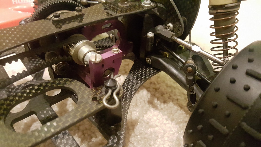

Hello
I only 3x 94 and 1x Pavidis YZ10 and non come stock with tension devices. I I purchased my Pavidis second hand and it was modified to include a bearing mechanism near the small one way pulley which helps improve bent contact and also takes up some slack. It also raises the belt up so I can run a shorty style pack vs a saddle.
My Pavidis is more of a novelty because I dont really have the parts to support though I do play with it from time to time...not enough to comment on how well the tenson mechanism actually works...
I will take a picture at some time an post it for your reference...
Regards and looking fwd to your review of the front belt.

That's the concept used on the yr4 and hot-dog to run a stick pack under the belt. They even use a second one further forward to keep the belt level before dropping down to the front diff.
