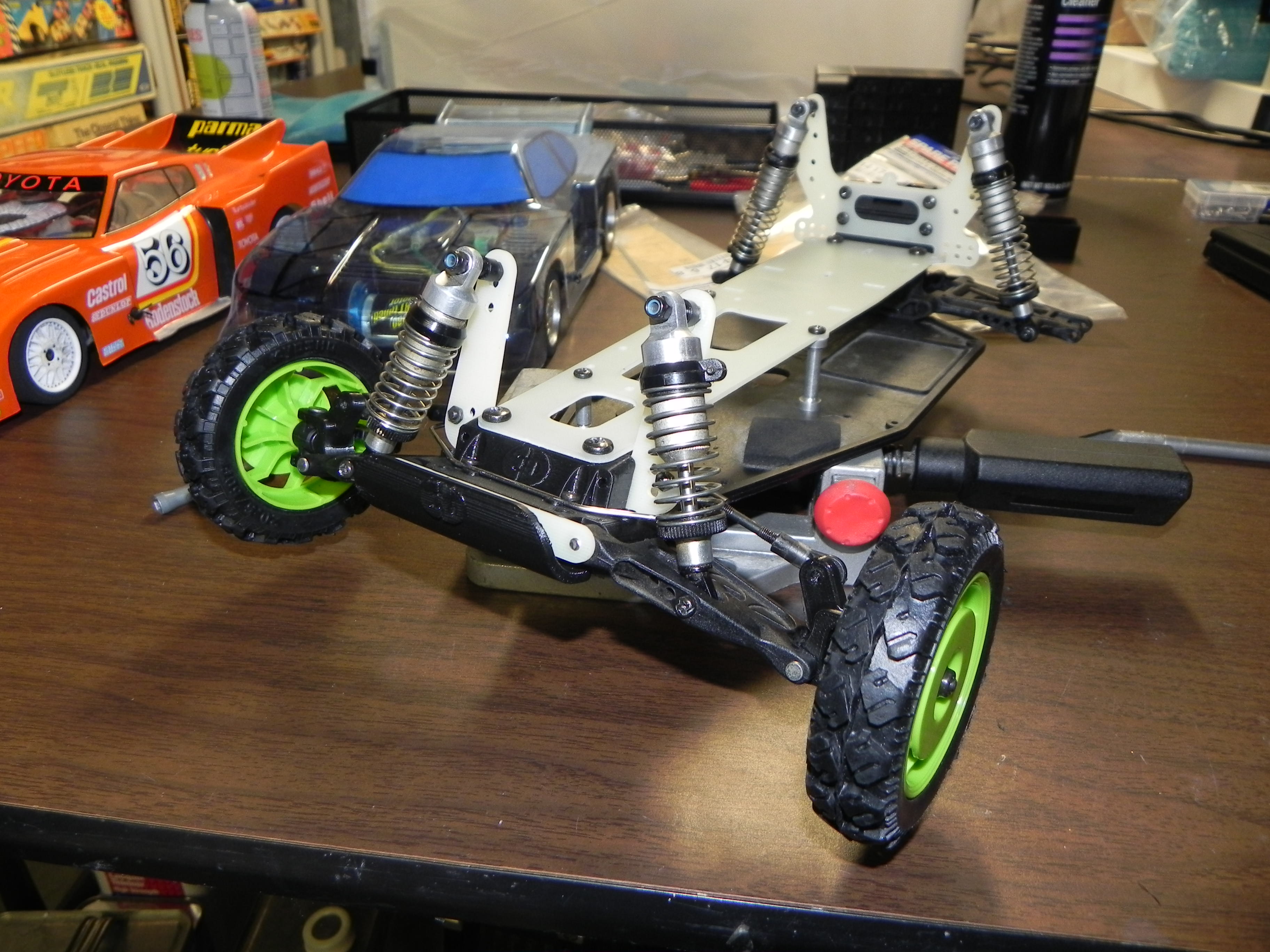

Time for some pictures:
Dan's Ultima II with the new front bulkhead, hinge-pin brace, C-carriers and bumper. Possibly also printed steering knuckles... Dan?
Body mount and battery posts were also printed, and the G10 shocktowers and topdeck are all Dan's making.

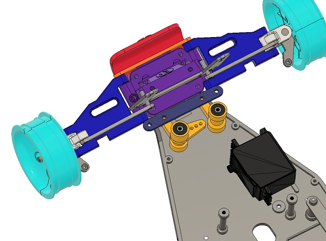

First version of a hopped-up steering set-up by Dan. the final version will use 10x5mm bearins instead of the 11x5mm ones shown here.

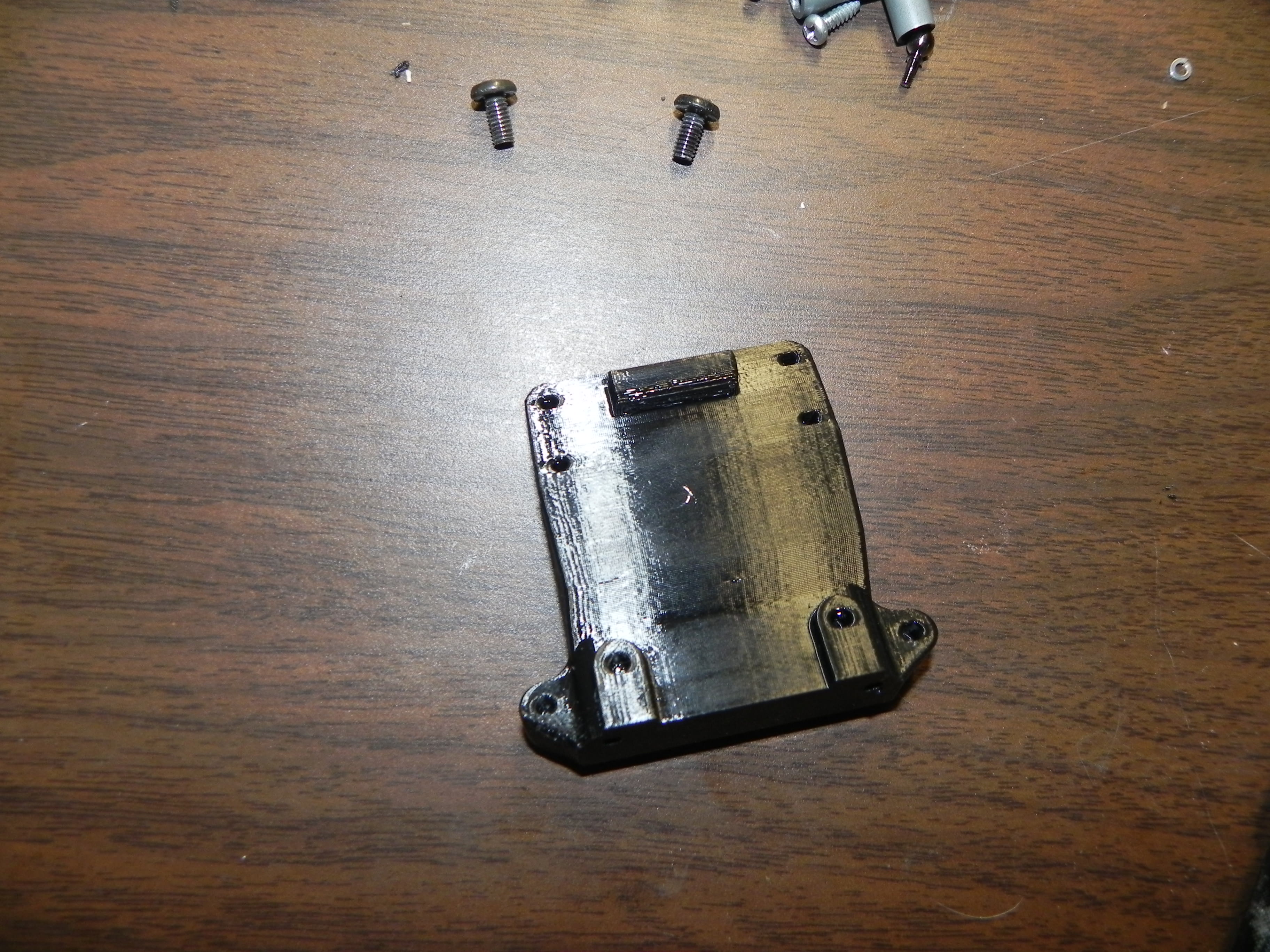

The rear bulkhead has no hop-up value and was just drawn in a basic shape to complete the mock-up. Dan decided to print it anyway and you can see some of the changes for the filament printing.

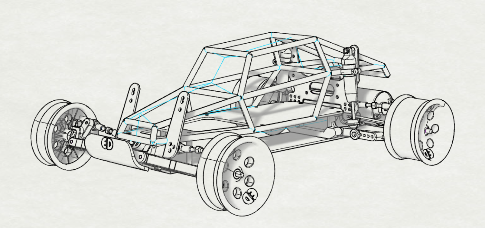

Re: MR ED 's ultima hop-ups
Started a first attempt at a cage style body.
What do you think? Note the new topdeck. Big thanks to Jeff. It would have taken a lot more time without his dwg.

looks good, like a scale baja crawler. For a sand rail, I'd think you might want to lower the cage a little. depends on what you are going for.

I want something tubular, that would look right at home if parked between a wild-one and this:
Retro is key for this one.
It's probably going to be higher than a stock ultima body cause I want to keep the 2.2 wheels and long shocks but put them to better proportions. And I'll probably widen it to a double-seater too... To keep the legal width but not have the wheels stick out as far.Retro is key for this one.

Your cage design indeed has a distinct Wild One look.
