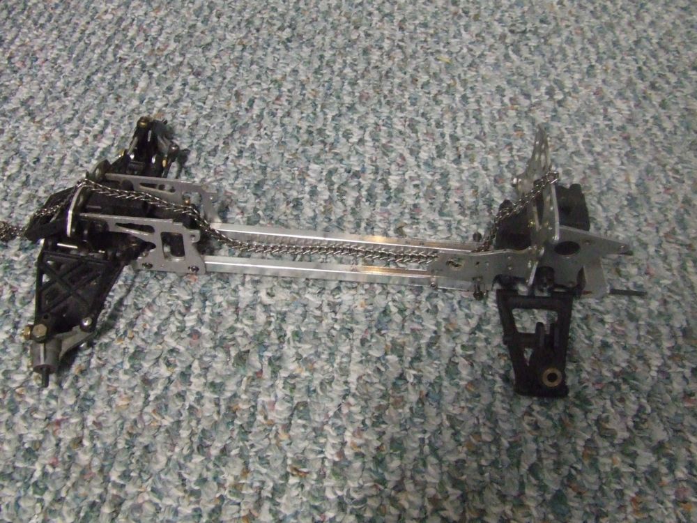

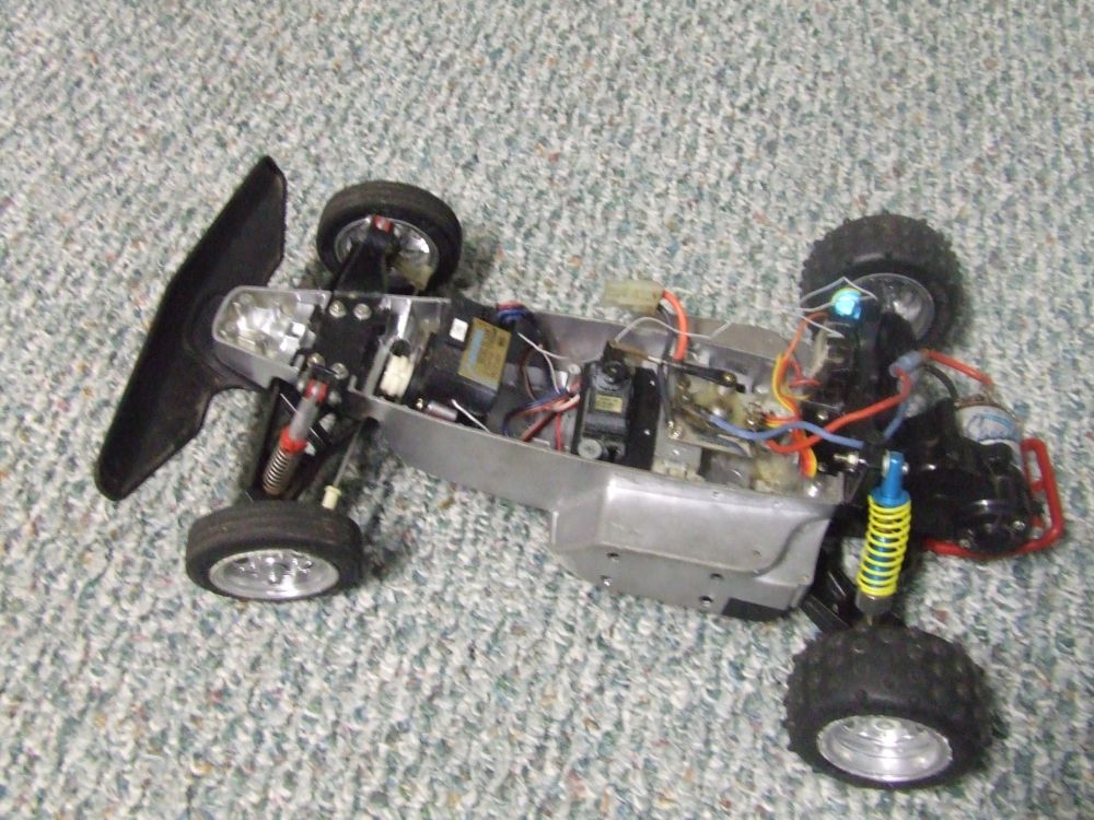

Hey, i need this car identified, not sure what exactly it is, front suspension has a different suspension peices then orriginal, original looks like rear. I have all the parts for this car intact except for one main tranny gear, wel get to that later.

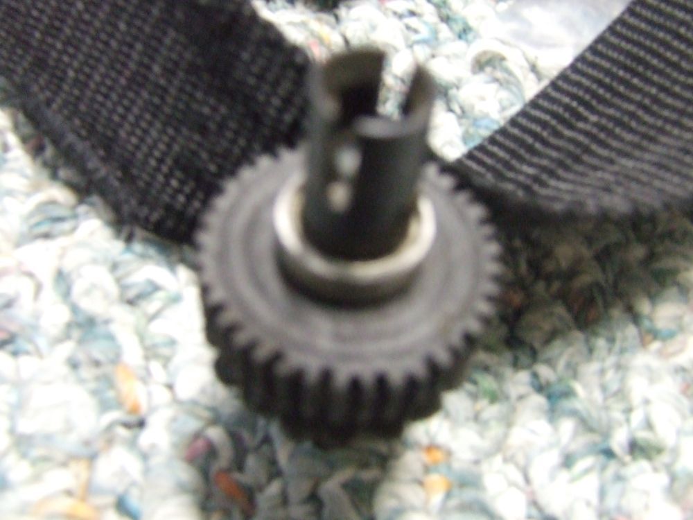

I have all the parts to make it go, may be a little ugly till paint, cleanup, and rebuild, but my main tranny gear, one half of the differential i believe, is chewed up, and it doesnt run right. I need this gear, trade options after the picture. If you can identify the car, please let me know, and if you know where to buy the part strait up (not ebay, my dad doesnt like ebay) like tower hobbies, let me know. If you know what car it is and have the part, i will make the following trade options.
If you have a spare of the top gear in the picture above, i can offer you the folowing:
-$10+ shipping
-Any stock black plastic e/tmaxx parts unoppened maybe, oppened but never used, or open and slightly used (my uncle poured hundreds to make my emaxx all aluminum, and i have virtually every plastic part unused lying arround.
-this entire car, w/out electric (servos, radio, engine), works great, but has rear suspension problem, dirty, needs paintjob for certain parts, you must provide shipping for this option -or if your generous, and just want to give the part to me
-or as a last resort, ill give you all of the parts i have for this car in exchange for any rc10 parts, stealth tranny for orriginal rc10
pm me for any trade options, btw, all aluminum parts on this car were hand filed based on pictures according to the orriginal owner who i have lost contact with

The bottom one is a Futaba FX-10. The top looks to be a Kyosho Optima knock off, don't have a clue what it is.

The top one is a Great Vigor Beagle. Spares weren't available when it was new, thankfully it was a copy of the Kyosho Optima so parts for the Optima will fit. A Kyosho optima diff gear will fit, part number OT-27. You won't find them in any shop though as they haven't been made for at least 18 years, ebay is your only source.

crap was afraid of that. Ill see if i can sell the whole lot, cause the thing is useless w/ a chewed up diff gear, except for spare parts

You just need the outer gear right? I'm pretty sure I've got at least one. I'll send you a PM after dinner...

The only problem with the beagle is that the arms are too short or the dog bones are too long. When you set up the camber to the proper specifications (0 to -2 degrees negative) the dog bones bind. Most of the ones I've seen (including the one I built) had to have a few degrees of positive camber.

As far as that gear goes i believe an ultima one also worked on the optima.
I only have one extra and it's for my ultima after I run my mamba through it. lol

that's correct: the optima just has a different half on the other side: with teeth for the chain
