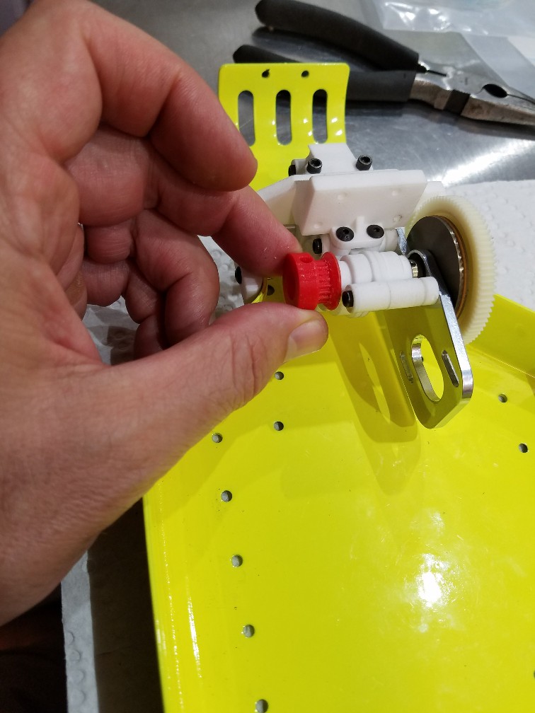

With the 4-gear MM layout, the top shaft is rotating the correct direction to drive the front 2-gear Ten4 gear box. So since the B1M has the slipper on the left side of the car, the drive belt and pulley will go on the right, no problem. Here's my first "mock up", which is me holding a timing belt gear (printed one for Ten4.1 mockups) about where it will go on a pan with a B1m transmission :lol:

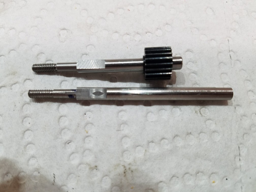

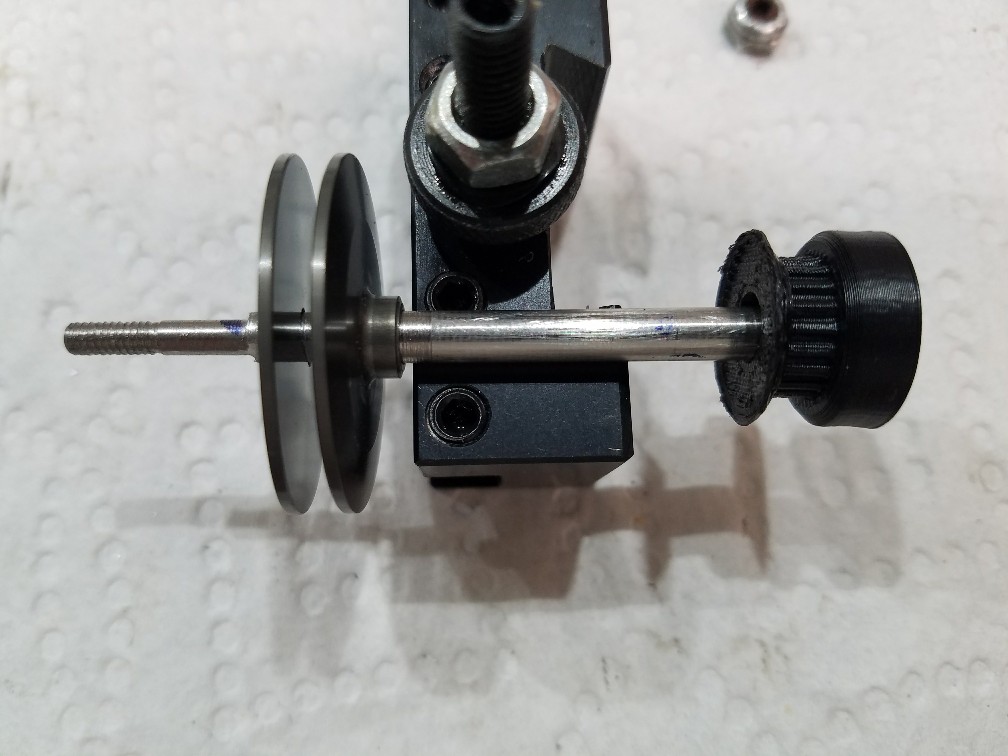

So the big challenge with this is making a brand new V2 slipper top shaft that's extended on the side opposite the slippper, to drive the pulley. So I got busy on my lathe and mill and made one.
Slipper on one side, extended shaft with two flat spots machined in for a pulley on the other, and the gear will go somewhere in the middle.
I'm looking at buying pinion shaft gear blank of the appropriate spec (48P x 20T), and I'll probably shrink fit them on the shafts and/or pin them.

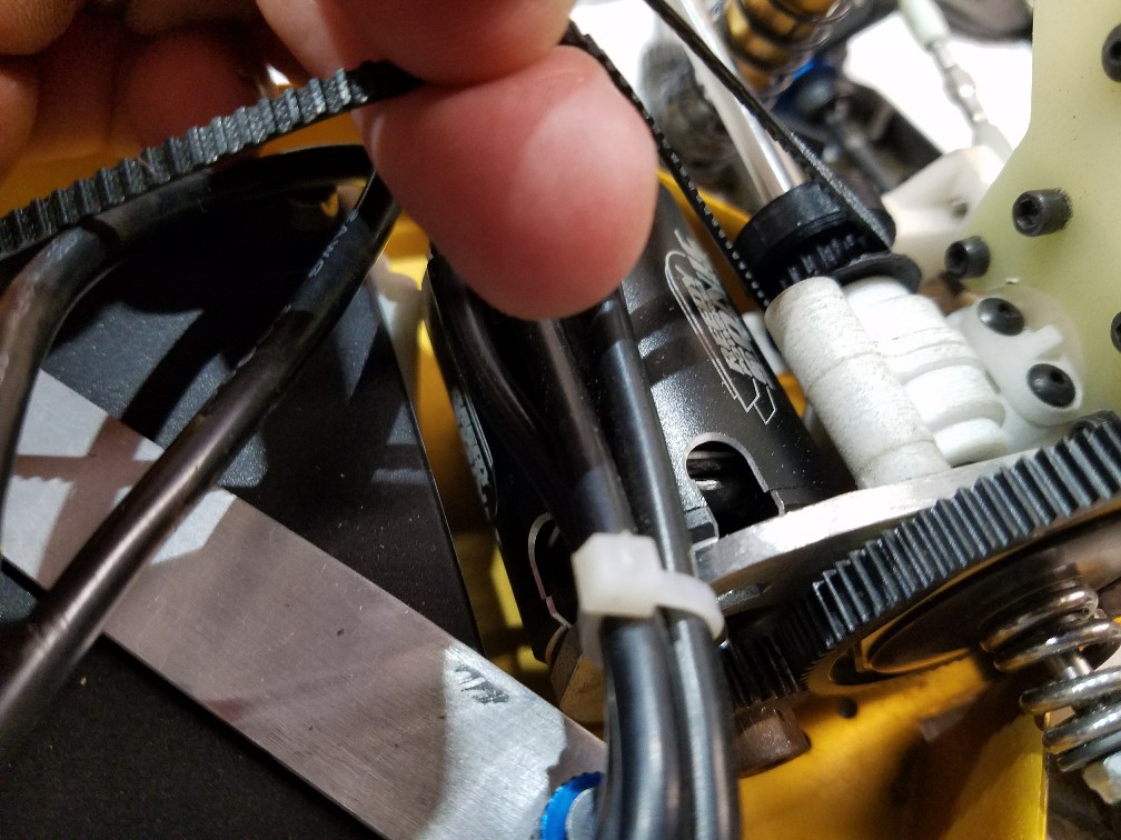

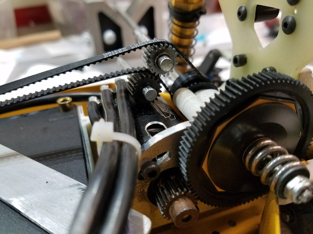

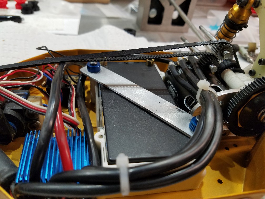

Okay, it's going to work. I did a quick mockup on my B1M test mule. The belt will clear the motor no problem, it will just need to be routed diagonally up for a short distance:
Once I saw that was going to work I just stuck a couple top shafts about where the guides would go to get an idea of the belt routing. From those pulleys/guides it will make a gentle downward slop toward the front gear box pulley. There may or may not need to be another tensioner or guide up front.

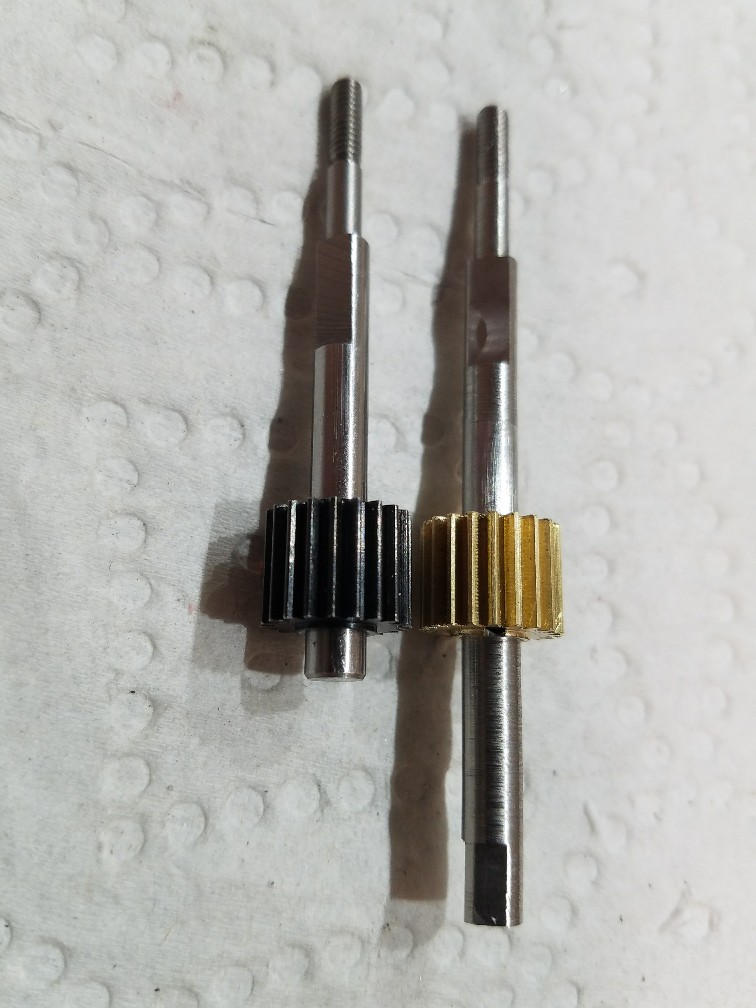

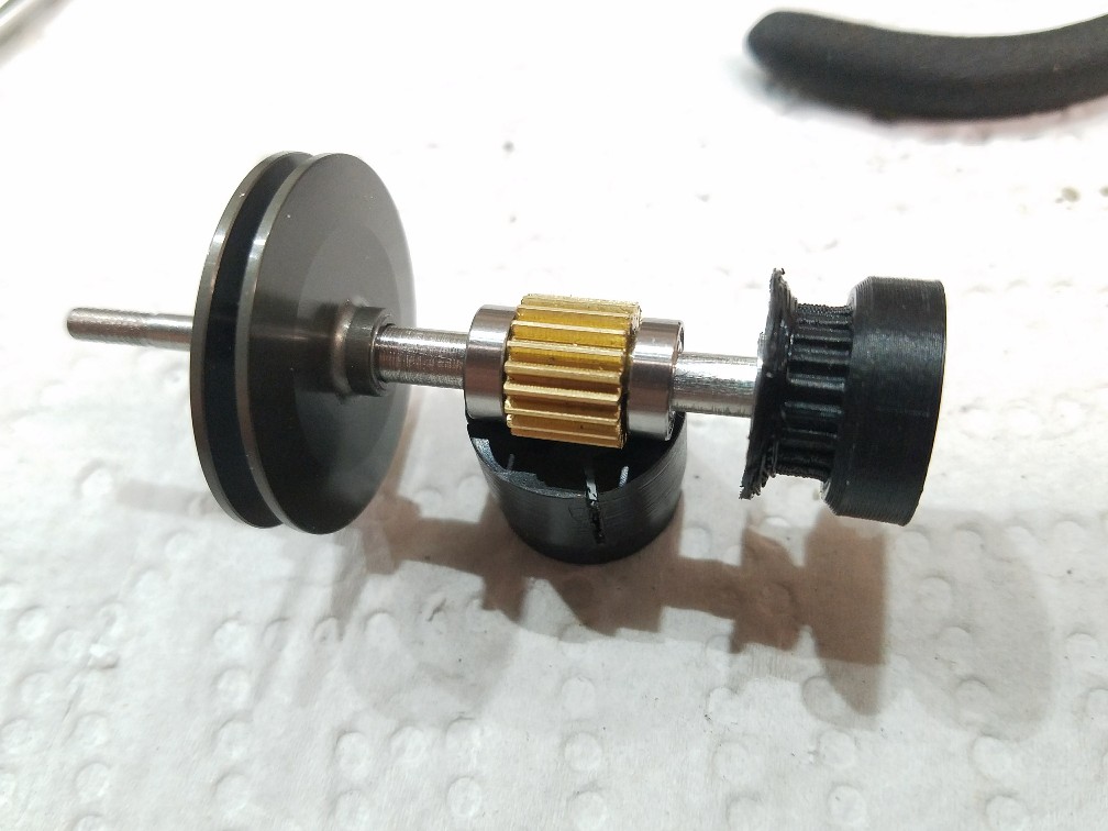

The pinion gear blank (one foot) came in today, so I spent the evening making a gear for the extended V2 slipper top shaft. First though I had to make a bushing for a collet to hold the gear, since it's OD is an odd size. Anyway, here it is, pinned to the extended top shaft I made previously.
Now I need to make another one for the front transmission. The shaft on that one is much easier though, since it doesn't need to accommodate a slipper.

Either way, I still need a custom extended shaft that can take a v2 slipper on one end, like the one one the right here
I guess not having to machine the gear from gear stock would save me some work, but most of the work and setup time goes into the shaft.

Making the gear from the gear stock isn't too bad, a little work on the mill and lathe is all it takes. And brass machines like a dream.
The shaft is much more involved, having a couple different diameters, some flats, and a 5-40 threaded section, out of stainless steel, which is notoriously difficult to machine.
