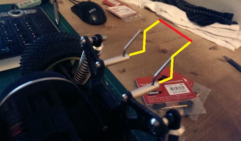

If you use this wing mounting method, I would suggest inserting the wing wires into the tubes horizontally, and use grub screws in the holes on top. Having the wing wires inserted into the tubes will give the wing more stability. I'd cut the wires so that they're long enough to insert fully into each tube before putting in your bends. It would be even more stable if you used a single wire, with a horizontal section for the wing wire to slip through the wing buttons.
With this method, the whole wing assembly becomes a unit and you won't have one side twisting or drooping up or down relative to the other, or either side of the wing wires rotating nearly as much. It's more work with careful measurements and bending, but it works much better.
This is how I mounted my wing, using similar wing tube mounts:
