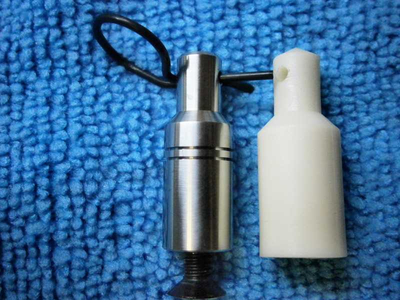

A new episode of "small things"for you guys this morning...
Ti body post

Post by XLR8 »
Oh come on! Now you're just showing off.
Just kidding, I'm totally jealous. Nice work - AGAIN. haha

Showing off? Not yet, but I might! :mrgreen:

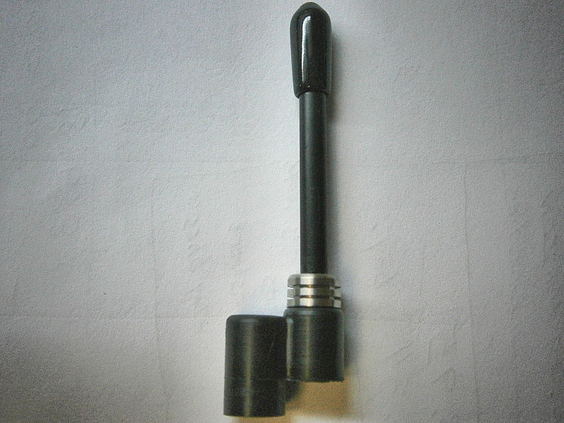

A new episode of "small things"...
I've taken this plain looking antenna mount and added a bit of titanium mojo to it.

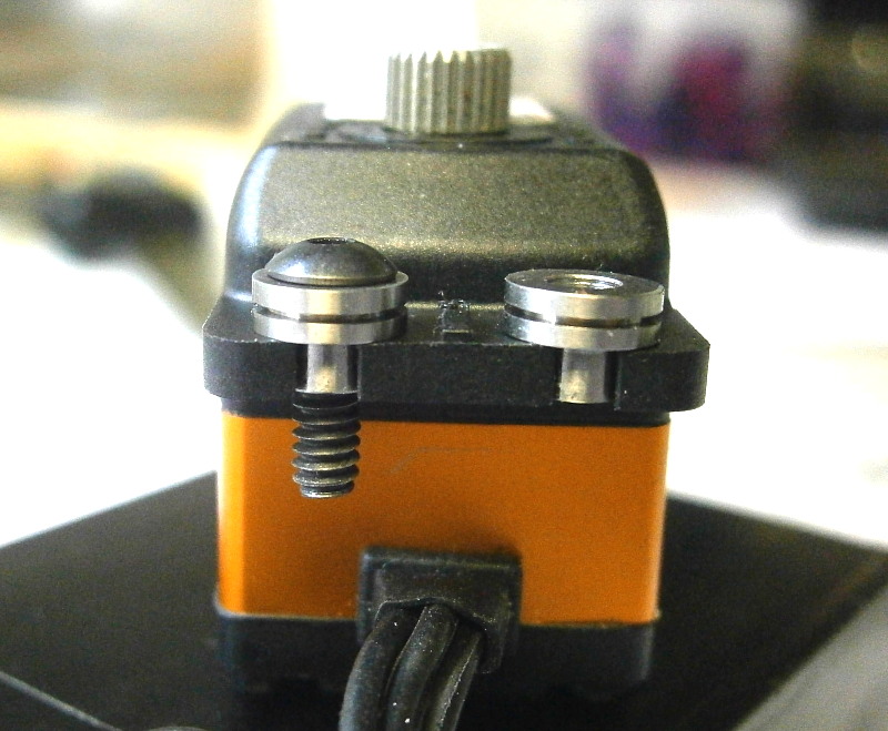

Awhile back I came across the Associated 27128 aluminum servo washers... hmmm, kinda cool, 8 bucks or so. Following a Google look/see I found more of that type of part. Different colors and a few manufacturers to boot. All looked very similar. So, who's copying who?
I wanted some for my B1M build so I go at it with a piece of 1/4" titanium rod and make my own. As not to copy anybody...

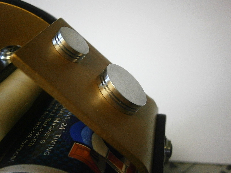

OK...
I made two plugs for the holes in the top of a motor plate today from aluminum. Still have to make the washers to screw everything together (4-40 fhcs).

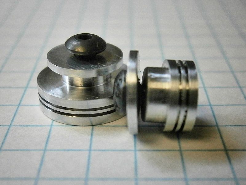

Yes, you can get picky with your washers...

Very nice! And the grooves will add surface area to enhance heat dissipation. :wink:

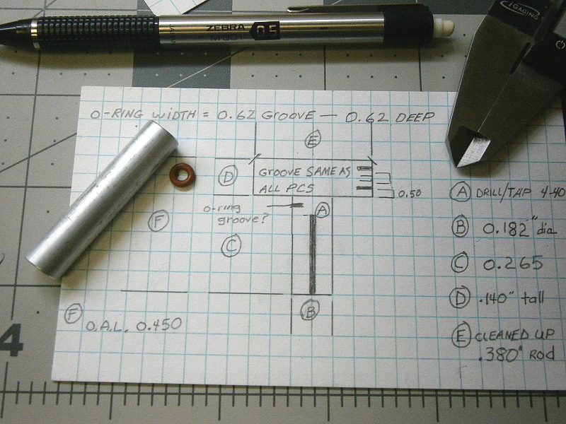

Today I have a special project, a pair of custom battery thumbscrews...

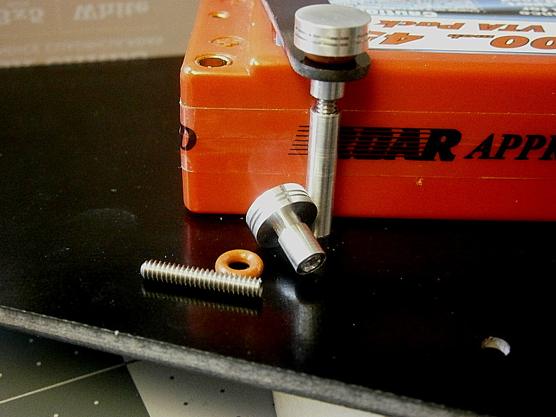

It's what I do 8)
OK, got them done, just need to do a bit of touch up.
I'm using some AE red shock o-rings on the turned thumbscrews. I turned down some 1/8" standoffs to .166" so the lipo battery would slid between them on the chassis plate. There were already holes in the plate, I didn't want to drill more so adapt, overcome!

I'd probably knurl or somehow texture those thumbscrews...if they got on too tight, you wouldn't be able to get a grip and would probably have to use a pliers or something to loosen them. 8)
For a shelfer, it wouldn't matter, of course.
