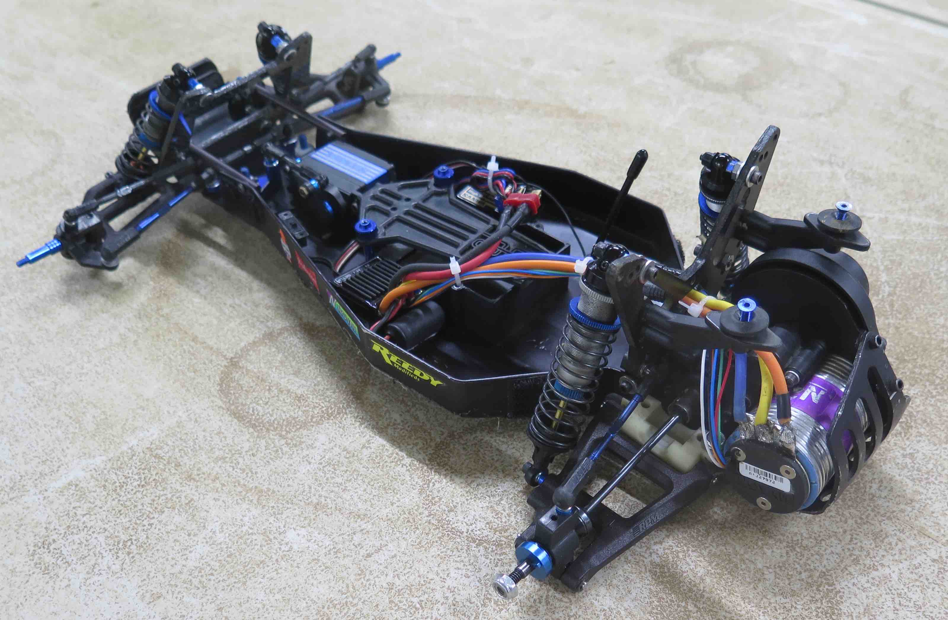

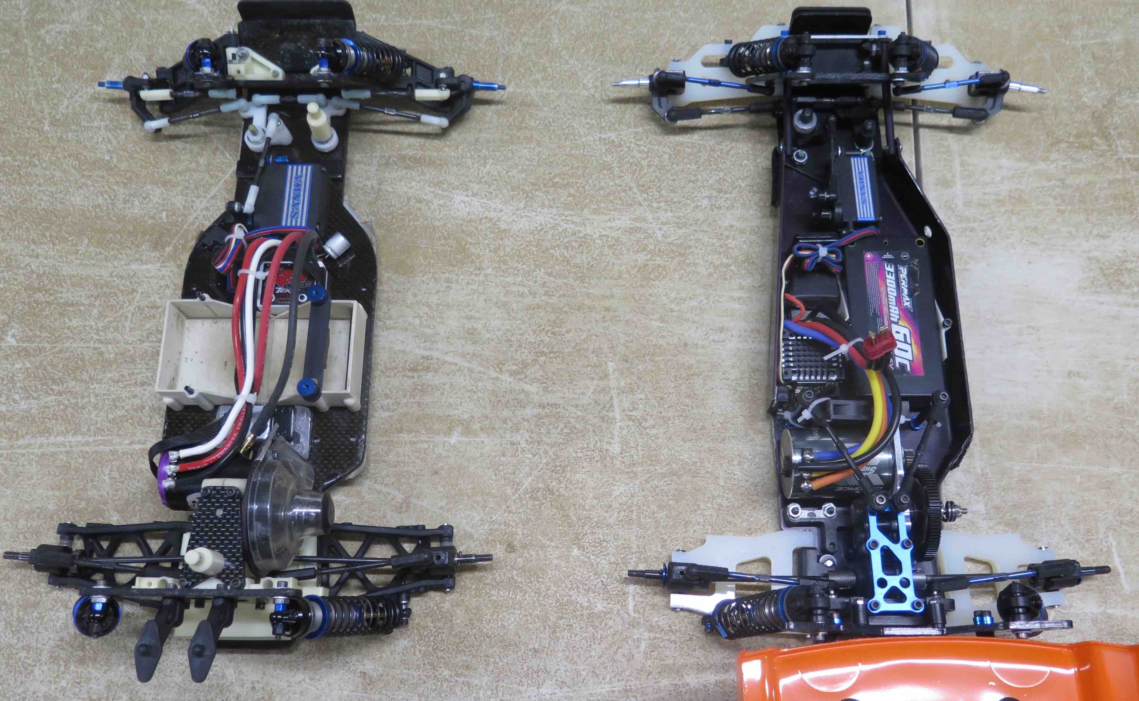

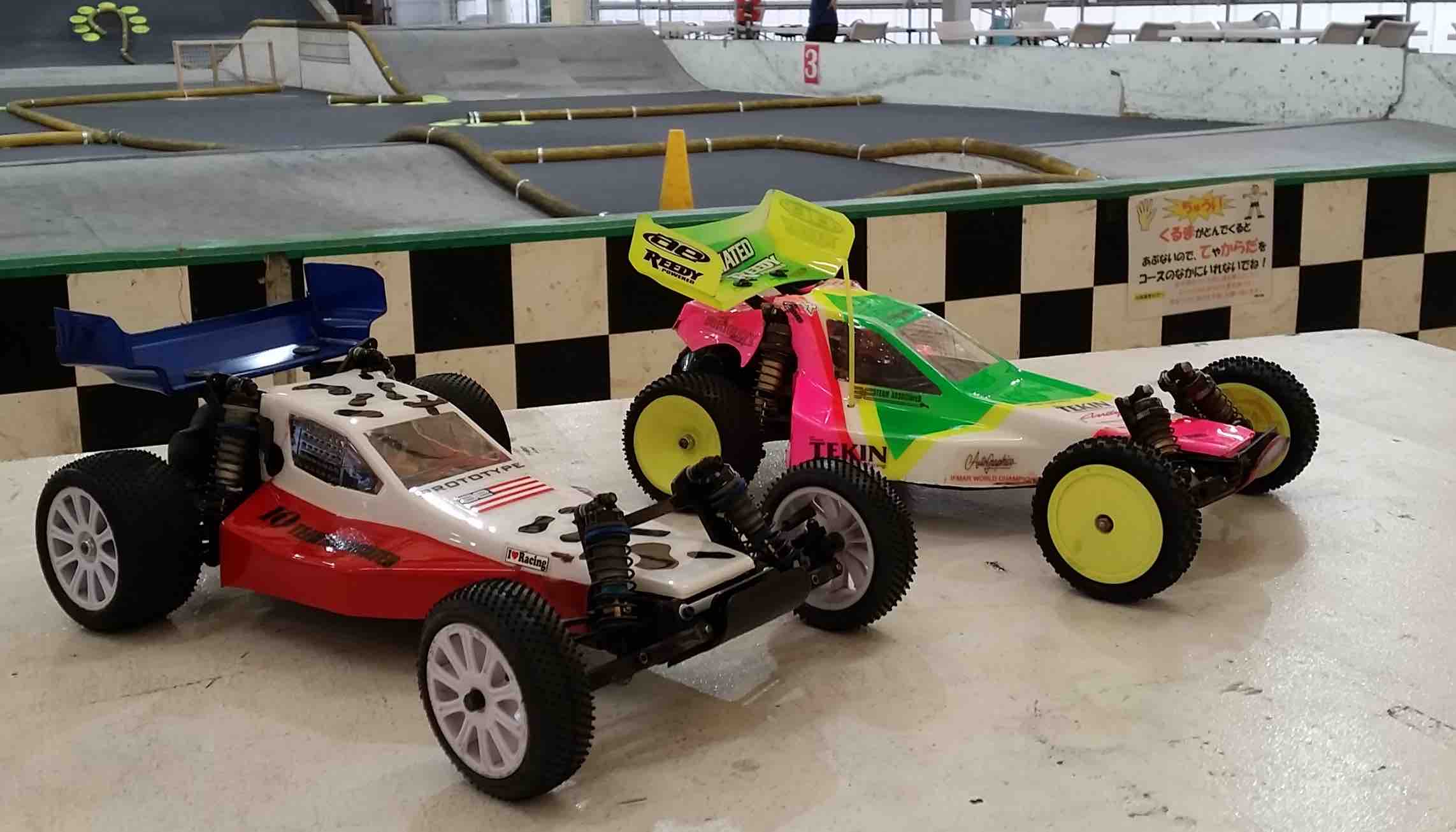

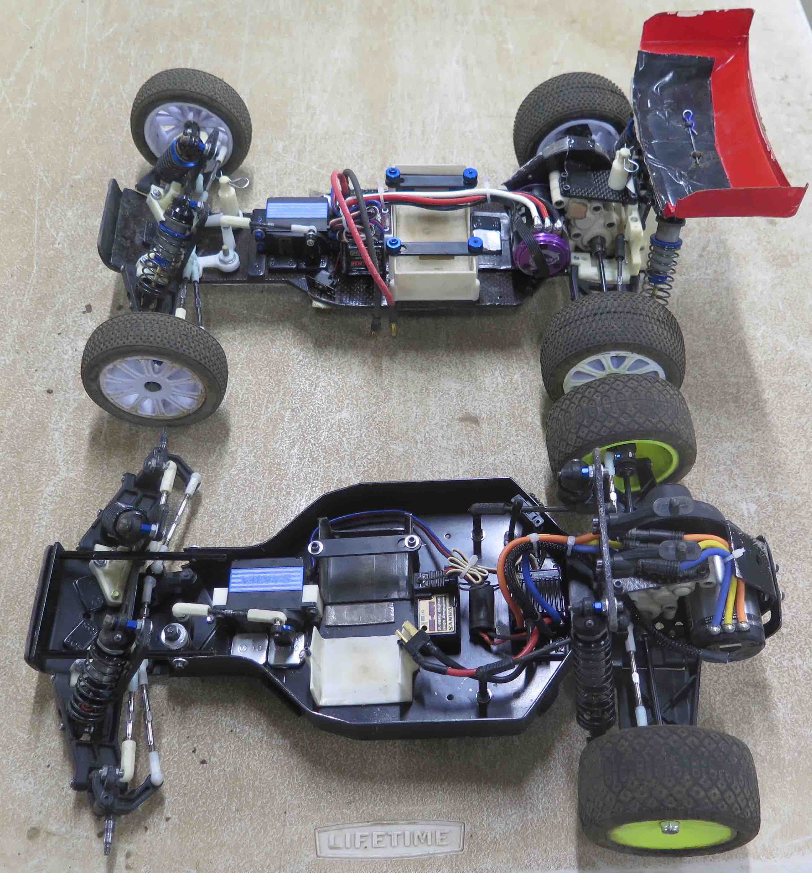

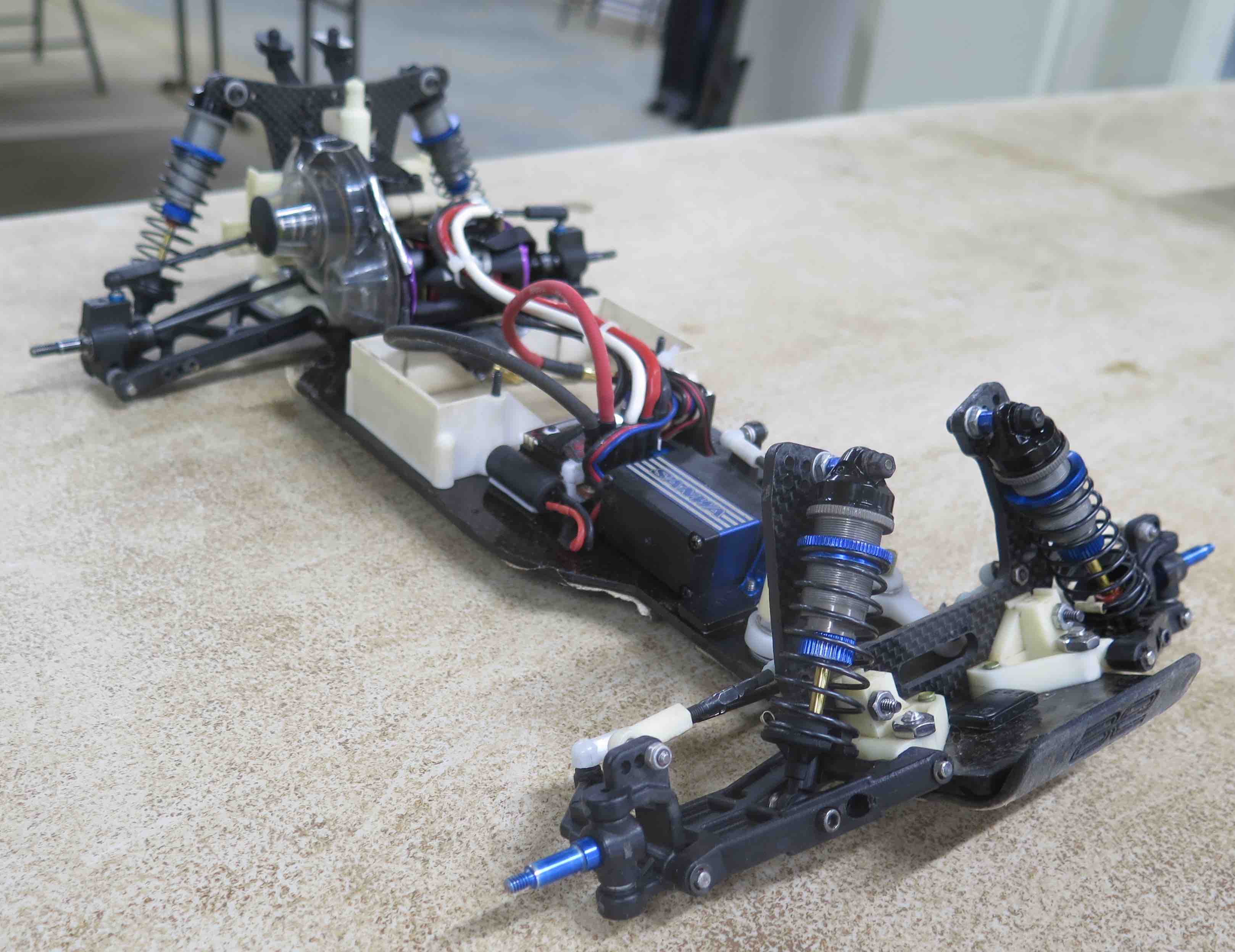

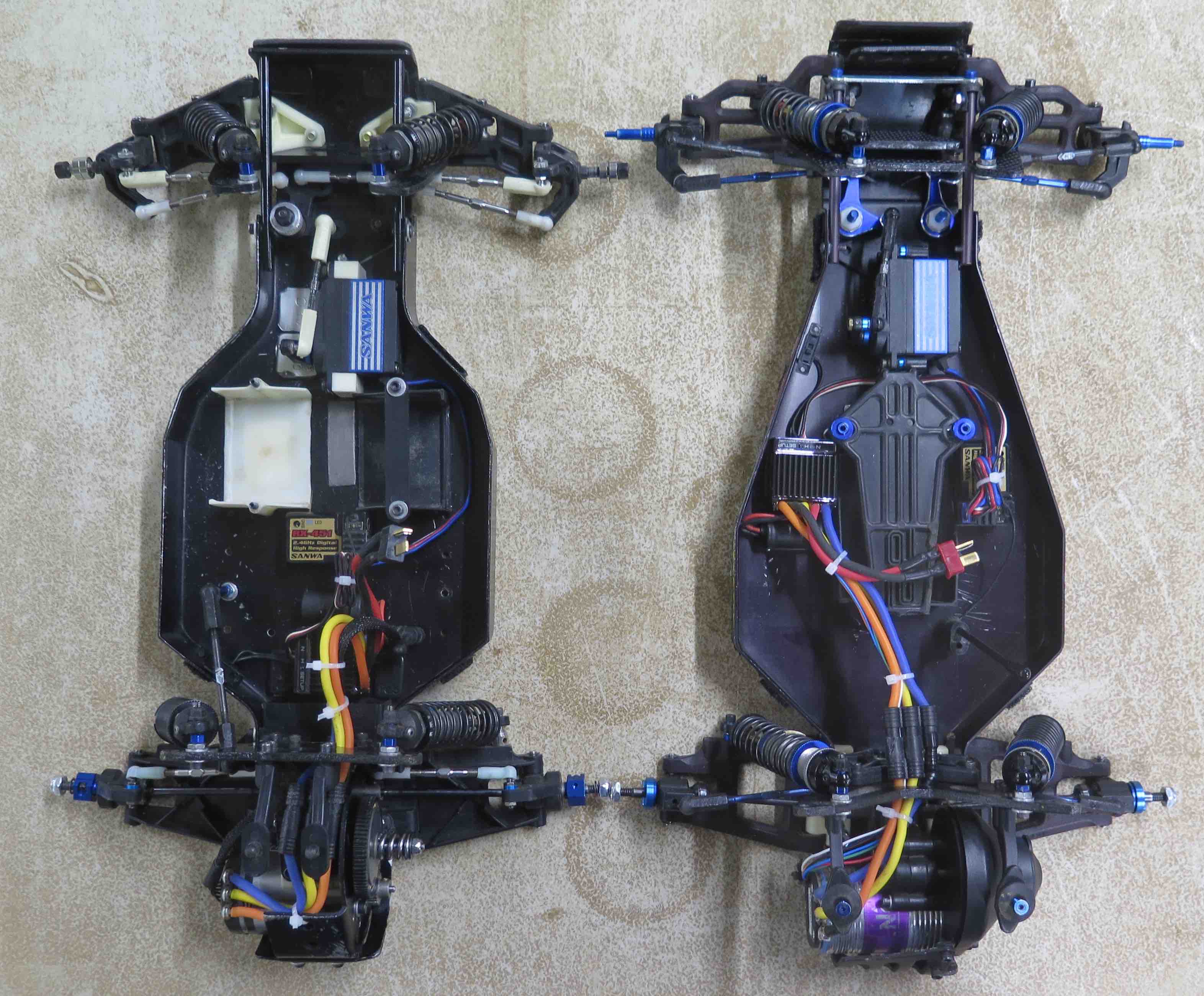

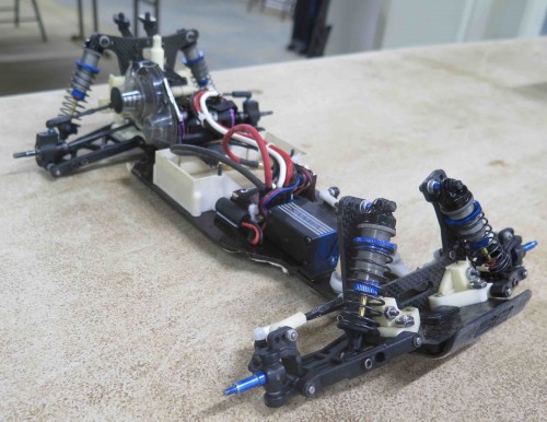

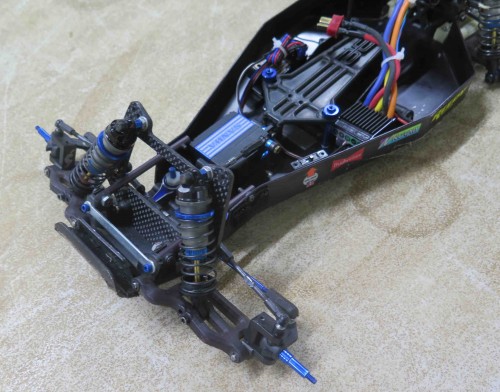

Since B1.5 was introduced above, I decide to describe my B1.5 here by comparing with my RC10.
<Introduction>
This B1.5 is T2 buggy. I use the T2 nose plate with the stock T2 chassis length and change the T2 arm to the RPM Worlds arm (dyed black). I would like to call this car B1.5(WOIN).
T2 chassis use the short wheelbase (SWB) holes on the rear arm mounts. Therefore, the distance between the rear axle and motor is longer than my RC10 (using LWB holes), and the chassis weight is heavier.
Because of this weight distribution, it is expected that B1.5 has more traction than my RC10 (and stability due to the longer wheelbase). However, in corners, it would have understeer during acceleration.
The chassis does not accept the transverse battery position and weight would be spread in the longitudinal (inline) direction. To make B1.5(WOIN) faster, I tried to optimize weight distribution and adjust suspension settings.
<Introduction>
- Posts: 77
- Joined: Thu Nov 23, 2017 11:34 am
- Location: Japan
- Been thanked: 43 times
Re: My RC10 (runner)

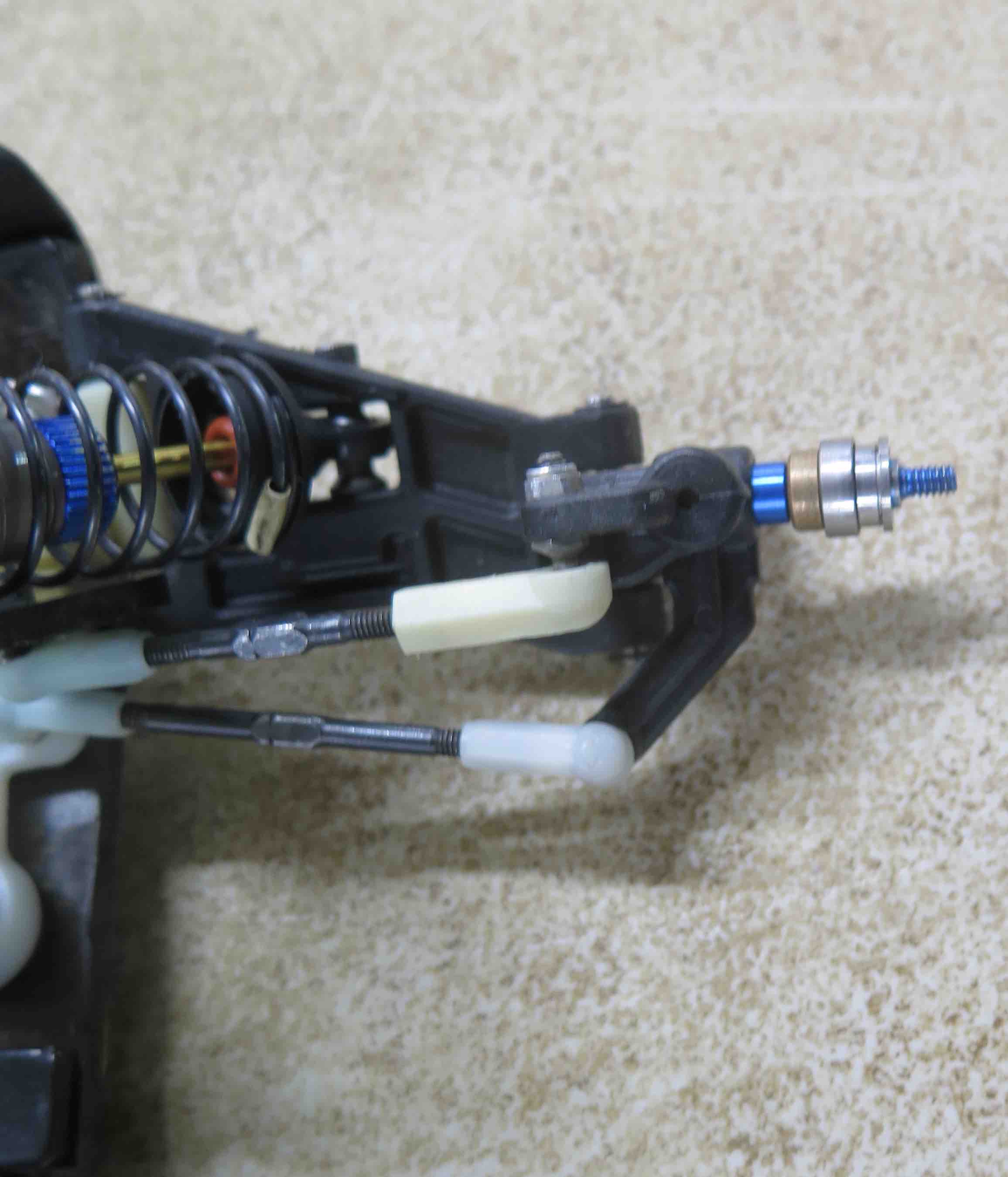

<Front>
・RPM Worlds front arm
・Front bumper from RPM
・Front shock tower from FibreLyte, "RC10 tower-Raymond Power"
https://www.rc10talk.com/viewtopic.php?f=38&t=33388&sid=6da407611632cce403fb197ffc9ad35f#p379717
・This shock tower allows you to adjust the roll center (I use the highest hole for a clay track)
・B4 big bore front shock
・#35 oil and green spring, outside hole on the arm and inside on the tower
・Shock tower, nose tube and suspension mounts are tightened with hex nuts
・J-concepts RC10worlds steering bellcrank (use AE nylon nuts)
・Custom Works 5deg caster block (-5deg) with B3 king pin (using outer holes)
・Stock inline steering block with GT axle (front width is close to 250mm)
・Stock ballstud with two shims below it on the steering block (no bump in/out)
・The steering servo is moved toward center with spacers
<Middle>
・B44 battery post with T2 battery holder (chopped off for shorty)
・RC10 battery cup attached by double sided tape
・ESC is moved forward as much as possible
・Radio receiver is placed on the opposite side of the ESC with 15g weight below it
<Rear>
・RPM Worlds rear arm
・Modified stock T2 shock tower with wing mount holes added
・B4 big bore rear shock (T4 rear shock cylinder is used to have enough droop)
・#30 oil and gray spring, inside hole on the arm (for tire clearance) and the most inside hole on the tower
・RC10 re-re arm mounts
・Add a 2mm spacer between the shock rod end and rear arm
・Custom Works hub carrier with 2mm spacer below the ballstud (adjust roll center to erase the leftover roll at/after corner exist)
・Axle spacer crush tubes (AS7377) in the hub carrier
・B4 top shaft with V2 slipper, and RPM B4 gear cover
・B44 rear CVA
・Custom Works rear axle spacer 0.125inch and B4 rear axle wheel spacer
<Other things>
・10.5t blushless motor
・I can run with modern cars without any problem
・In the video, black spring on front and white for rear were used (you can see that the car rolls excessively).
・Rear shock tower requires a modification to lower the shock mount positions (I will post how to do it later)
・Viper body with Velcro tape (rear is chopped off)
Please let me know if you have any questions.
<Middle>
<Rear>
・B44 rear CVA
<Other things>

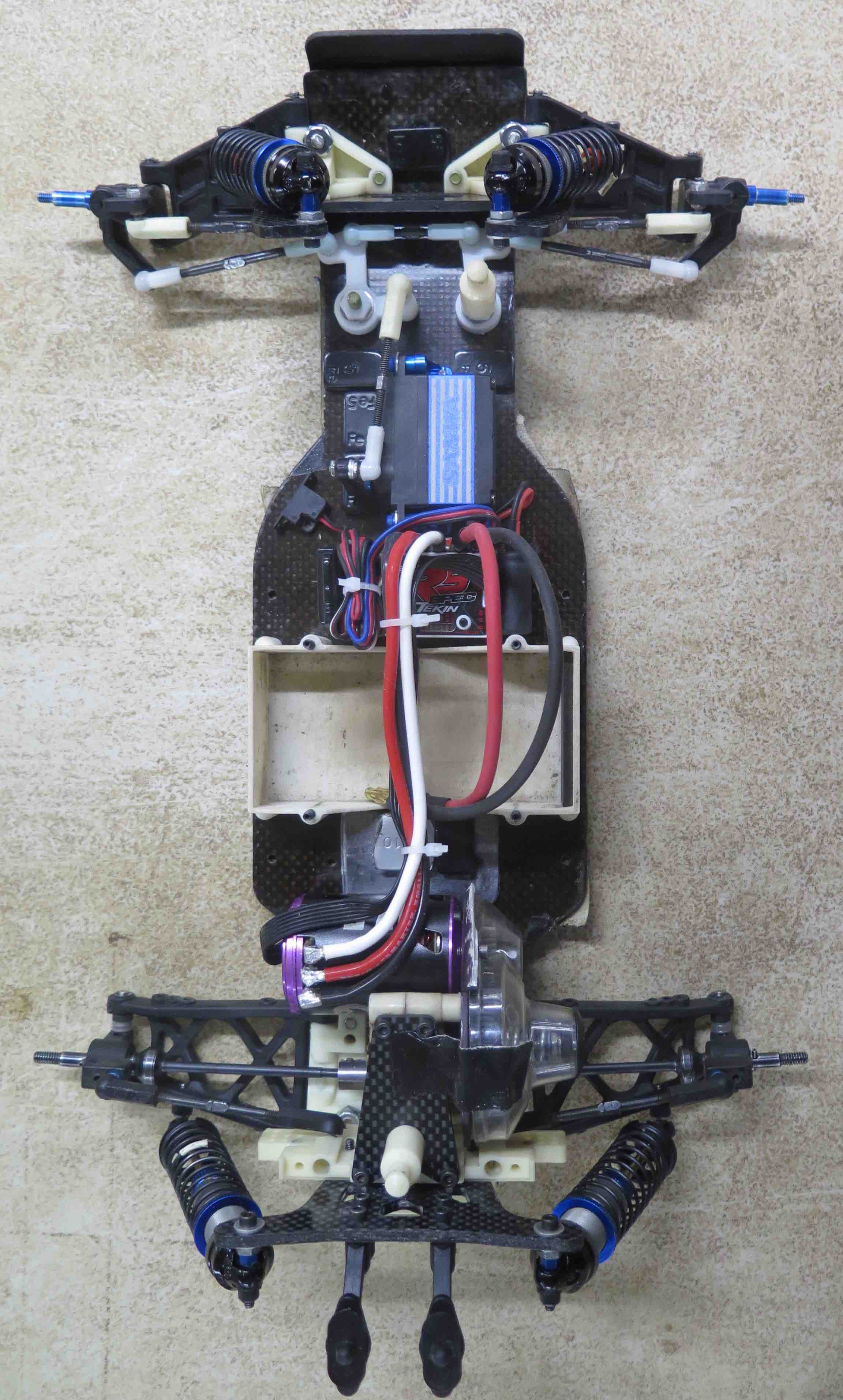

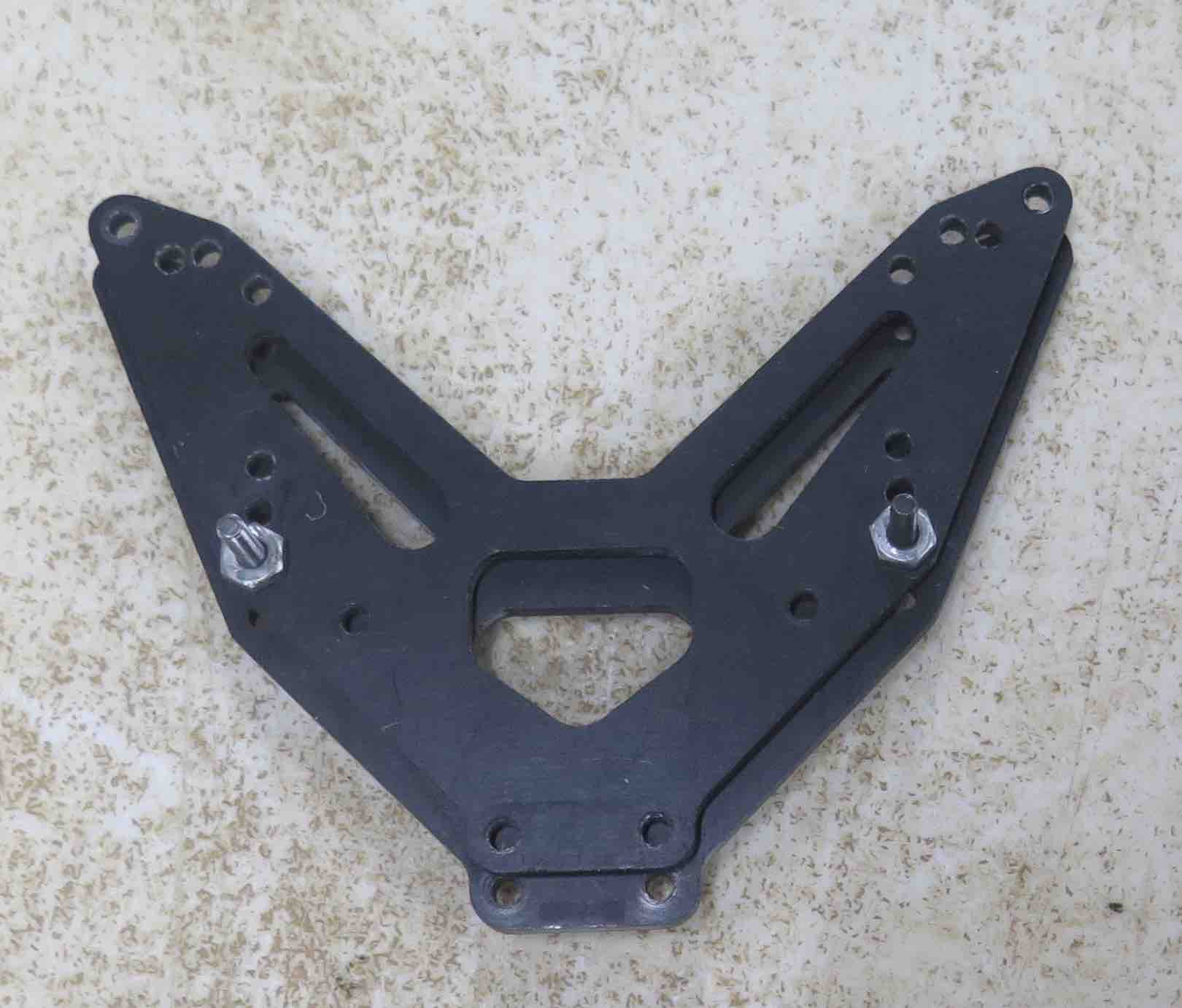

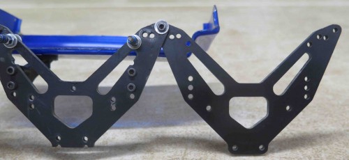

<Rear shock tower>
Modification is easy.
1. Put two shock towers together by using the bottom and second holes of the body mount holes.
2. Cut the bottom of the shock tower and add four shock tower mount holes by using the shock tower in the front side as a reference.
3. Add wing mount holes. Here, the second body mount hole is used for the bottom hole of B6 wing mount.
A vintage RC guy told me how to do it.
B1.5 and my friend's World's car. TC3 sticker is my respect to the originator.
https://www.rc10talk.com/viewtopic.php?f=35&t=10842&sid=ea094c5ecb58e98d965dc88880fd539a&start=210
Note that above suspension setting is for a clay track and a carpet setting is different.
Left is the modified shock tower and right is T2 stock shock tower.Modification is easy.

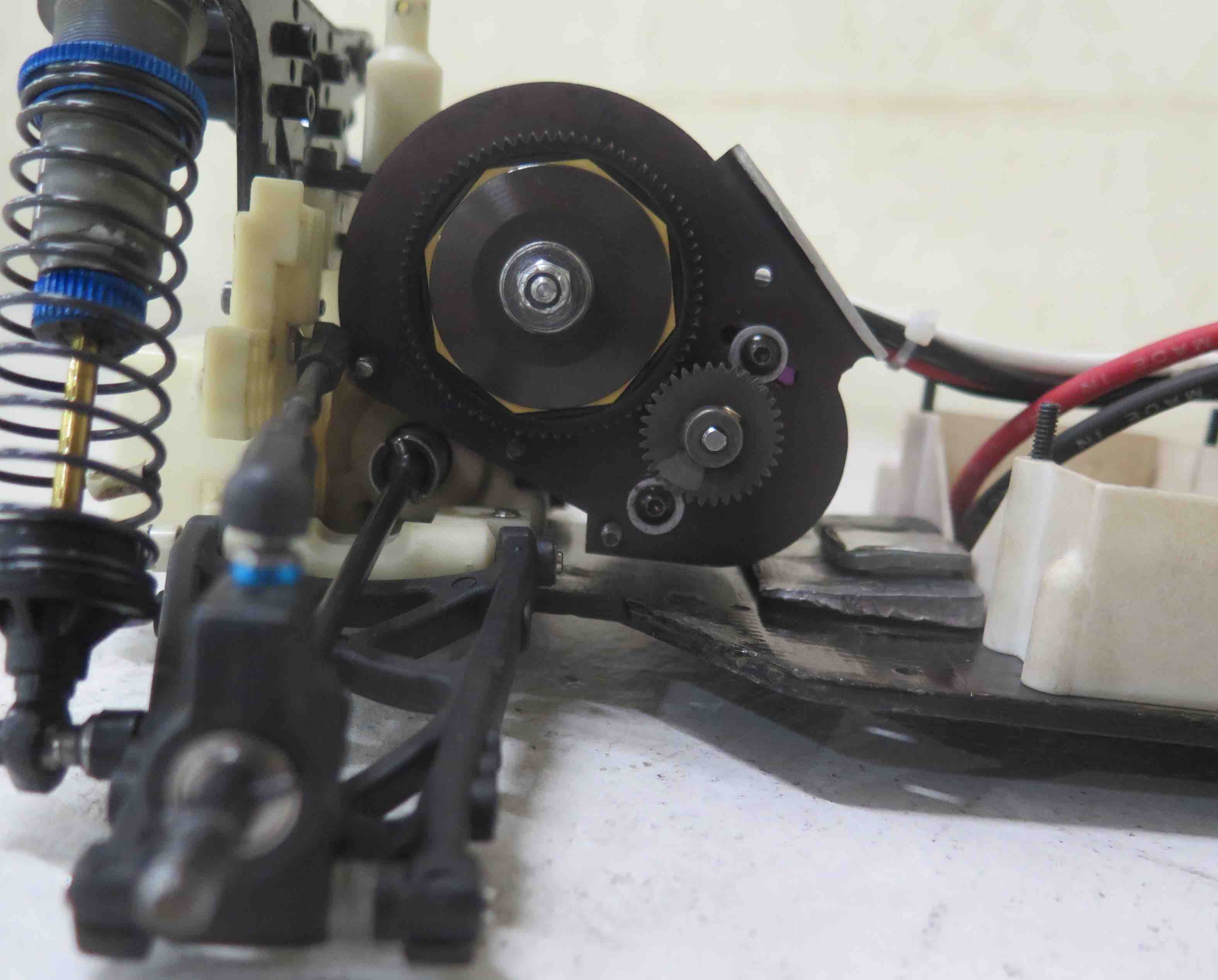

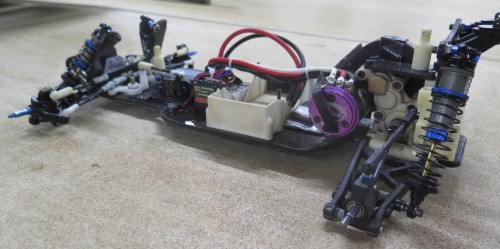

Next cars are mid motor RC10s. One is the car with the flipped stealth transmission (stand-up style) and the other is the electric conversion of Nitro DS (laydown transmission).
I describe the stand-up mid first (RC10B1M-D??). I would just call RC10Mid.
<Introduction>
This RC10Mid follows the conversion method explained in below topic.
https://www.rc10talk.com/viewtopic.php?f=38&t=37625
I also added some modern twists.
This car turns like a mid-motor car but still has a good rear grip. I still feel as if I drove a rear motor RC10. However, the car is not as strong as RC10 so I run with 17.5t motor.

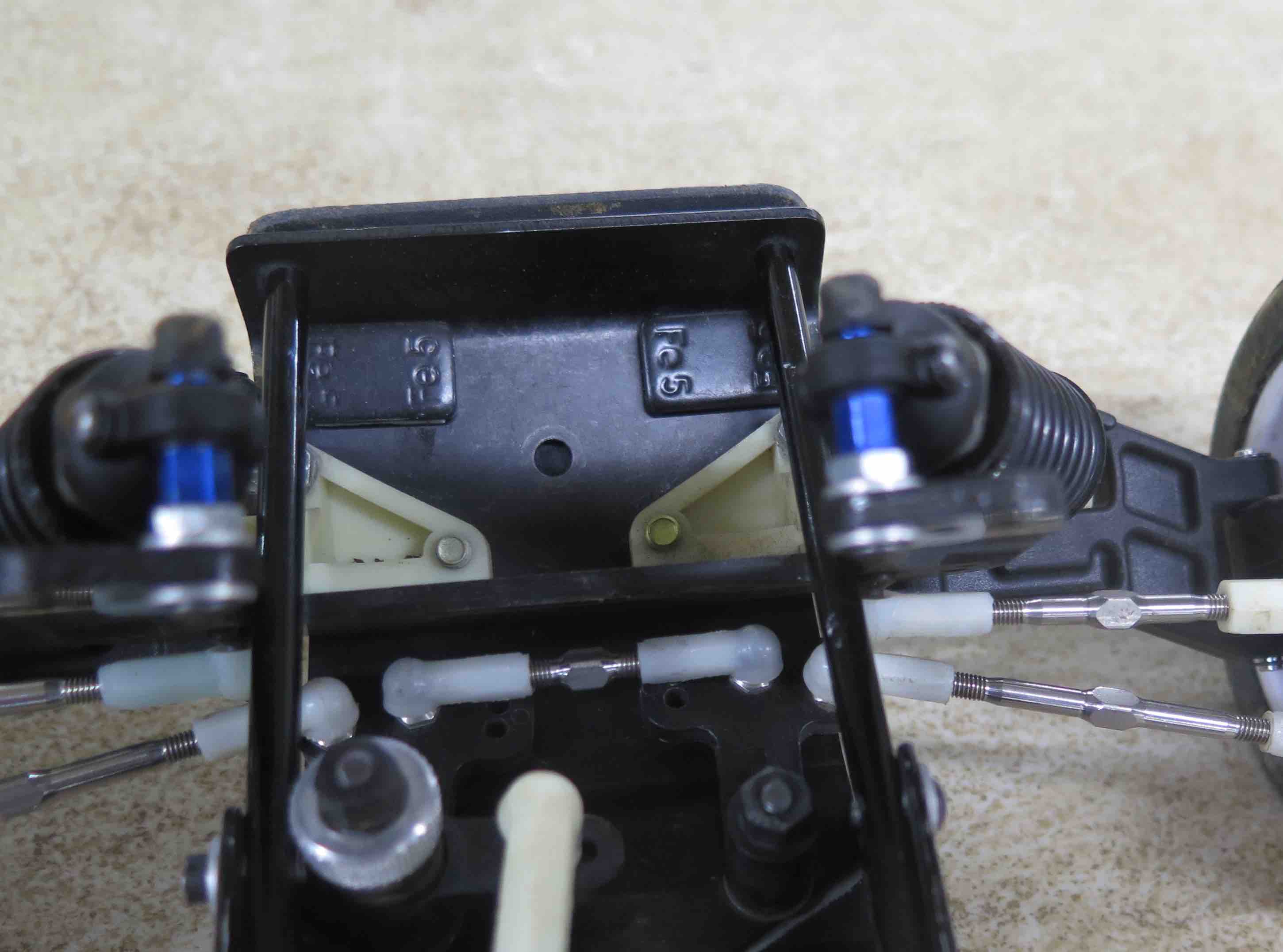

<Front>
・Add 20g weight around the steering servo (depending on ESC weight)
・Front bumper from Shapeways (rapid_rc)
・Long front shock tower from Carbon works (3mm)
・#35 shock oil and green spring, outside hole on the arm and center hole on the tower (different setting from that shown in the picture)
・Shock tower and suspension mounts are tightened with hex nuts
・Stock RC10worlds steering bellcrank (add one aluminum washer between the bellcrank and chassis)
・B4 30deg caster block, swap left to right to lengthen the wheelbase (shims in bottom) and to make the caster angle 25deg. ・Inline steering block with T4 axle, a part of the steering arm is cut off to increase maximum steering angle
・The ball bearing and spacer setting in the picture is used to achieve 250mm front width with B4 wheel. This tends to make the car dull and the outer ball bearing is sometimes busted if you tighten the wheel nuts too much. I don’t like this setting and I don't usually use it (depending on a track layout).
・B4 low profile ballstud without shim on the steering block (no bump in/out even with this setting)
・Above front shock setting might be too soft. I am thinking to try #32.5 with white spring with inner hole on the tower next time

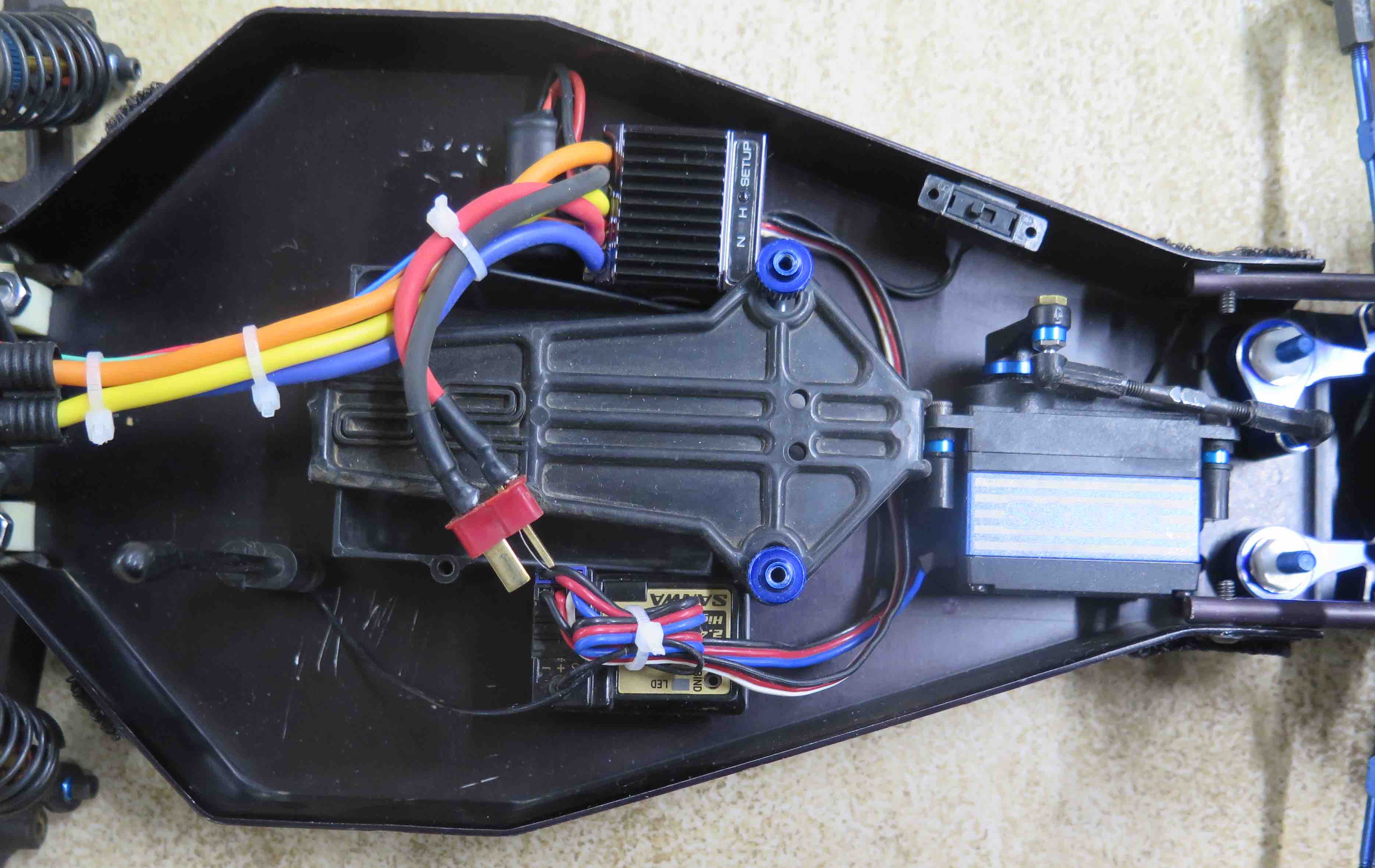

<Middle> ・ESC and radio receiver behind the steering servo
・RC10 Transverse Shortie Pack Battery Cups from shapeways (Conklin Performance Designs), attached with second and fifth holes
・65g weight between the battery and motor
・I recommend to add linkages between the transmission and holes on the chassis (there are two screw holes right by the 65g weight) if you want to run with a modified motor.
<Rear> ・Losi VLA XXX-CR arm as used by Janus in this topic, https://www.rc10talk.com/viewtopic.php?f=38&t=10403&sid=aed6cedc26f8ddf0f004fe3da51fd313
・Spacers are added in front of the rear hub carrier to maximize the wheelbase
・Custom Works hub carrier with 1mm spacer below the ballstud
・Axle spacer crush tube (AS7377) in the hub carrier
・Short length shock tower with wing mount screw holes from Carbon works (3mm) for big bore shocks and B5 wing mount
・#30 oil and white spring, inside hole on the arm (for tire clearance) and the second hoke from outside on the tower
・Outer side of the shock rod end is partly scraped for tire clearance ・RC10 re-re arm mounts with long wheelbase holes tighten with hex nuts (rear side)
・Add a 4mm spacer between the shock rod end and rear arm
・B4 gear cover where only one screw hole can be used. To fix the gear cover, two screws are stuck out from the motor plate as shown in pictures and the gear cover is cut slightly to fit those screws. I also use a duct tape to seal the cover.
・B4 rear CVA (6 axle shims inside of the hub carrier for the motor side and 5 for the spur gear side, and 3 axle shims outside of the hub carrier)
・I use B4 pin rear wheels. The rear wheel is locked and one of ball bearings in the hub carrier could be broken if I tighten the wheel nut too much. I will use a clamping wheel hex in future to avoid this problem
<Other things>
・RC10 Graphite Team car chassis is used
・5g weight on the nose in the picture was removed
・How to flip the stealth transmission will be shown in my next post
The second car from left is RC10Mid
<Introduction>
<Front>
<Other things>
