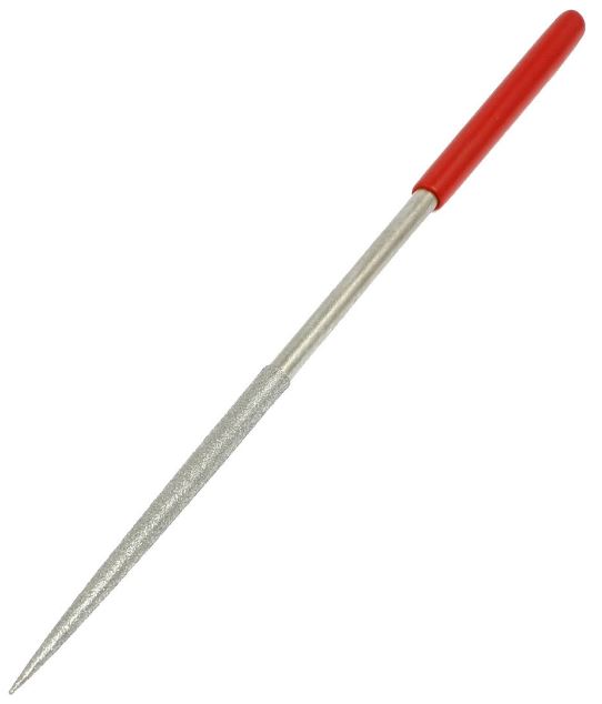

Any idea what sort of file I need? I don't currently have any at all.NomadRacer wrote: ↑Wed Dec 13, 2017 12:36 pm There's no different motor plate that I know of. I use the Reedy M3 series (17.5T) in a couple of black re-release motor plates and had to work on the top slot with a small file. I don't touch the bottom hole. I'm guessing the gold motor plate will be the same.

You need a round rat tail file. It's basically a thin, round file that you use to either widen or extend a hole. They come in many thicknesses with (usually) a tapered tip. The're pretty cheap and you can buy them in sets with different diameters, or with some flat, round, triangular, etc. shapes.Peter_B wrote: ↑Wed Dec 13, 2017 1:18 pmAny idea what sort of file I need? I don't currently have any at all.NomadRacer wrote: ↑Wed Dec 13, 2017 12:36 pm There's no different motor plate that I know of. I use the Reedy M3 series (17.5T) in a couple of black re-release motor plates and had to work on the top slot with a small file. I don't touch the bottom hole. I'm guessing the gold motor plate will be the same.

https://www.amazon.com/SE-7382NF-Premium-Quality-Needle/dp/B0045L7Z1W/ref=pd_lpo_vtph_469_tr_t_1?_encoding=UTF8&psc=1&refRID=WHXS3PVN71MQ9D1FHP3V
lots of sets of these type around. very handle for many things, not just hobby.

Do these look like they'll do the job?
http://www.diy.com/departments/mac-allister-needle-file-l-8-66-set-of-6/701440_BQ.prd

I picked up a set of needle files and solved the motor fitment issue.
