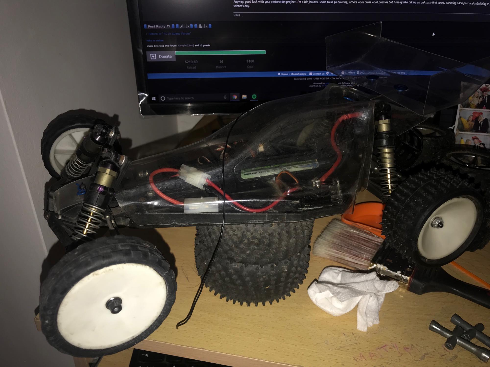

Hello everyone, I am looking for some help and advice in restoring my Dad's old RC-10 B3, it hasn't been running for years, but I believe with a new motor and electronics it will be working perfectly.
I was wondering if there are any other changes I should make to strengthen the car, I am looking into eventually going racing with it. I've researched about upgrading the hubs to fit modern wheels but thats really as much as I have seen. I have been a RC Car enthusiast for years and I have always wanted to revive this car, my Dad always said there was no point but i'd love to see it going again(especially considering I was the one that broke it years ago as a child :lol: )
Money is a bit of a problem on this build, but thats why I am looking into just buying parts when I can afford them, any help is much appreciated!
I have attached some photos of the car, hopefully it helps.
Posts: 16775
Has thanked: 35 times
Been thanked: 1263 times
Re: Restoring my RC-10 B3

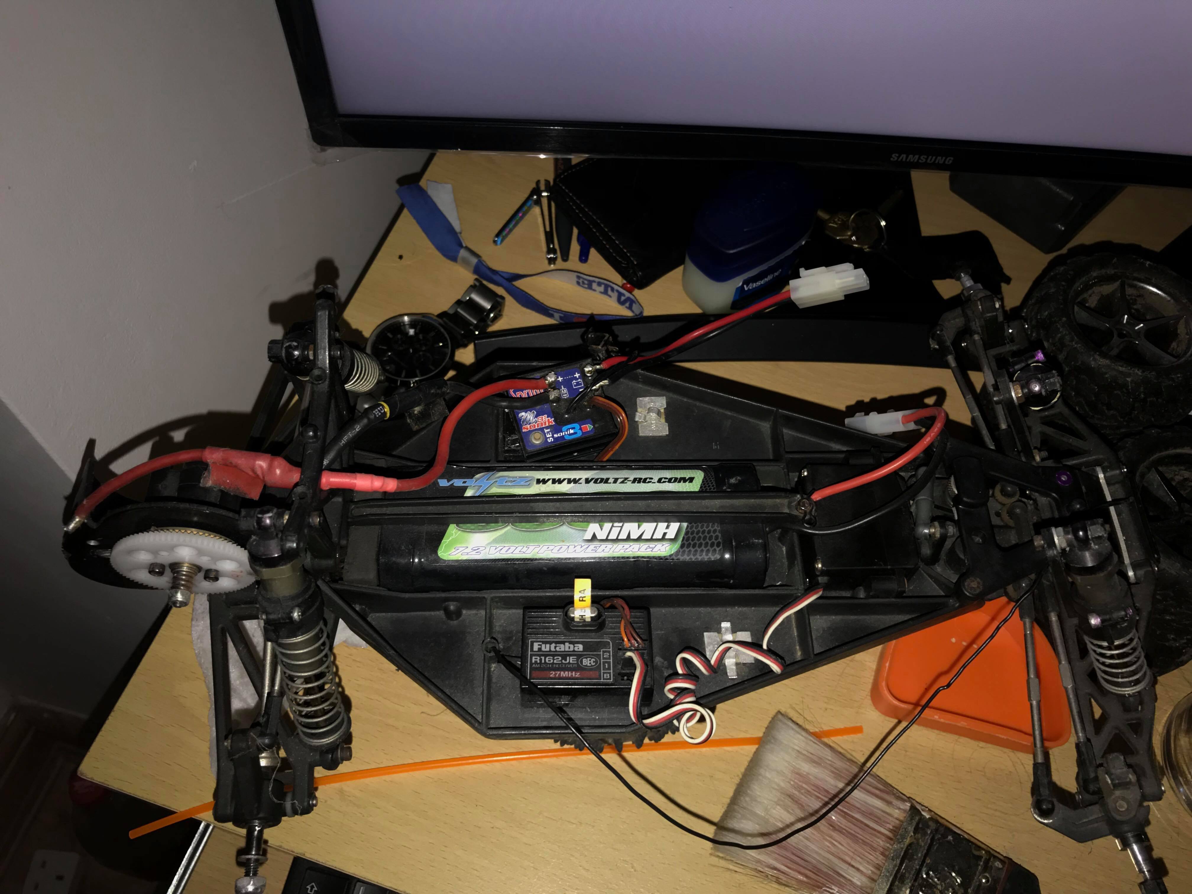

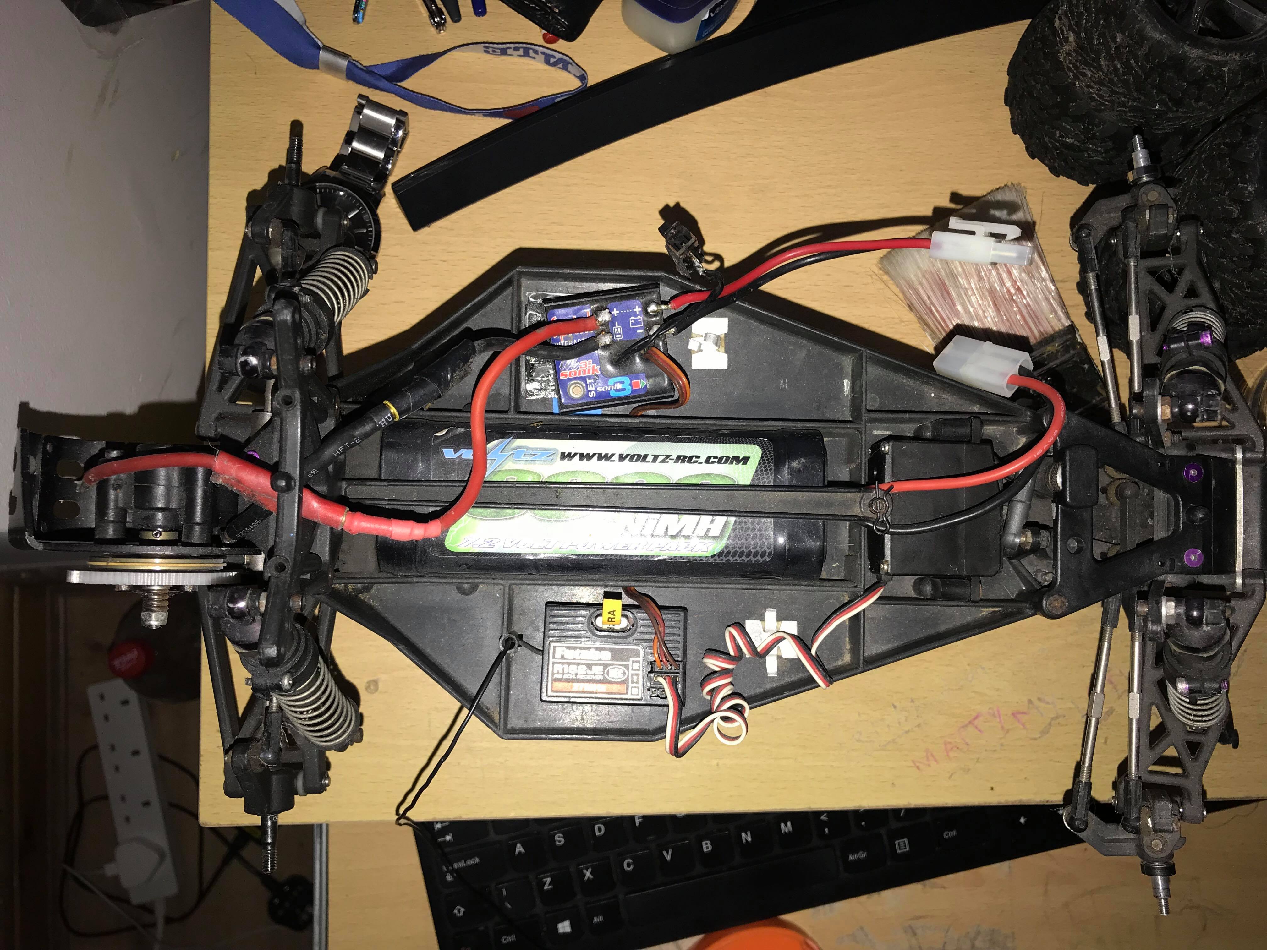

You actually have a B2, not a b3. While they look similar, there are more than a few differences.
If you are on a budget I would tear the car down and rebuild it the way it is. I'm sure it will work fine to nuts around with for now, the only thing i see is you are missing a motor (unless you have one and it's just not in the car). You can upgrade as money allows. But, rebuilt the shocks, trans, clean the bearing, etc and have fun with it for awhile.

scr8p wrote: Mon Jan 22, 2018 9:19 am You actually have a B2, not a b3. While they look similar, there are more than a few differences.
Sorry I actually thought it was a b3! I want to convert it to brushless and modernise/strengthen anything else worthwhile.

First thing you want to do is download the manual if you don't already have one.
https://www.teamassociated.com/cars_and_trucks/RC10B2/Team/manuals_setups/
One good thing, it looks like you already have 3/16" rear axles which will make using the modern 2.2 wheels and tires much easier. You will just have to pick up a pair of the wide GT front axles (asc7222) to run rc10b4 front wheels. Unfortunately, the axles are discontinued now, so the easiest way to get them is like this.

b2 b3 are identical for all practical purposes chassis wise. the arm lengths changed. look at the picture in the link, it's very apparent.
