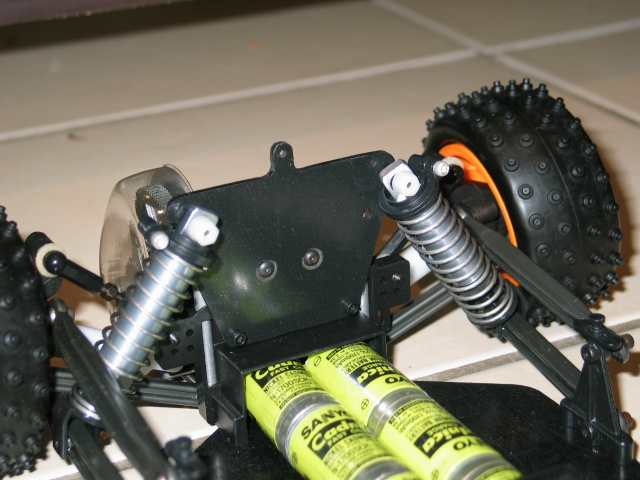

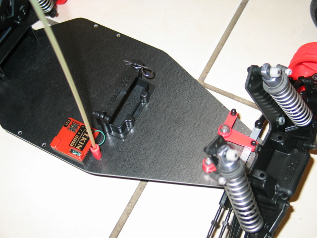

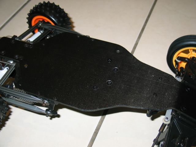

im curious about a few parts on my losi cars the chassis and rear shock tower on the jrx2 look after market and the chassis on the pro did they come out without a slot for the servo saver pics attached

The jrx-pro and jrx-T used the same shape/wheelbase chassis. The T originally came without the slot in the chassis for the servo saver. It was a running change. I thought it started when they came out with the pro, but it is possible that the early pros did not have the slot, however it is more likely that you have a truck chassis that was converted to a pro as the pro manual shows the slot, so I would expect them all to have it.
That jrx-2 is a very early one. The rear shock tower has no holes, the lower link has only 2 mount holes and does not have the vertical reinforcement rib. your upper links also appear to be the 4-rib variety instead of the 3. Your shocks also have the early, fragile, spring clamps. I have seen some of the chassis plates that seem to have more of a pattern/texture to them, so I do not think that it is aftermarket, just early production.

The original JRX-2 bellcrank Incorporated a vertical piece of plastic that would flex as a servo saver. This proved to be an inadequate solution so Losi popped a top plate on it taking out the servo saver action (like on your Pro). People were then forced to use the small Kimbrough servo saver to protect their servos, but if you look at the length of the bell crank arm you will soon see that the small Kimbrough servo saver would not have the throw to move the front wheels to their maximums. The choice left to the owner was drill the chassis for servo mounts and raise the servo off the chassis plate, or cut a window for the big servo save to hang through. Eventually Losi incorporated this into the design.

I purchased one of the JR-X2 Pro Formance kits when they first came out. About a week later, I purchased a jrxt. Both chassis did not have the slot. The slot became standard when the jrx pro was introduced because that kit required the use of an after market servo saver. The flexible saver/bellcrank was replaced by the red non-flexible bell crank.
I agree that the shock tower was from an early jrx2. My buddy received one of the first kits and his had the solid rear shock tower (no holes), aluminum yoke spacer, tiny thrust bearing, light orange wheels, non jrx2 stamped motor plate and the non-jrx2 body.

I have sold a number of these early chassis and still have a few left. The are NIB and perfect. The headers read JRX2 and also have the notation for Car/truck.
The Pro-formance upgrade kit was released with the chassis having no slots what so ever in the chassis. I also distinctly remember the first Pro kits to hit the country here in Australia not having the slot in the chassis either. It was only a few months later when the second lot of kits arrived here that the slot was in the chassis. I remember using my trusty ARLEC (Cheap dremel) to remove material from the non slotted chassis on my Pro so that the big Kimbrough could be used. I just removed enough material for it to not hit - kind of like countersinking.
Either way Gary - that car of yours looks super slick! Your car is pretty much period correct with the exception of the rear shock tower - but you have been told that already.

The rear shock tower is stock, someone's just used the wrong screws to install it.

The reason for the "slot" in the chassis, I was to blame, was to make room for a larger servo saver. Back then the servos on the market weren't the greatest, and to make the truck work (and get the wheels to turn on command) most of us generally ran a huge kimrough servosaver to enable our servos to have a long enough throw. And to fit the servosaver without it rubbing the chassis we had to cut a slot. These weren't done on all production pieces, but some of them - and usually just the jrx-t, but some slipped through on the pro's (I know I used one).
All of the losi factory carbon fiber chassis plates were smooth, with no texture or visible pattern. If you have a plate with a texture or pattern it's likely an aftermarket model, as there were several companies in the chassis plate biz back then (composite craft for one).
