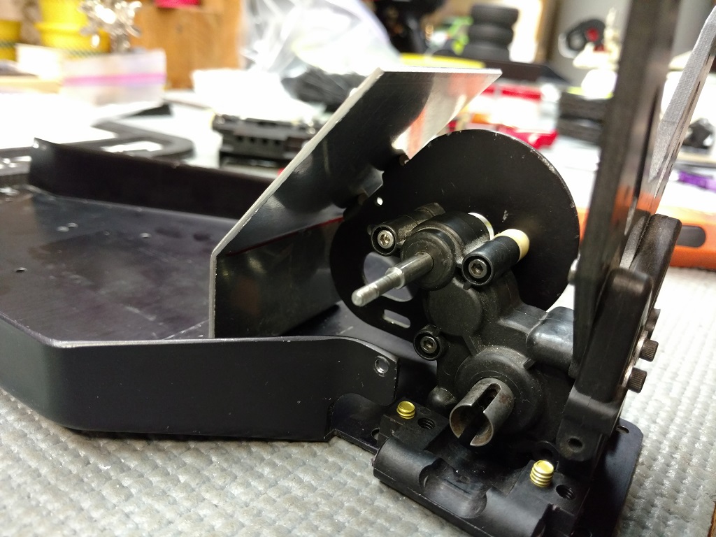

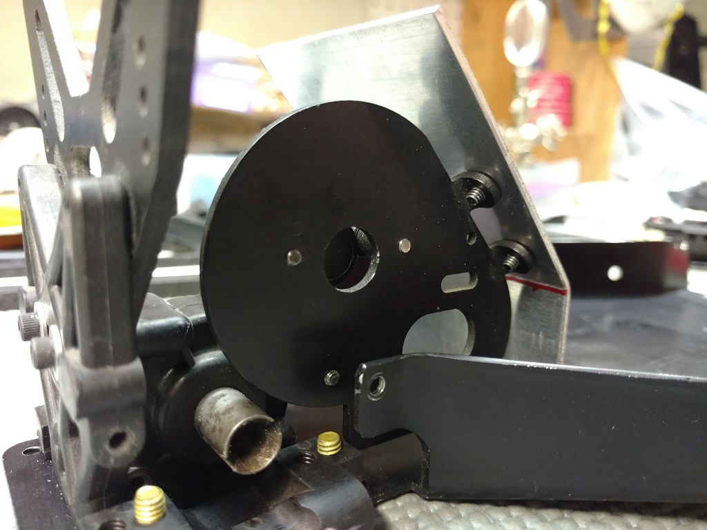

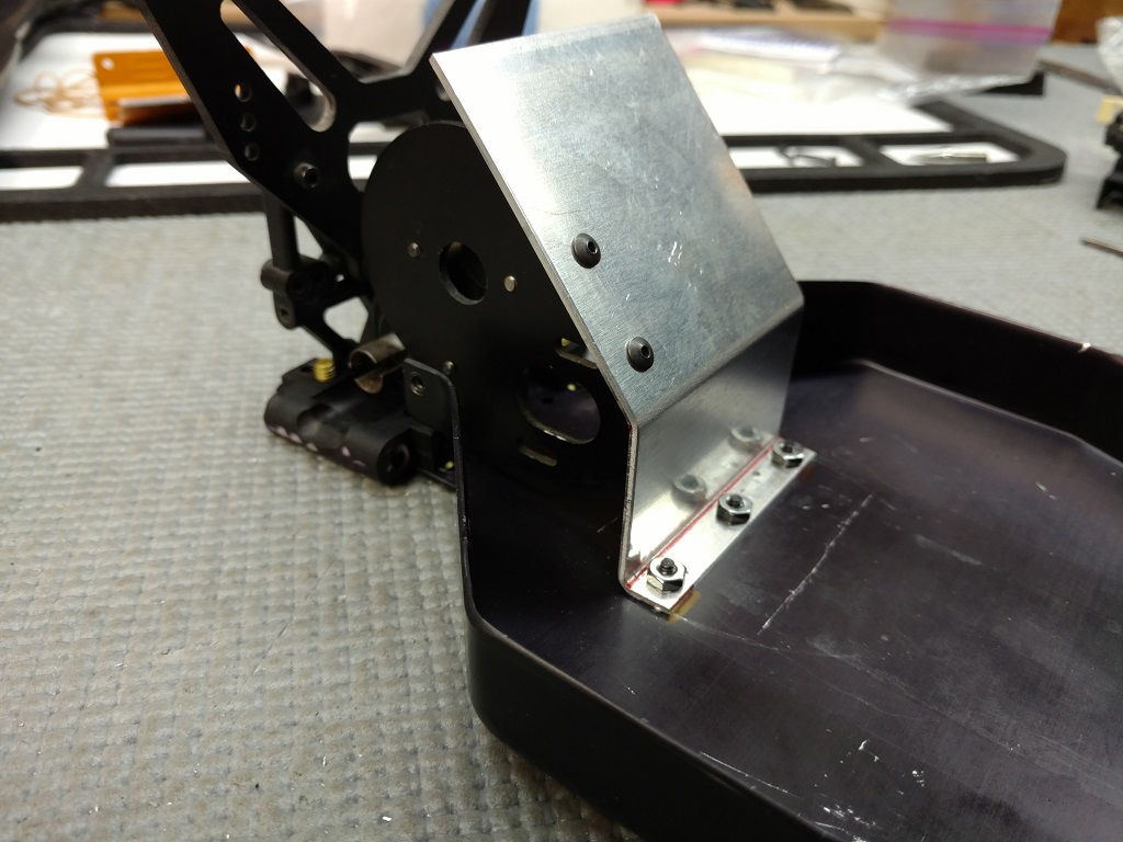

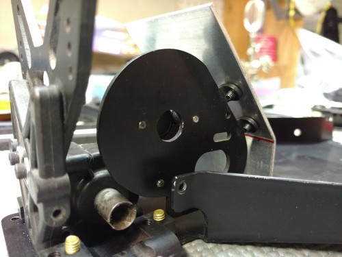

Fabbed up a brace for the new B1.5.1+5M tub. :lol: I still have to trim it down and give it some shape, but it's attached to the tub and motor plate and the rear feels pretty solid.
Posts: 16836
Been thanked: 1335 times
Re: RC10 B1.5 - #5

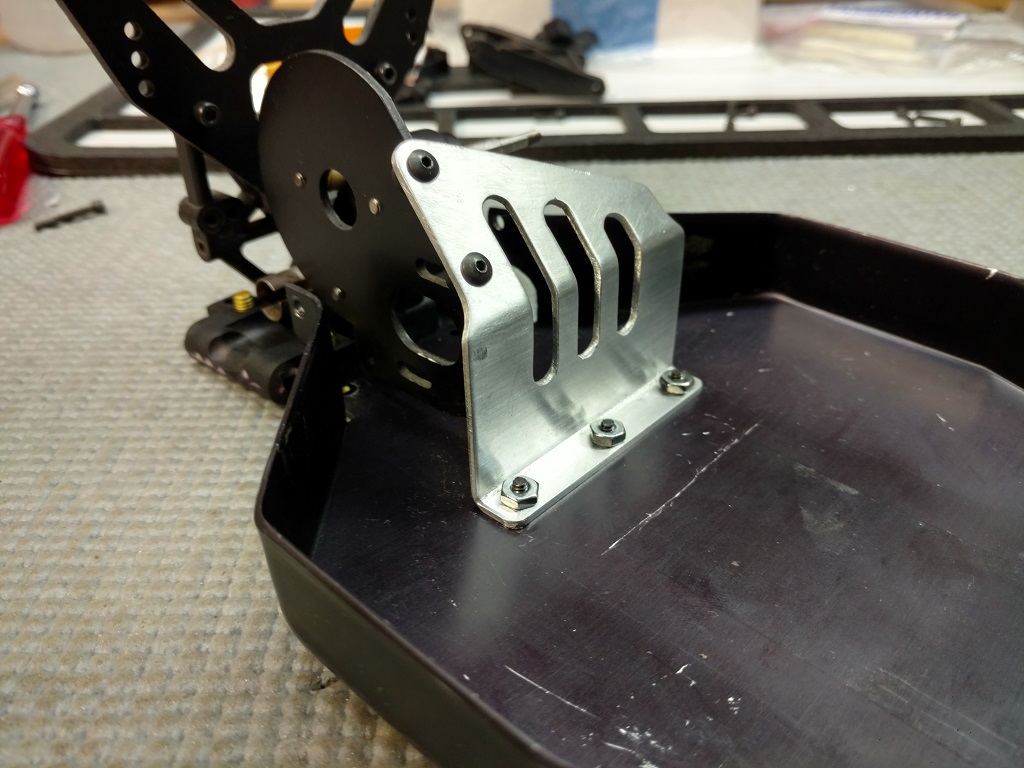

Alright, the brace is done. It's wider than the stock T2 motor guard, but I tried to mimic the shape. and added a few slots too.

Looks good. What did you have to do on the pan for the trans/bulkhead?
Posts: 16836
Re: RC10 B1.5 - #5
The trans and bulkhead were easy. Just made a template, spun it around and drilled the new holes.
the part that sucked was having to add 2 new arm mount holes to the tub. You can't move the mount front and back on the T2 tub like the rc10. Because the hub carrier is set back on the arm in relation to the mount, the mount needs to move back on the tub in a mid motor setup. So it requires a new hole behind the front arm mount hole so the mount can be moved back. I used a stealth trans drill template to do that. But I boogered the one hole up when countersinking it, so I hope it doesn't cause me problem. I may have it welded up so i can redo it.

That sucks about the countersink.

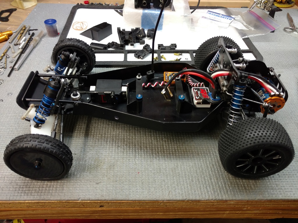

Before:

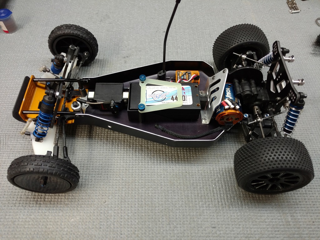

And after:
klavy69
Moderator
Posts: 5207
Has thanked: 640 times
Been thanked: 294 times
Re: RC10 B1.5 - #5
Post by klavy69 »
just a tad different from before to after :shock:
Looks great though. Finally have a nice runner...congrats :P

I like the "after" servo turnbuckle :D

RC10th wrote: Mon Mar 05, 2018 7:39 am I like the "after" servo turnbuckle :D
Yeah, it's temporary. In trying to push the servo so far forward the bellcrank arm hit it. So I had to move it back, but the battery box was in the way to move it back more. With the ball stud being so low on the bellcrank a straight one hit the servo when turning. So eventually it'll end up with a rere worlds bellcrank with the taller servo arm. Then a straight one can go back on it.
Posts: 16836
Re: RC10 B1.5 - #5
Or, I need to get a lower profile servo for it and push it to the right side.

It's a bit bent like its owner :lol:
The worlds steering is a good move, from your photo it looks like there is plenty of clearance, have you tried a long ball stud with a thick downstop spacer?
I vote for blue ano to pay tribute to Pavidis's T2
