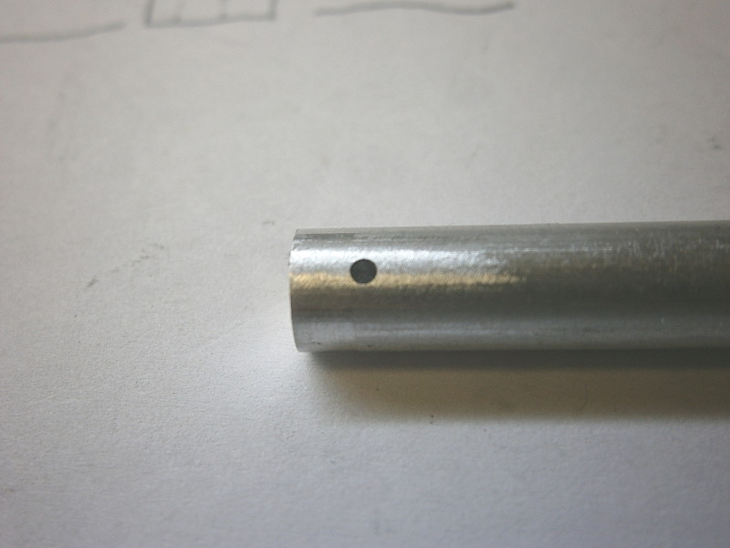

Time to bring "small things" back to life. :D
I'm needing a pair of short, 1/4" dia., 4-40 threaded body posts for a current build.
I started out with a piece of 1/4" 1061-T6 aluminum rod. After facing the end off I measure up where I want the hole to be and drill a 1/16" dia. hole. Stay tuned, more to come in the next 24 hours!

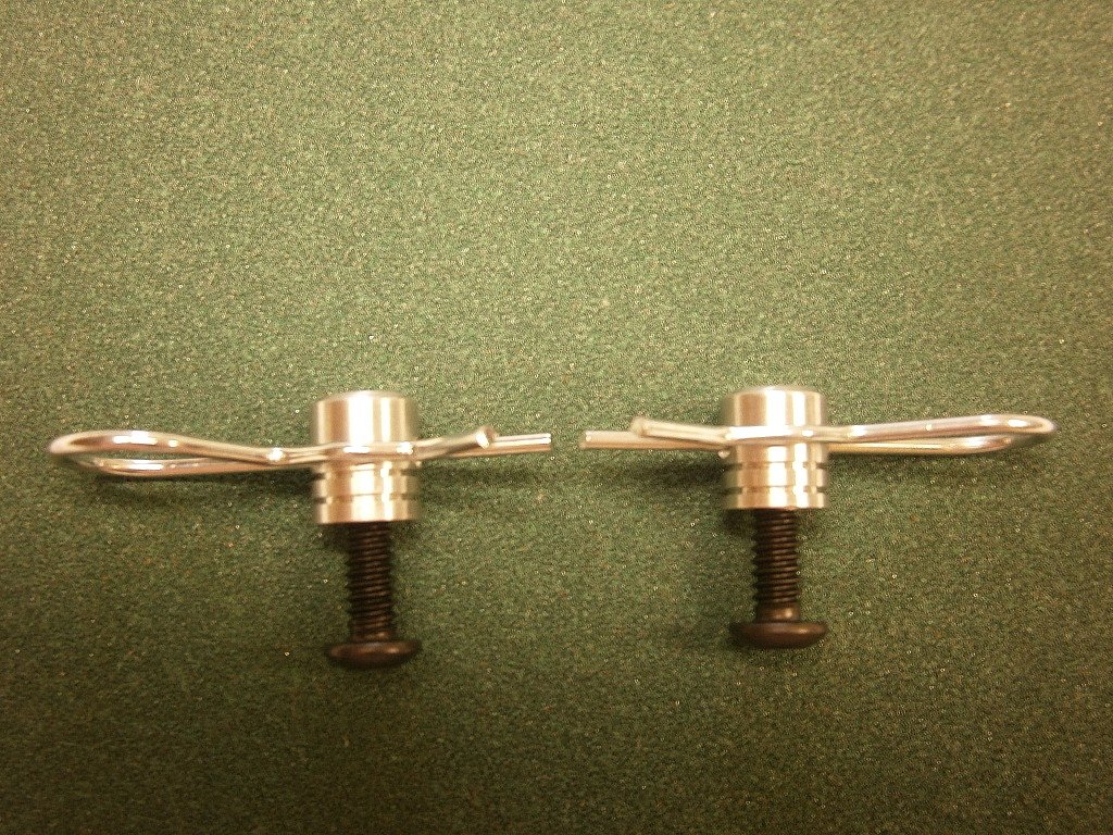

NomadRacer
Posts: 1467
Has thanked: 81 times
Been thanked: 79 times
Re: NomadRacer's Small Things
Post by NomadRacer »
This is what I came up with this morning, may adjust, may not, depends on how the day goes! Maybe @lavigna will stop by for a look.
Bum on Direct Deposit

NomadRacer wrote: Sat Mar 10, 2018 9:50 am This is what I came up with this morning, may adjust, may not, depends on how the day goes! Maybe @lavigna will stop by for a look.
What do you use for a grooving tool?
NomadRacer
Posts: 1467
Rc-Archer wrote: Mon Mar 12, 2018 6:54 pm What do you use for a grooving tool?
Those are .015" width x .060" deep grooves in the spacer. I use an A.R. Warner brand grooving and cut off tool. It has high speed steel inserts in three widths, .015", .031" and .062". Each insert has two cutting edges so when one end gets dull, flip it around! The set comes with one insert holder, all three inserts sizes, two spare insert screws and a T-9 wrench, all in a foam padded plastic case. The set goes for about $105.00 plus shipping. This is where I got mine: https://littlemachineshop.com/products/product_view.php?ProductID=3572&category=202639332
For ease of use I have three sets on quick change tool holders. I cut grooves in Delrin, Brass, Aluminum, Steel, and yes, even Titanium.
