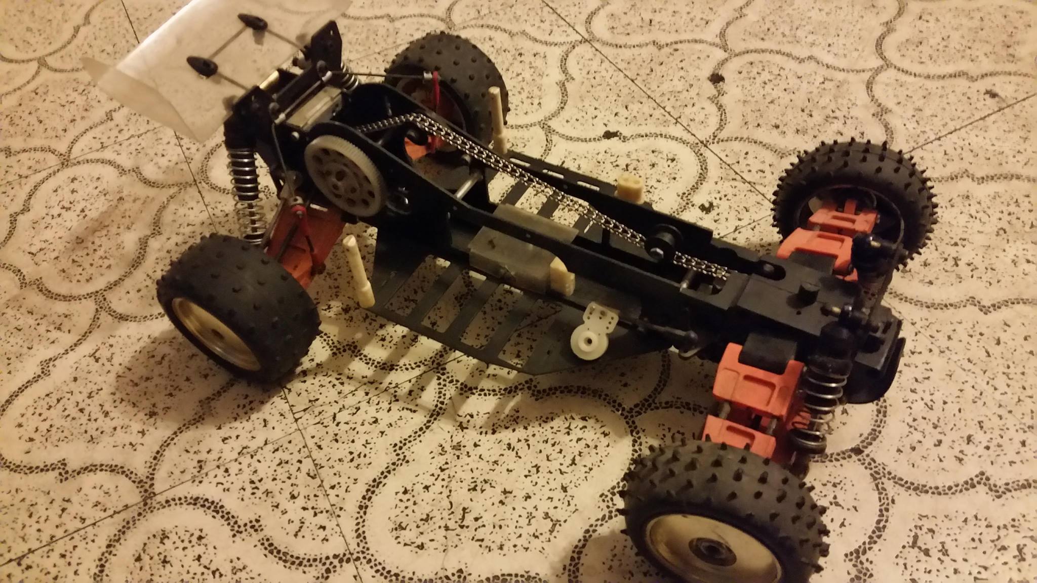

Re: Sacrilege build - AYK Pro Radiant RACER

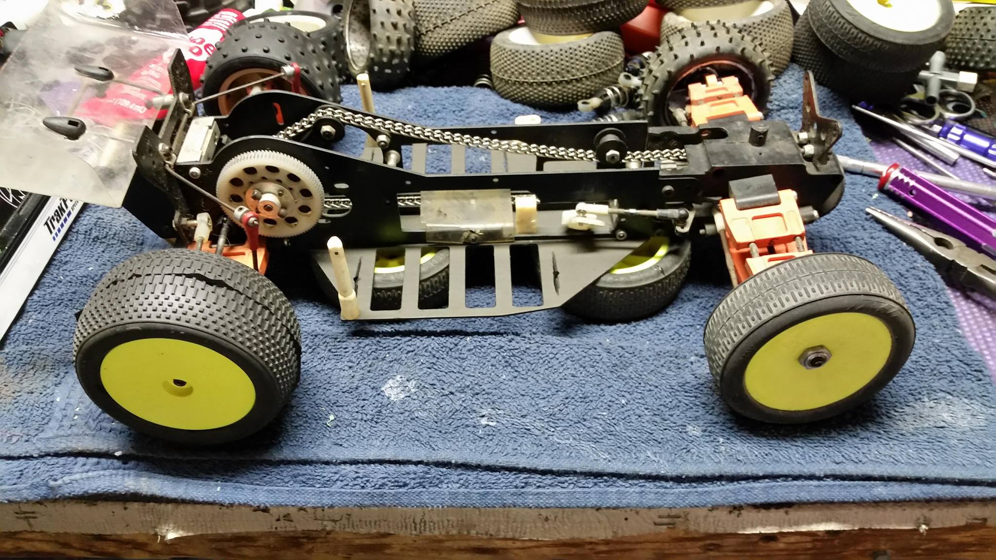

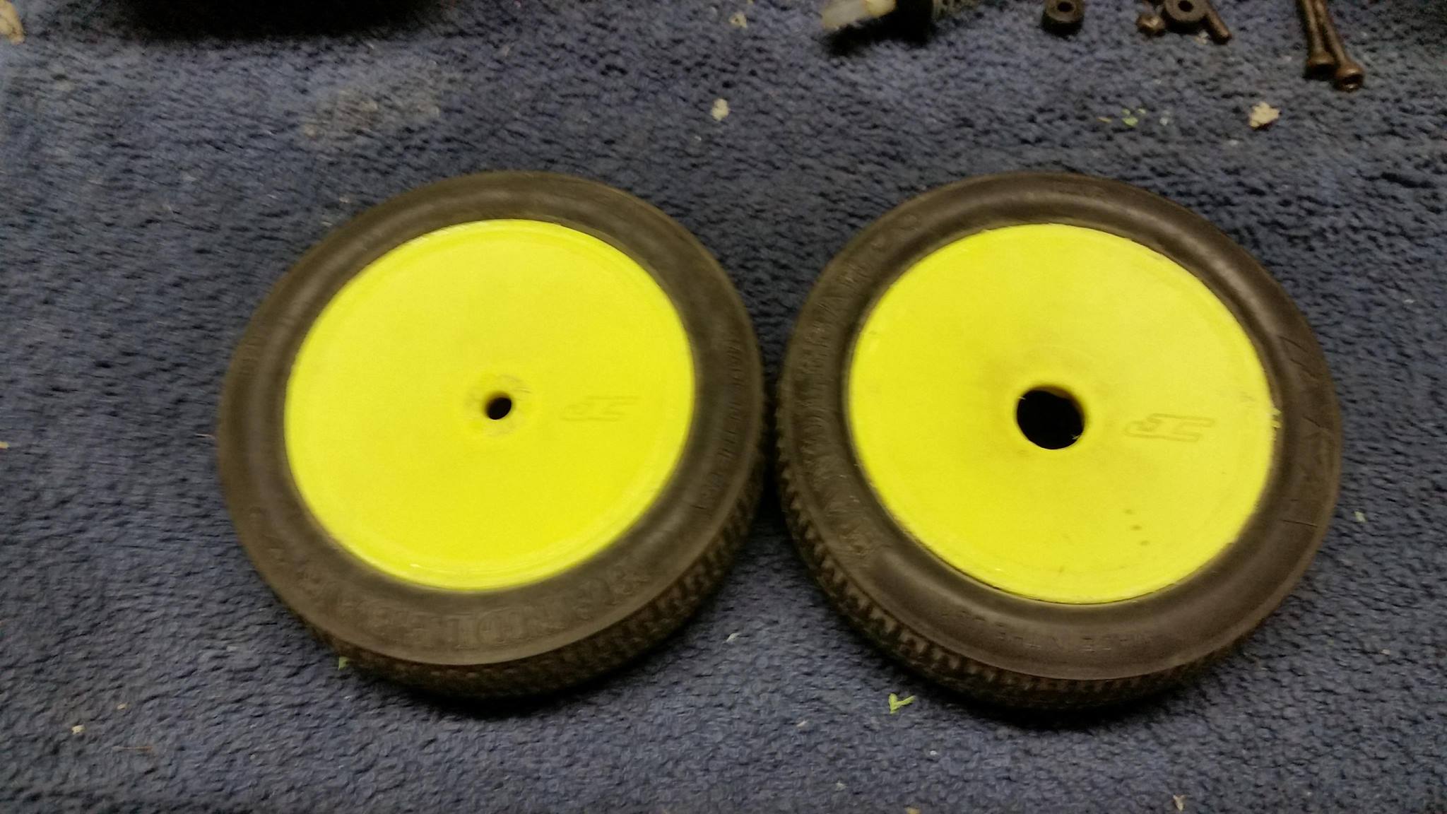

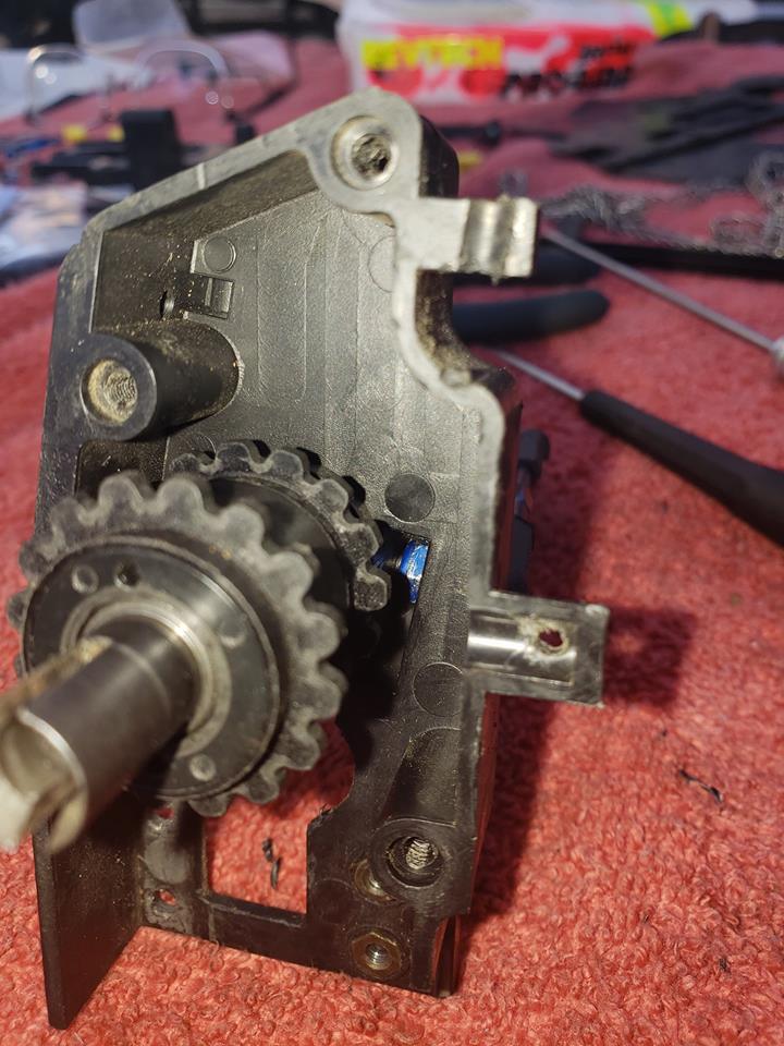

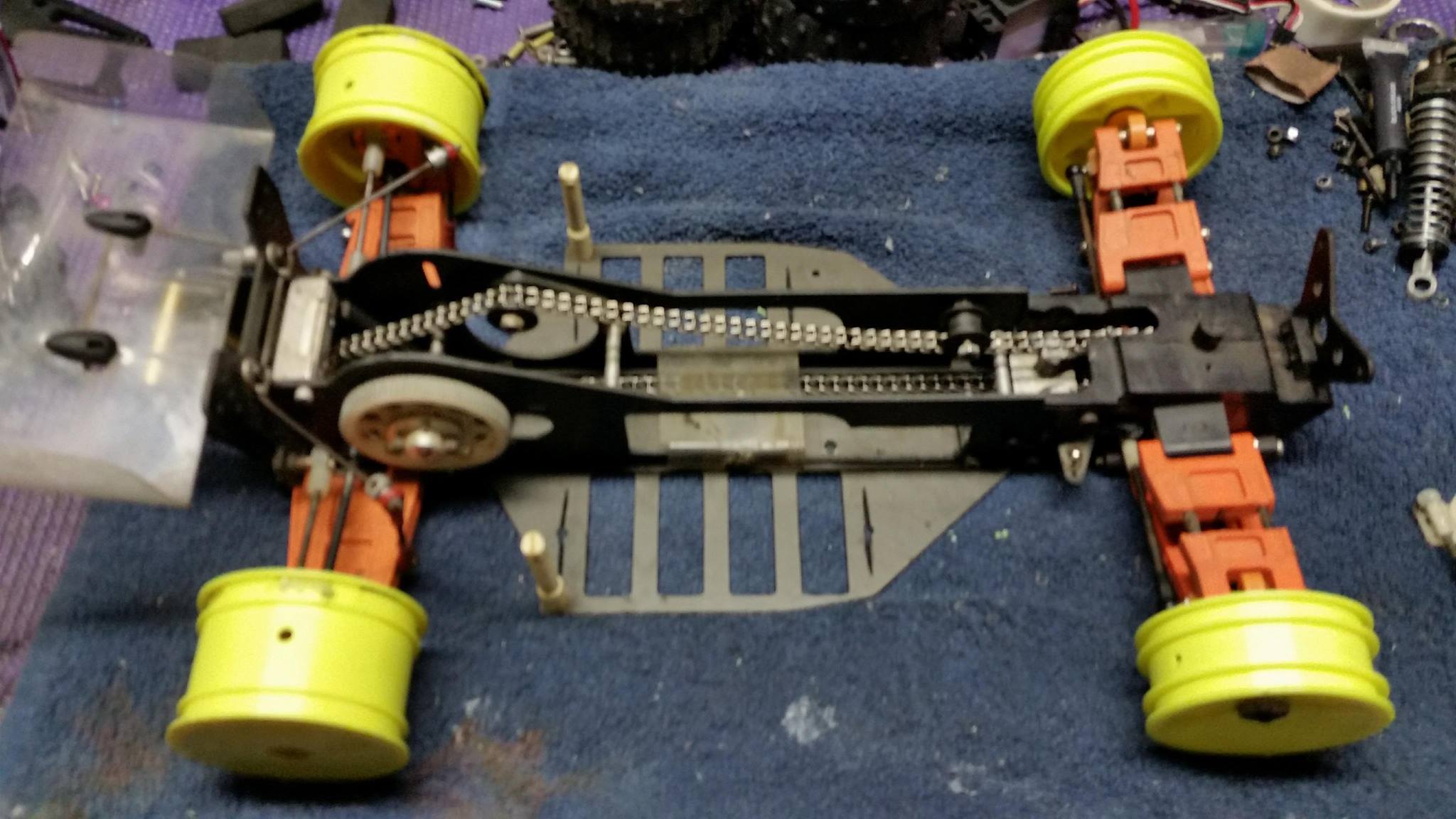

At first, I wasnt going to do the arm swap "mod" - so I had found a way to run modern wheels on the stock arms & driveshafts. Pretty easy overall, 4mm thick rear hex & drilled out a set of 2wd AE 12mm hex wheels to fit over the stock one ways.

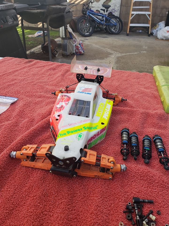

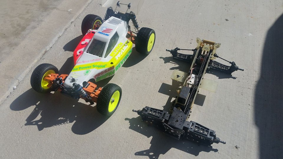

But then, as luck would have it - I was able to get a 2nd Radiant - notice I did not say Pro
this happened to be (per Steve Dunn via Facebook) and early conversion car from Radiant to a mid motor "Pro" car. So my focus changed to swap arms on this one, keeping the killer orange arms aside for a resto of the early car.

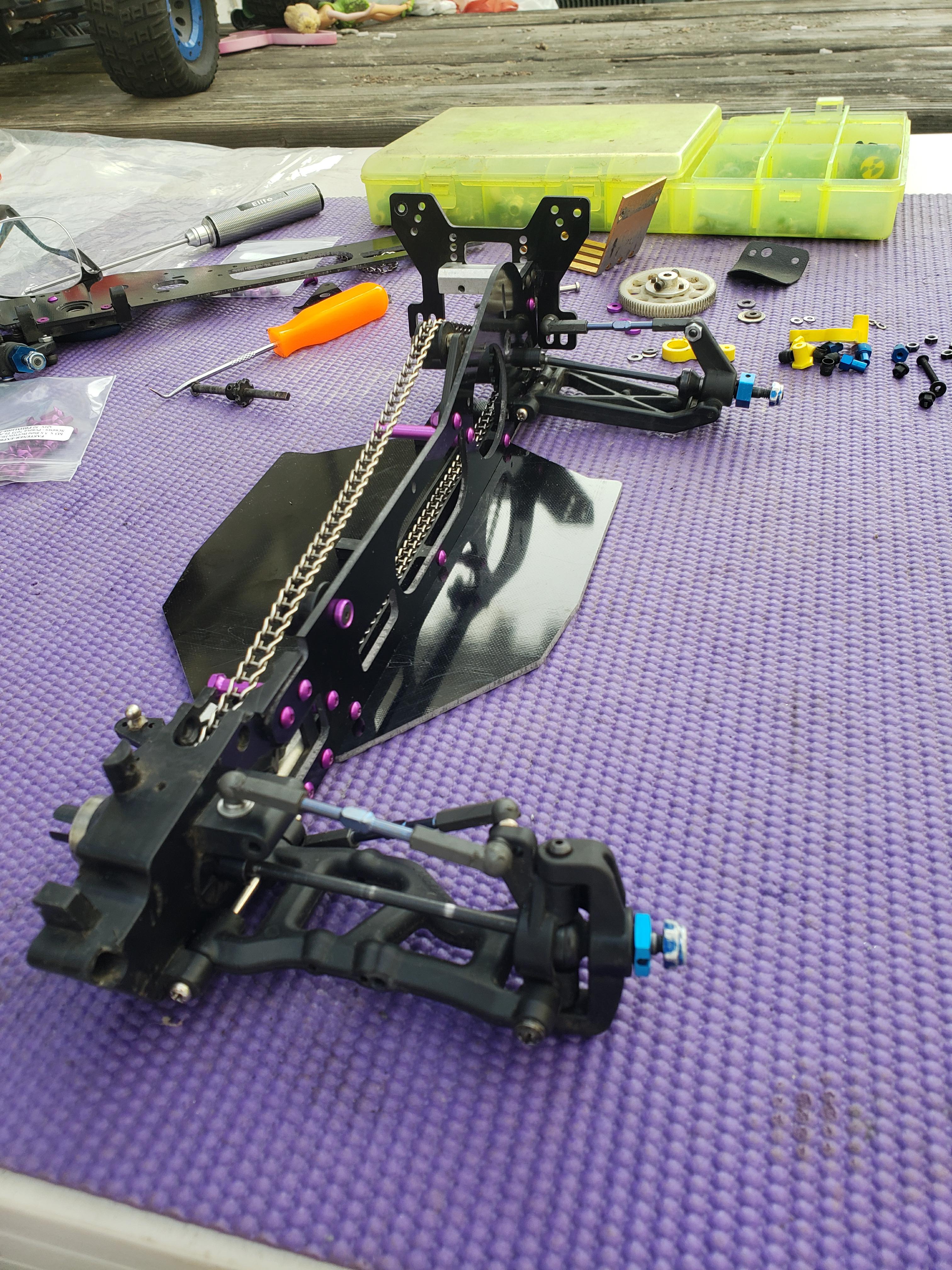

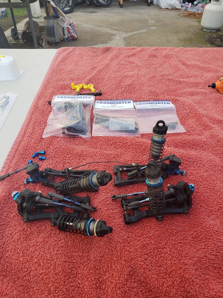

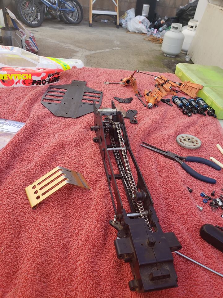

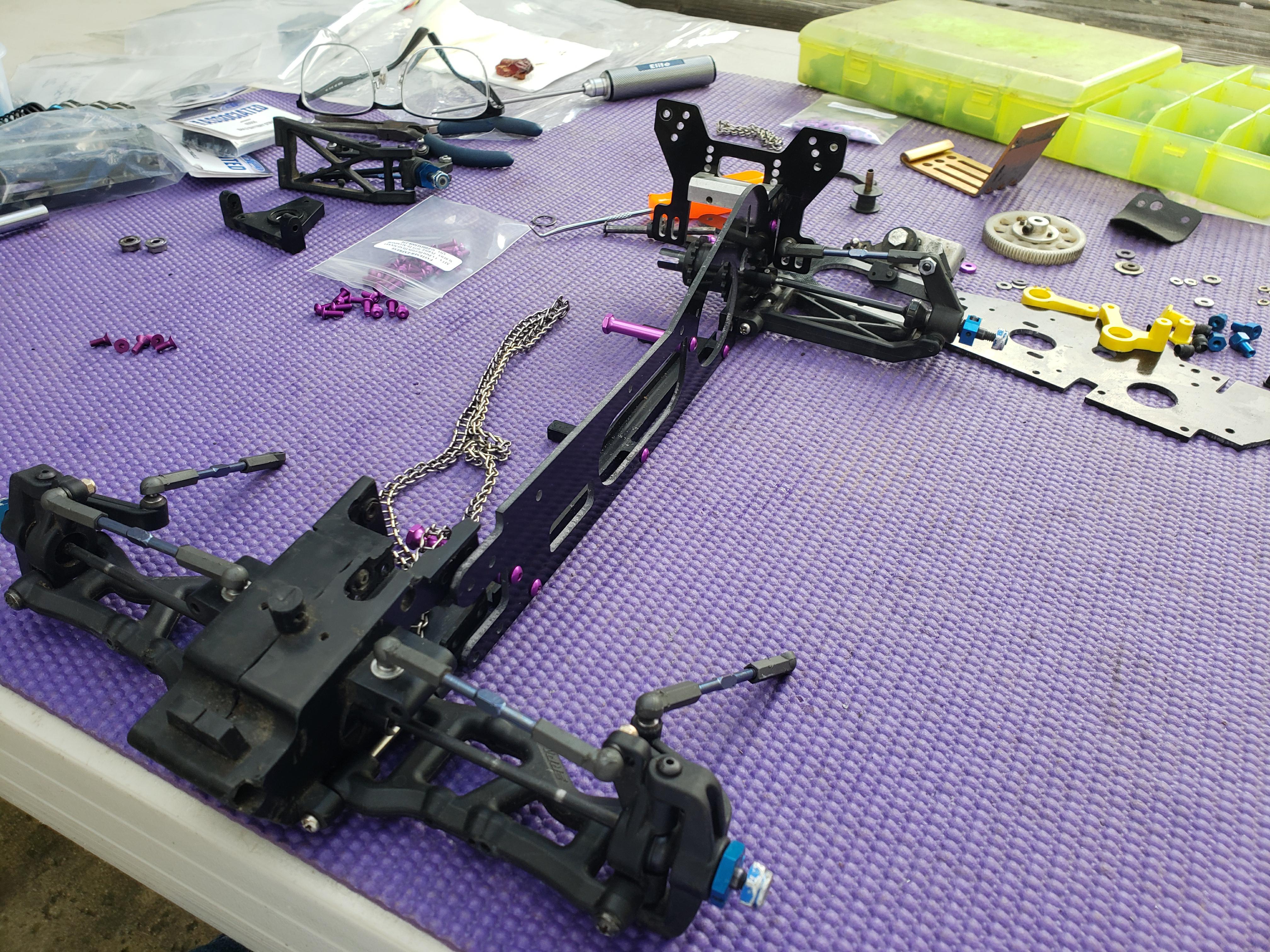

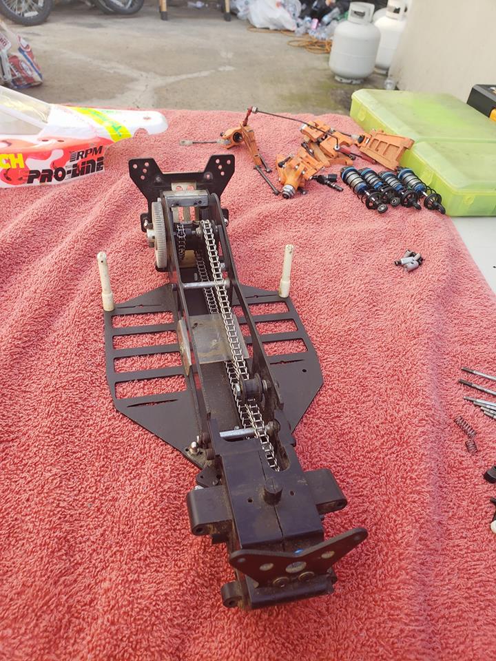

So...onto the build up. I was able to pick up a B44.3 car for a song. It was beat up and quite dirty, but I really only wanted the shocks and suspension, so it was a perfect candidate. No pics of it, I stripped it quickly.
First up - tearing down the car and starting to test fit the parts.

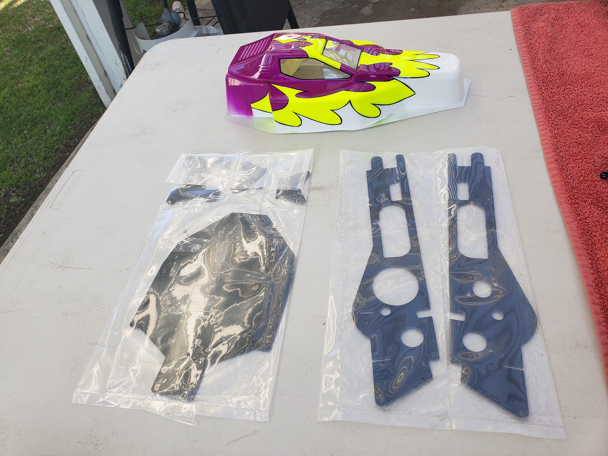

Ahhh, those beautiful chassis parts from Factory Works - he does awesome work. Not to mention the killer paint from my buddy over at BrainDeadDesigns.

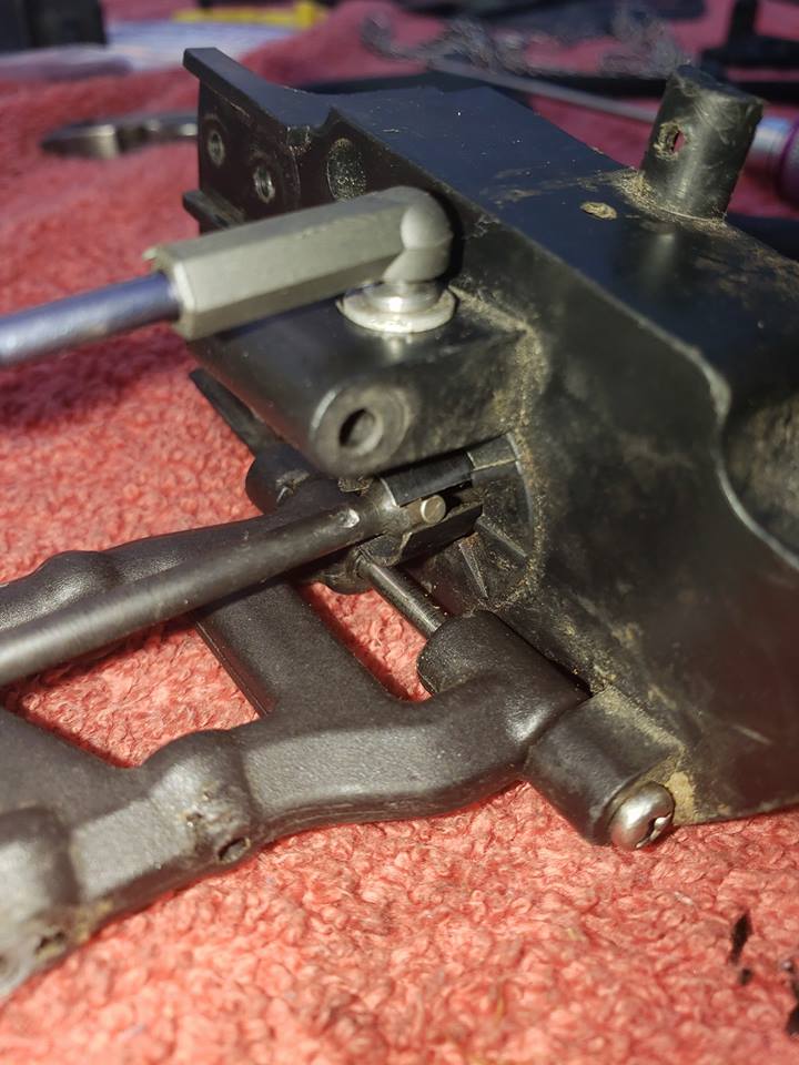

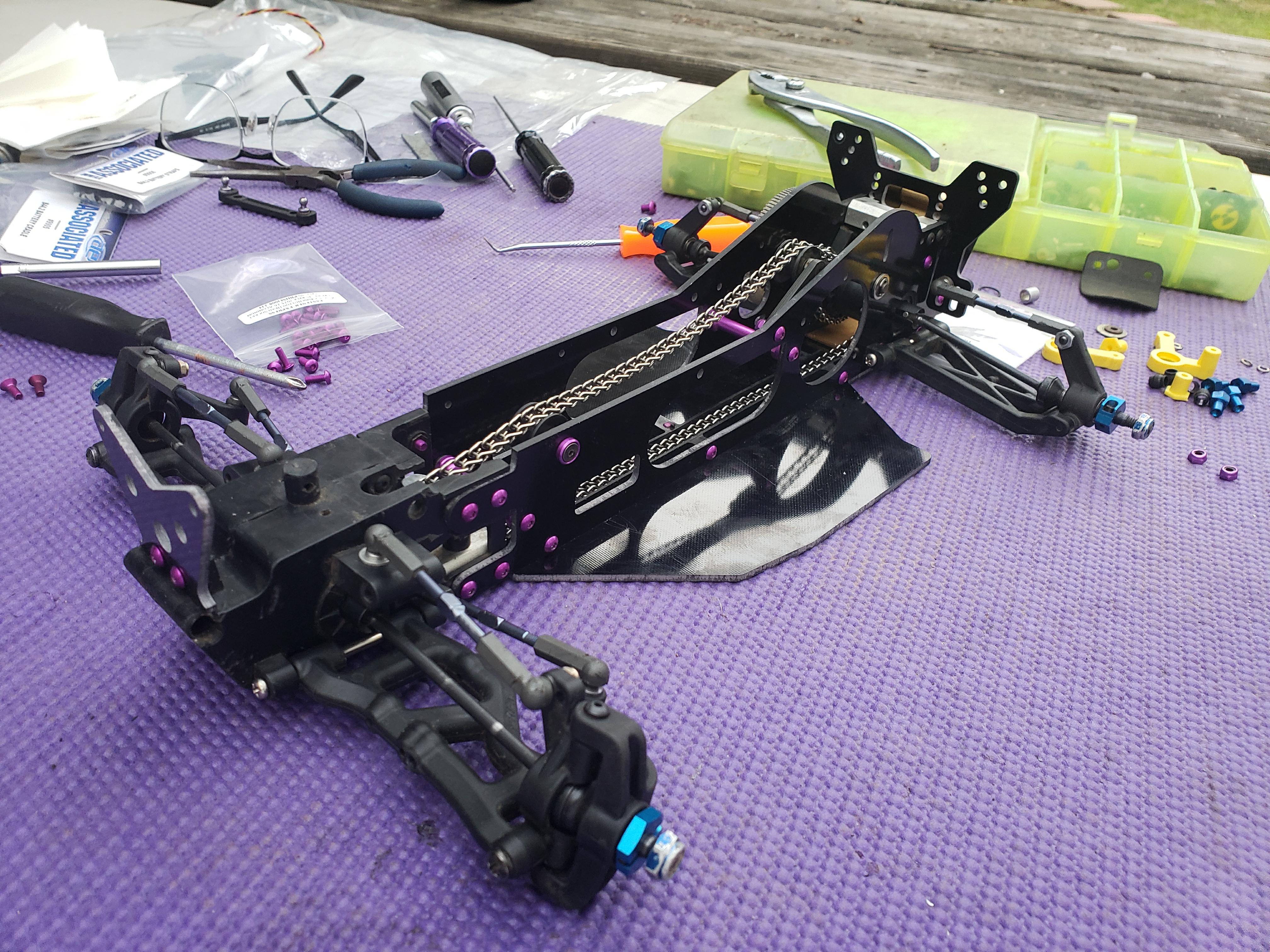

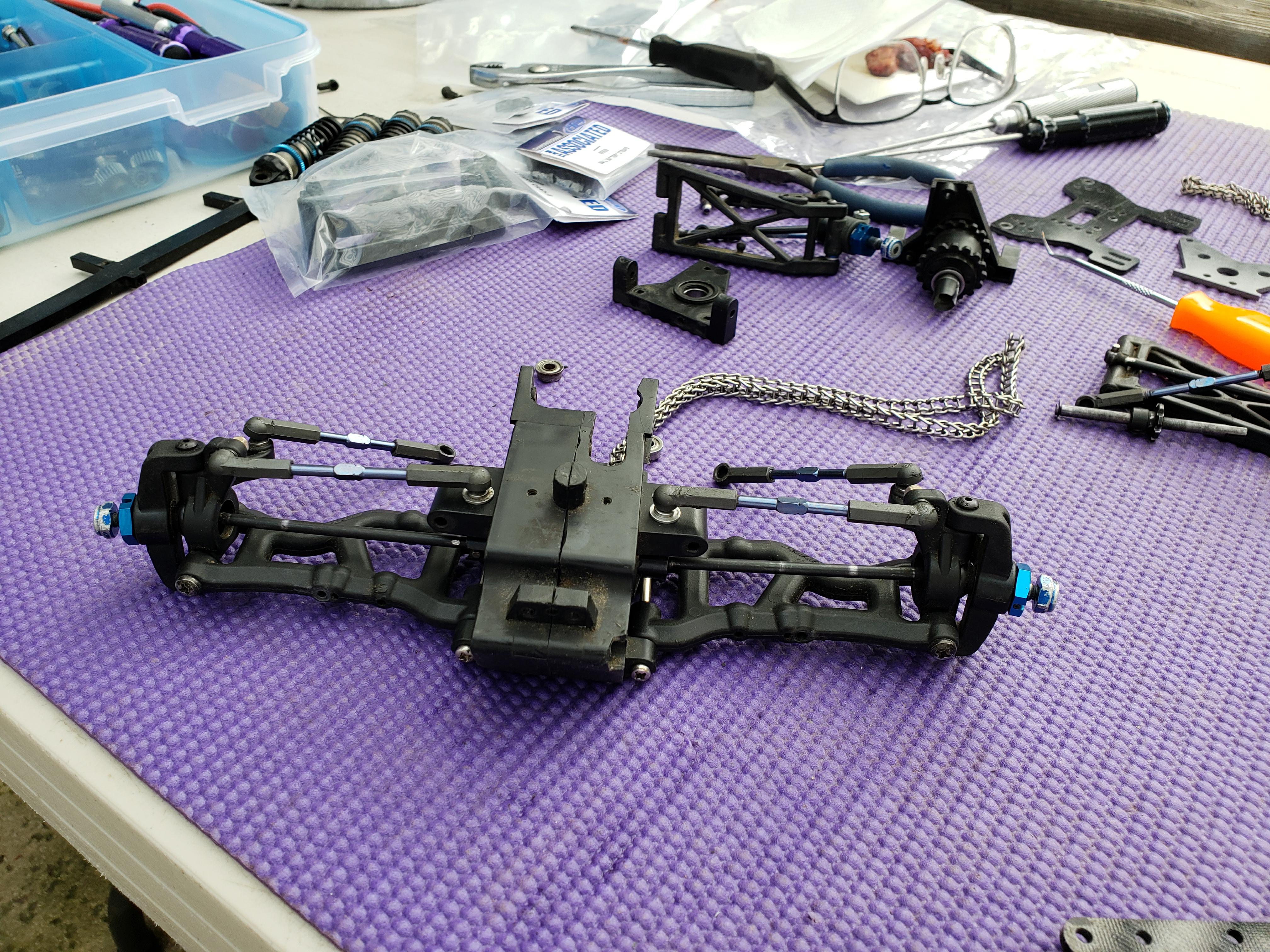

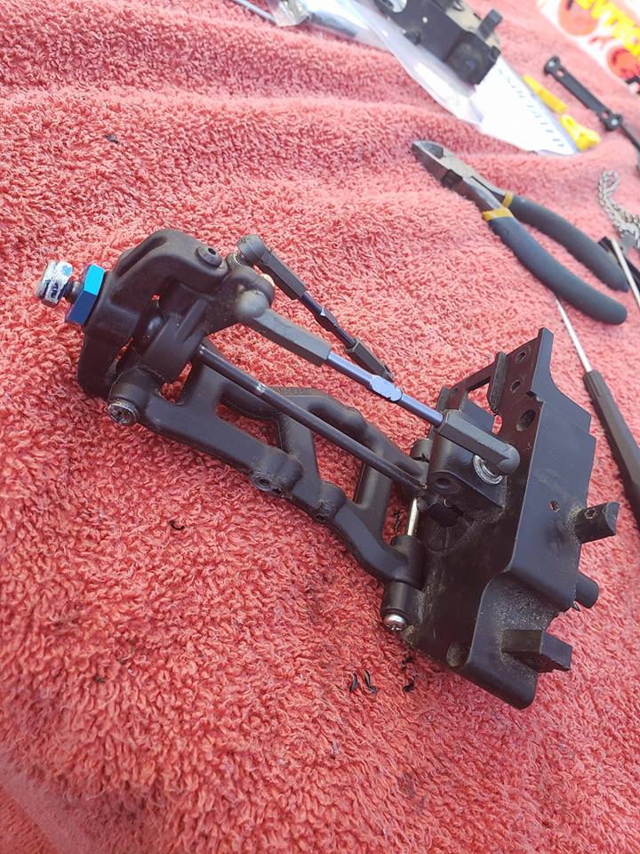

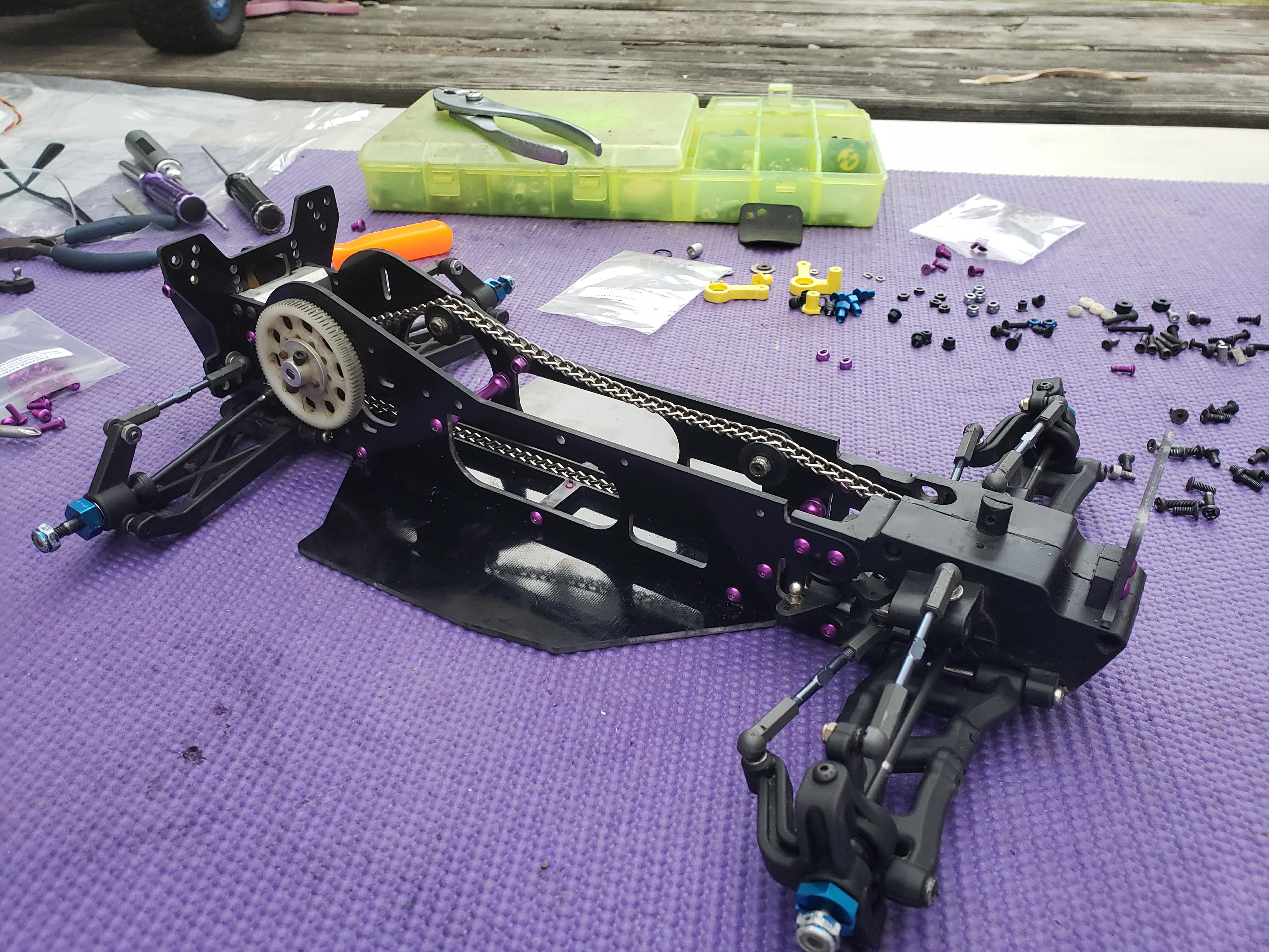

First thing, arms & front upper camber links...
I used a thin 4-40 nut inside the upper arm mount to secure the ball stud. Only modification I did to the original parts was drill that hole for the ball stud. All modifications can be reversed (to the AYK parts) - but all AE arms were drilled out for the stock AYK hinge pins - that cannot be undone.

I didnt seem to take a good close up on the rear arms, but you will need a spacer (I put it in front of the arms), as they are a touch narrower than the arm mounts in the rear. The fronts are nearly perfect.

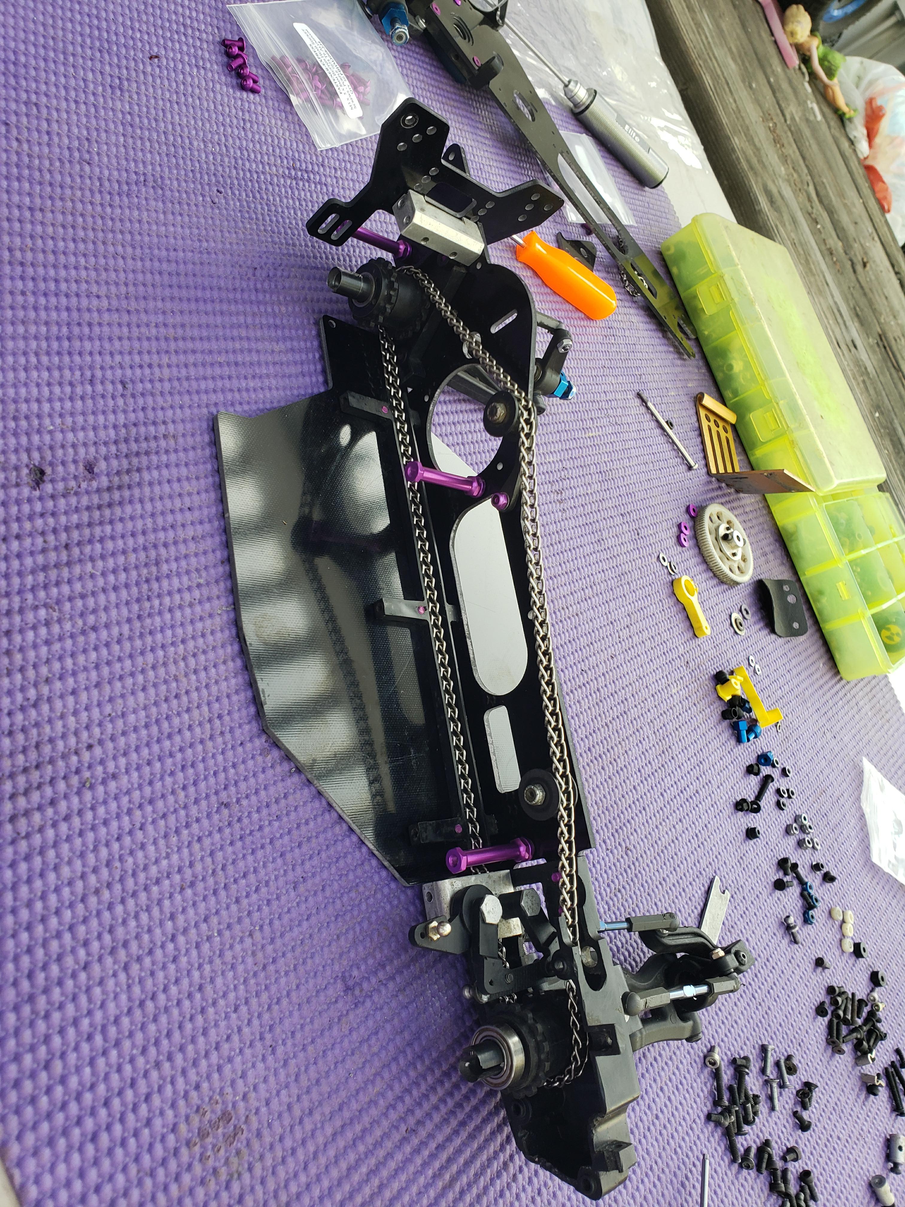

I tried to stop and take pics as I was building, but they were usually an afterthought
More....yes, I need to re-route the chain properly.

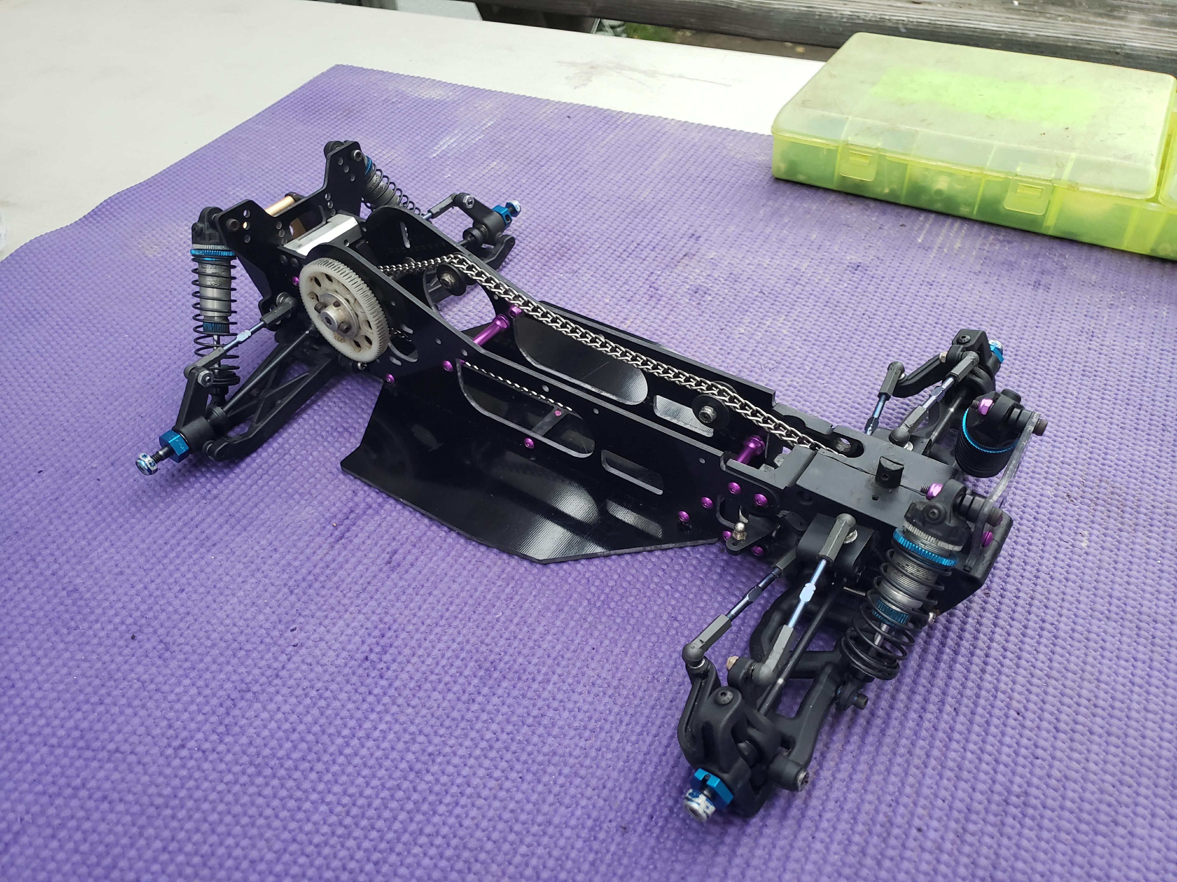

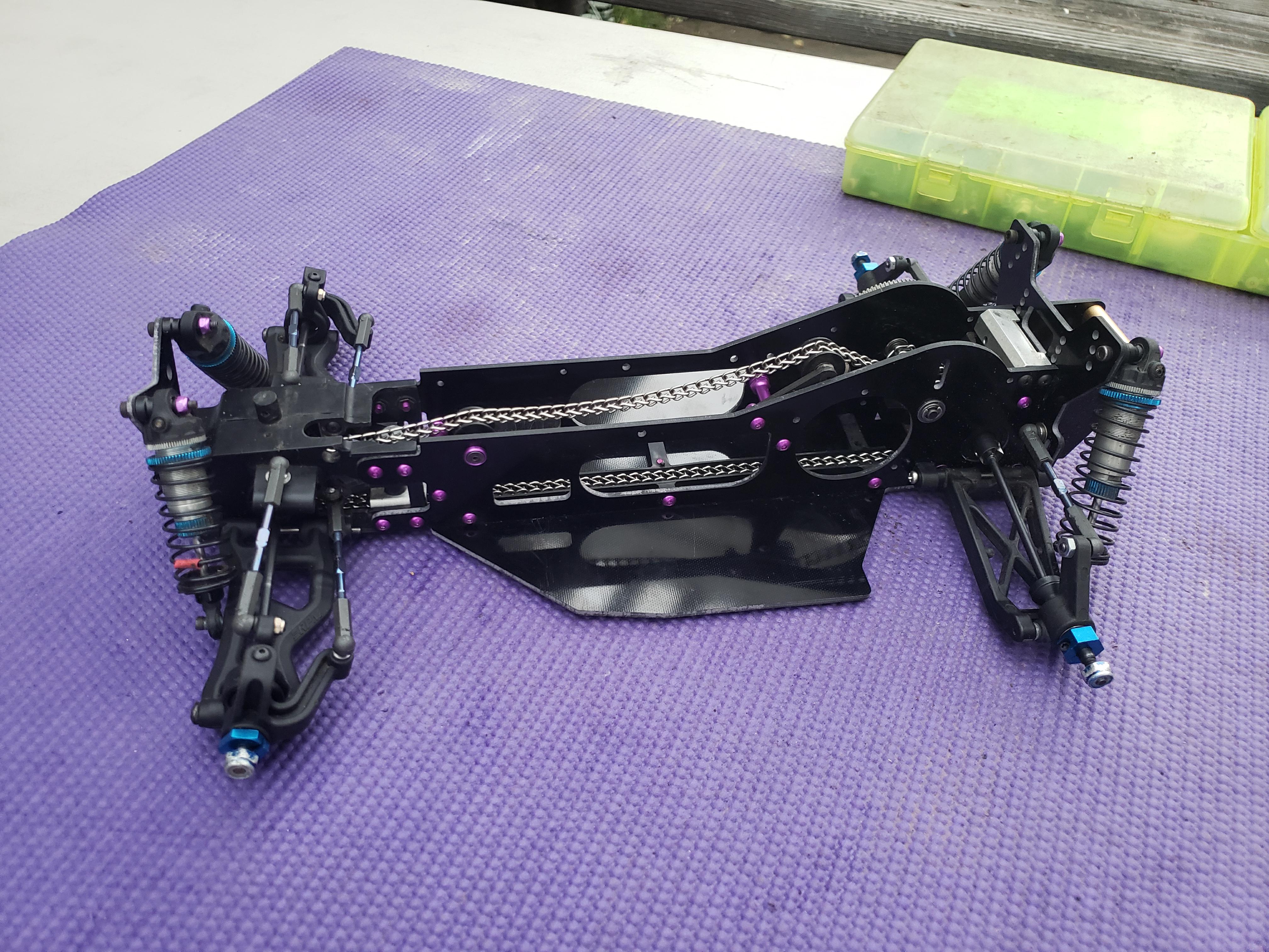

As it sits now - I need to dig out a set of wheels/tires to mount up, and B5M wing mounts. Then electronics & trim & mount the body.
I do have B44.2 saddle pack trays that I need to measure up and mount as well. They arent pictured yet.
