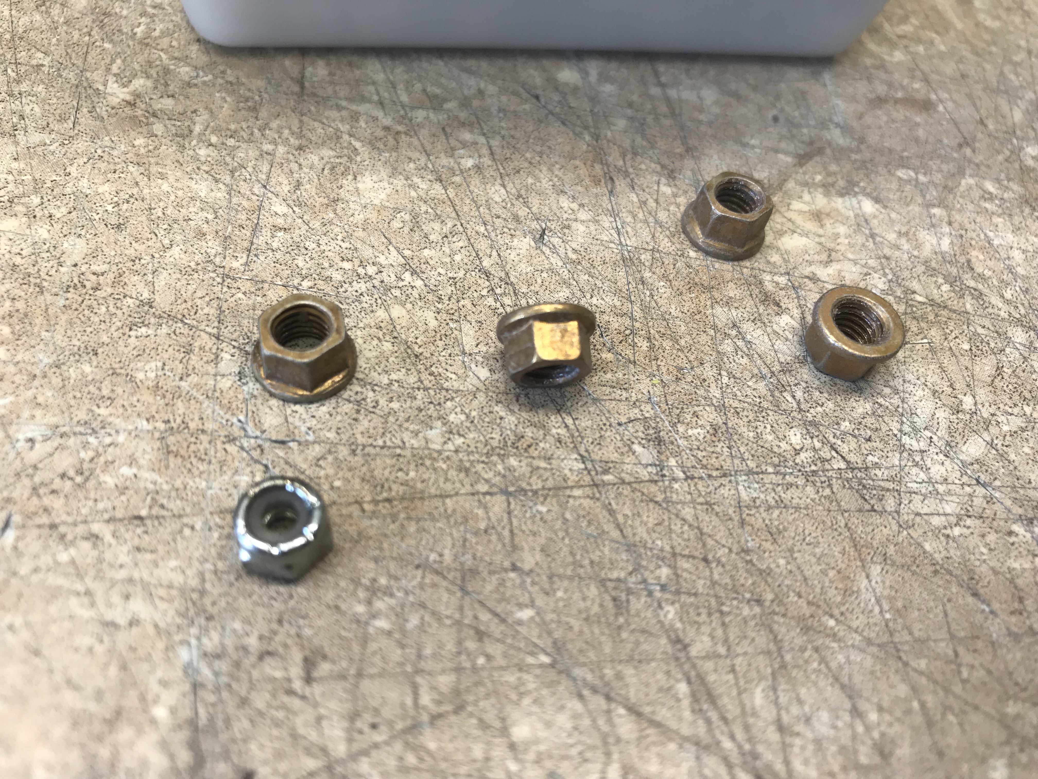

Our wheels needed these self locking aircraft style nuts when used with losi. They are kind of hard on the aluminum front axle
Pic shows them along with a 4-40 standard locknut for comparison
