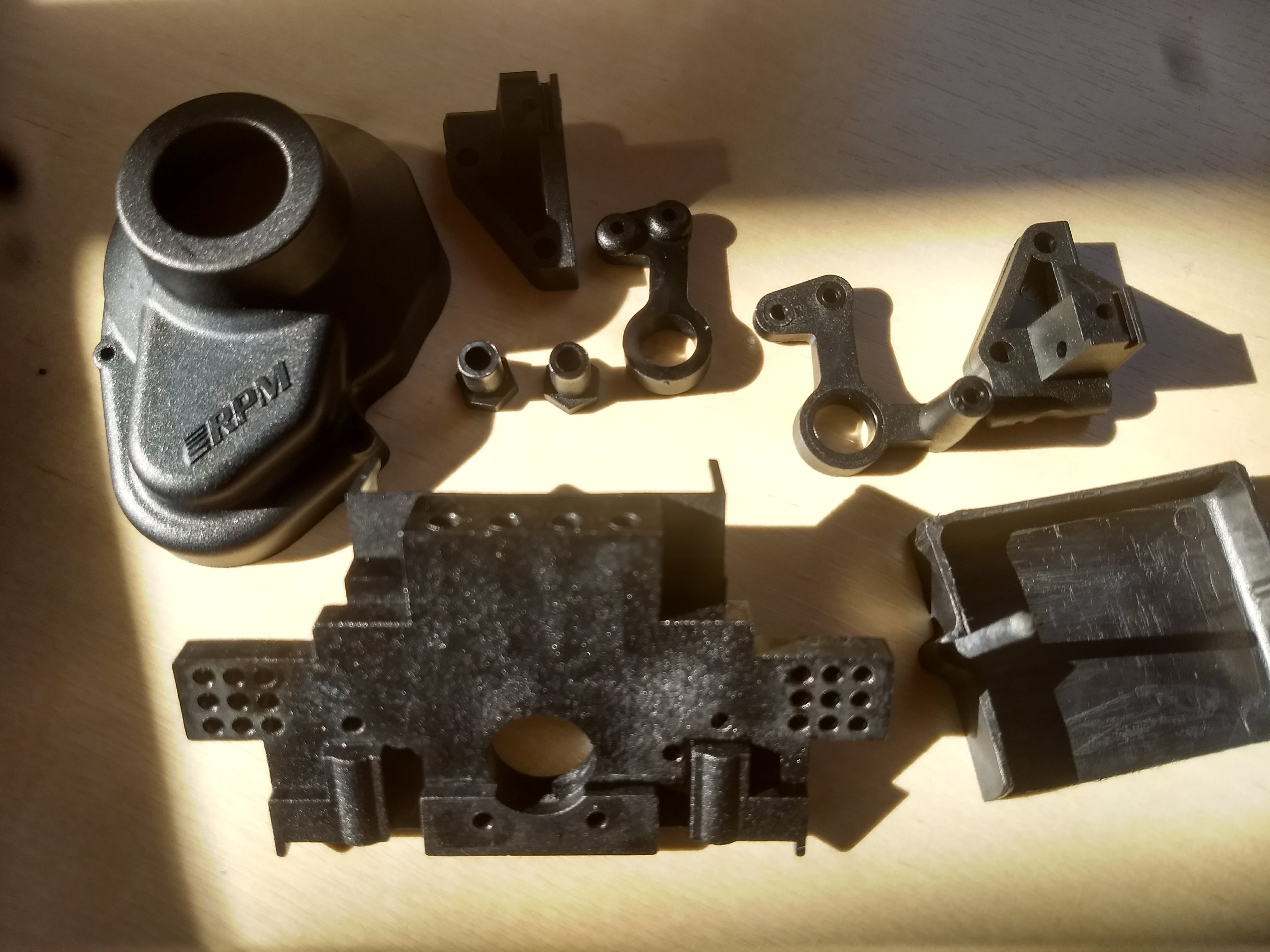

They've been sharpie'd to death, they're probably waterproof/tight/whatever word means that ALL pores are filled by now

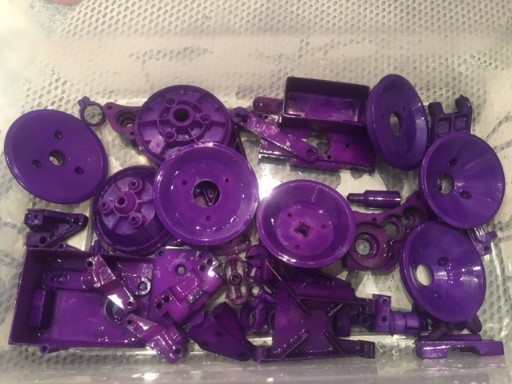

This was RIT dyemore royal purple ... all in one batch. Parts were cleaned and peroxided before. It came out pretty good IMO.

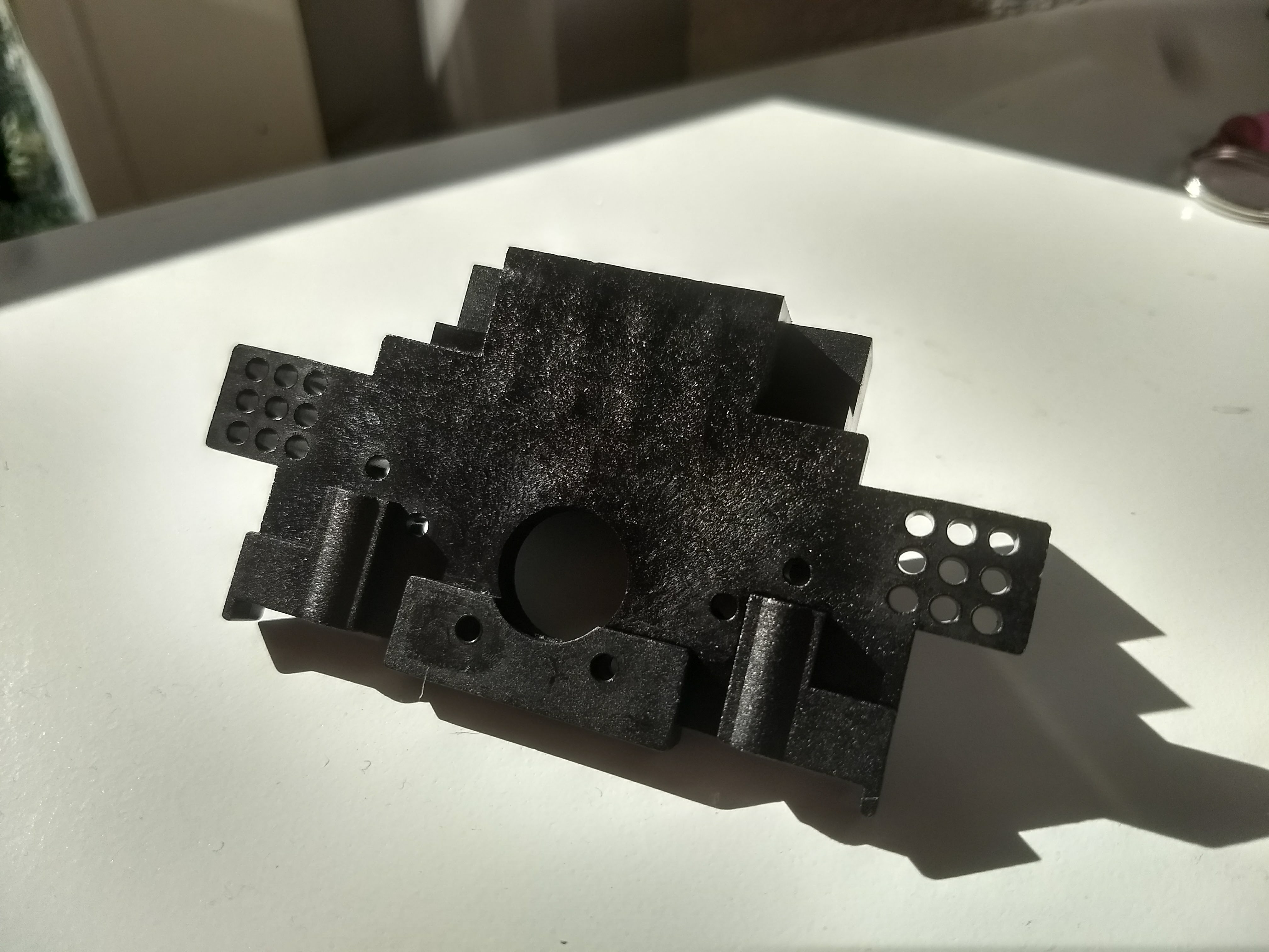

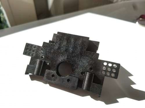

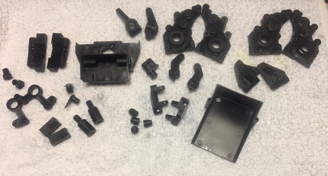

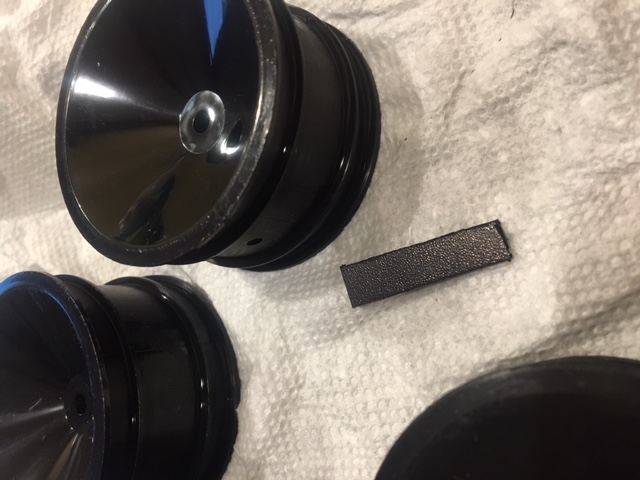

I know you guys don't give a crap because you've done it 100 times already, but I still feel the trauma from when I tried 10 years ago and it miserably failed...
... but this time I think I can claim success thanks to your help
(not a hint of purple even bang in the sun AND overexposition)
So here's how I did it.
- 1hr simmering, a few drop of dish soap in there, as little liquid as possible while keeping parts submerged
- about 24hrs cool down in the bath
- rinse with warm water
I poured the liquid in a jug for future use... I have a bit less than 1L of black stuff.... was concentrated as hell
Thanks all! I can now keep going with some of the builds
Paul

Yep, that definitely looks BLACK!! Looks really good Paul. It would be an interesting experiment to toss into the process a sacrificial part then slice it open to reveal how deeply the dye has penetrated.

Looks like you have a "black thumb" for this kind of work!
