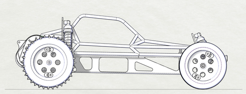

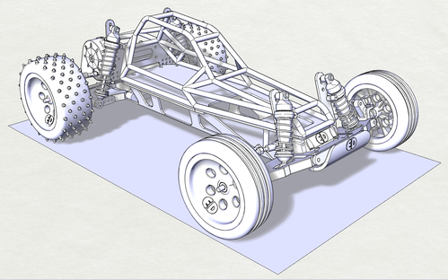

Re: MR ED 's ultima hop-ups
First estimate: around 160 euro including shipment.
To get there, I had to reduce the overall size: shorter lower and narrower, and reduce the print time = fewer pipes and lower total length of pipe
I tried to keep the styling similar but yeah, I know it's not the same...
Yes. I believe the price is determined in part by the space the part occupies in the printer. So just puttin on antenna on the roof would raise the cost.
If I knew exactly what the cost components are, I could redisgn the cages accordingly. But I doubt it would get much lower than 150 euro

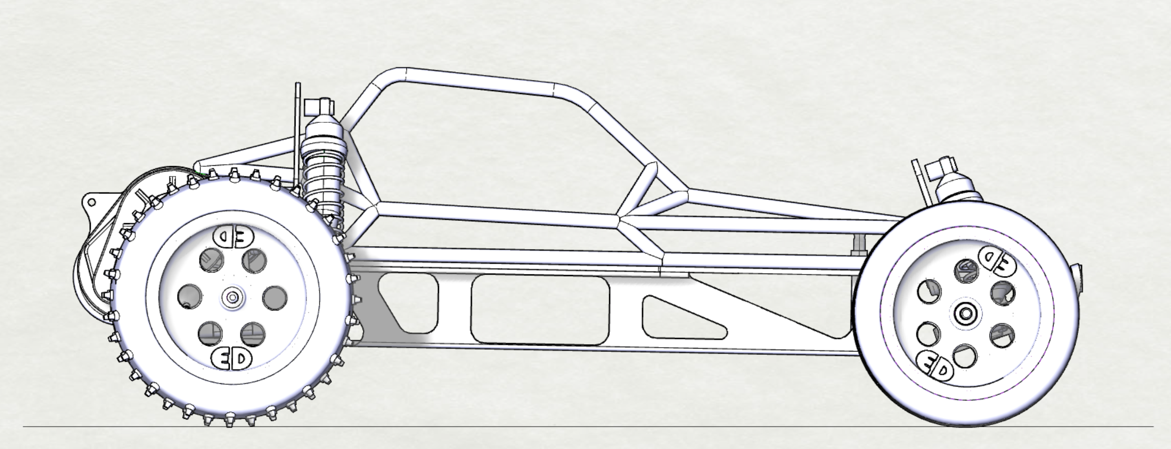

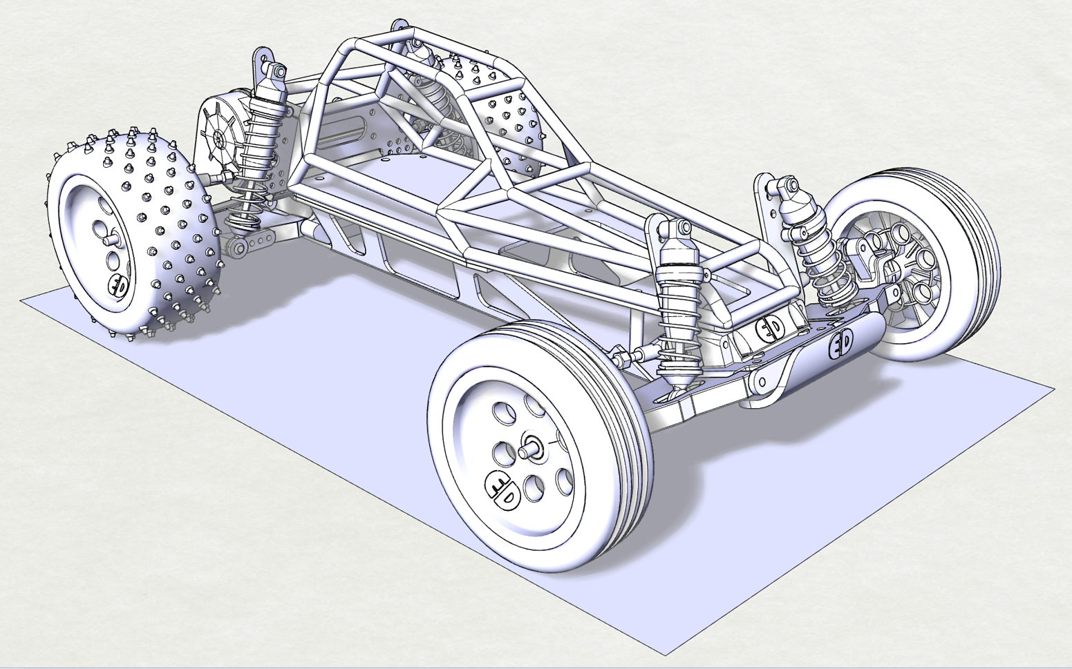

Good news on MR ED 's ultima hop-ups
While trying to figure out more about the print shops/communities, I came across a fairly local print shop.
I uploaded the narrow cage as is and got an online offer for it.
It came up being less than 50 euro. Woot!
It's not an sls print, but hp mjf (multi jet fusion technology).
The plus; it's printing nylon, with a very high resolution and accuracy. So it will look better than sls, not need postprocessing, and will have the toughness of nylon (if you keep it from dehydrating).
The minus: only dark grey or black (dyed for 5 euro extra), no glass reinforced nylon
The design freedom is similar to sls and it's also available at shapeways and materialise and others. I need to check the pricing on shapeways still. Materialise was way more expensive, only slightly less than sls.
