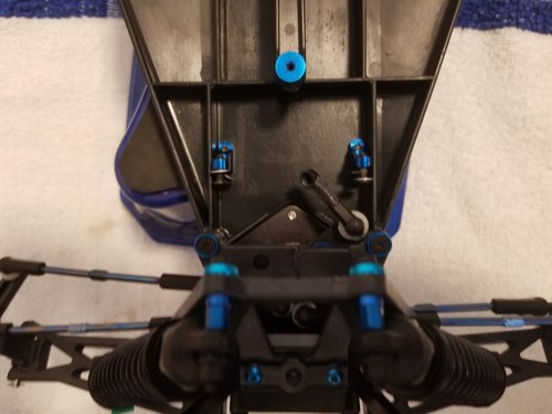

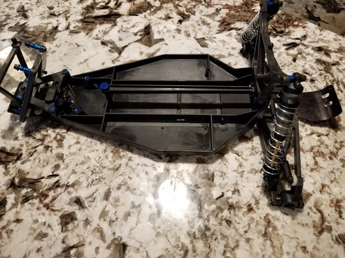

Got this far today. T4.2 top shaft and slipper where a perfect fit. Went with V2 shocks and factory team aluminum parts. Will update as progresses. This will be raced at local track.

Great start! Keep it coming.

Nice and clean, fantastic start to a build. :D

looks brand new 8) How did you get the tub so nice and shiny?
Are you using the FT parts (suspension, towers etc) ?

broodenburg wrote: Mon Sep 24, 2018 5:56 am looks brand new 8) How did you get the tub so nice and shiny?
Just cleaned well and used SC1.
Mostly factory towers and such!

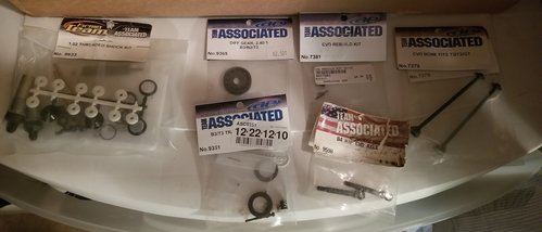

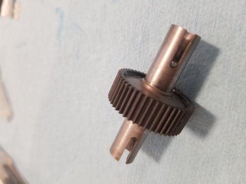

Parts rolling in. Went with B4 axels as readily available. Hope they fit!

Ahh nice updates 8) V2 threaded shocks. If you are using the B4 axle with the blue spacer you will have to use B4/T4 hubs to make the B4 axle work.

broodenburg wrote: Wed Sep 26, 2018 3:39 am Ahh nice updates 8) V2 threaded shocks. If you are using the B4 axle with the blue spacer you will have to use B4/T4 hubs to make the B4 axle work.
Yes, exactly! I was unable to confirm it would work so just figured I would try! Hopefully do some building this afternoon. Waiting on my bearing order from Avid

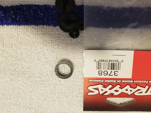

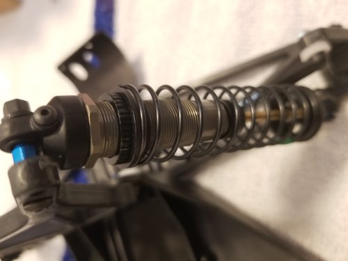

Did not want to buy the springs again from AE. So made the shocks big bore spring as i have the kits for this. Used traxxas # 3768 for the top collar. Fits perfect. Then jusy AE bottom retainer for 12mm. Feels amazing

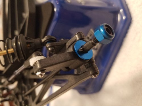

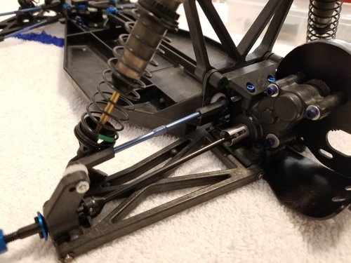

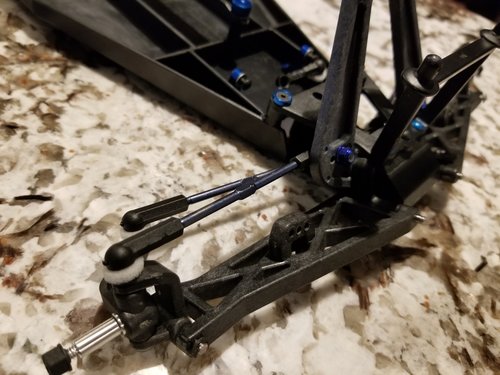

Fronts mounted. Justed needed to add a bullstud washer on top mount for spring clearance

B4 axles worked perfectly with blue spacers. Freshly built cvds in stalled.

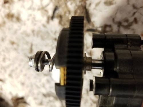

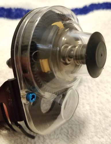

Fresh diff. Thats my stopping point until more parts arrive

Good to know that the cheaper traxxas 3768 retainers do the trick. I also have BB rearsprings on V2 shocks. I don't like how the normal rear ones rub....

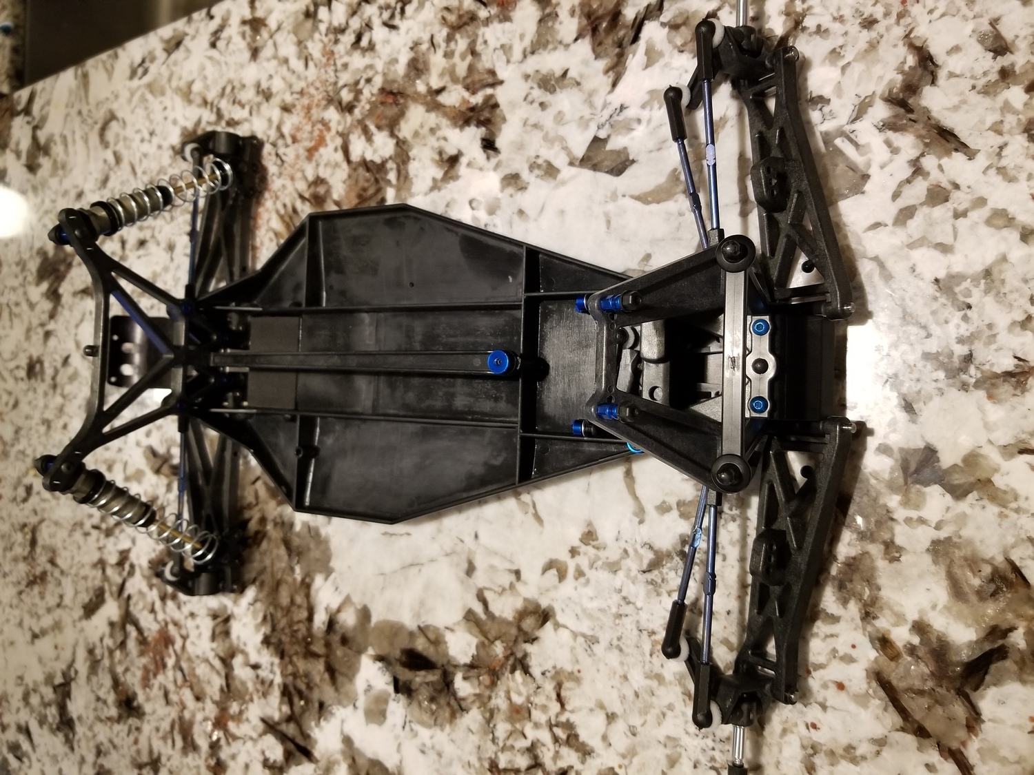

Transmission is done! Fresh Avid bearings and all new gears.
