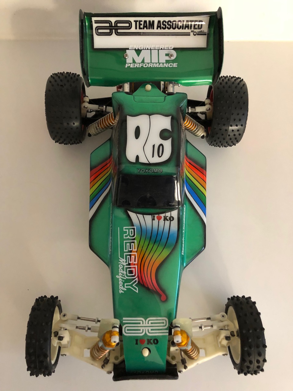

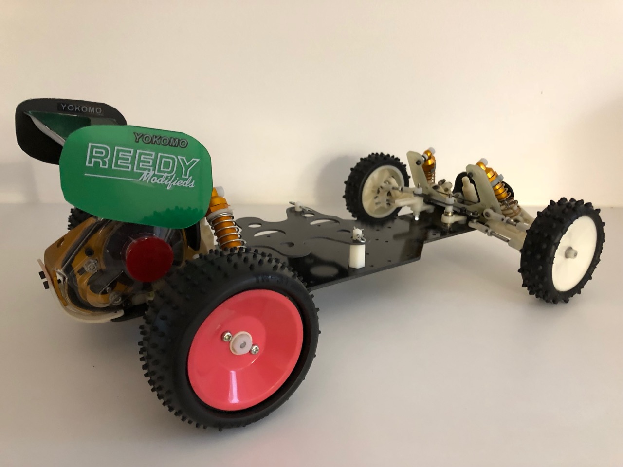

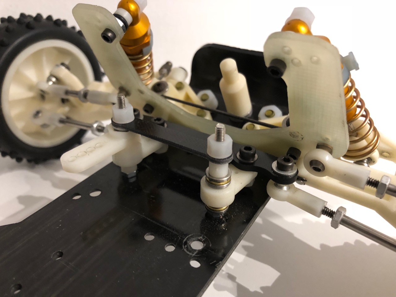

Hello everyone, still working on this one regarding the chassis and front stabilizer but so far so good.
Any help / tips appreciated to get the chassis cutouts done.
RC10 GX Masami 1989 Style

Holy smokes, another awesome car!!
I think you've absolutely nailed the Masami green, care to share your recipe?

Re: RC10 GX Masami 1989 Style
Great looking car Phoenix!
As far as cutting out the battery slots. I would draw them on CAD then print to size, glue the paper onto the chassis with a kiddies glue stick, and cut out carefully. Probably not a good idea to use a dremel. I would drill inside the lines probably corners first then a few larger holes so that I could get a coping saw in there. Remeber to use a face mask as carbon fibre is not good for your health.
Nice job
Let me know if you need an exact drawing for the battery slots.
Thanks that would be cool ! I also found someone to mill it based on that.
