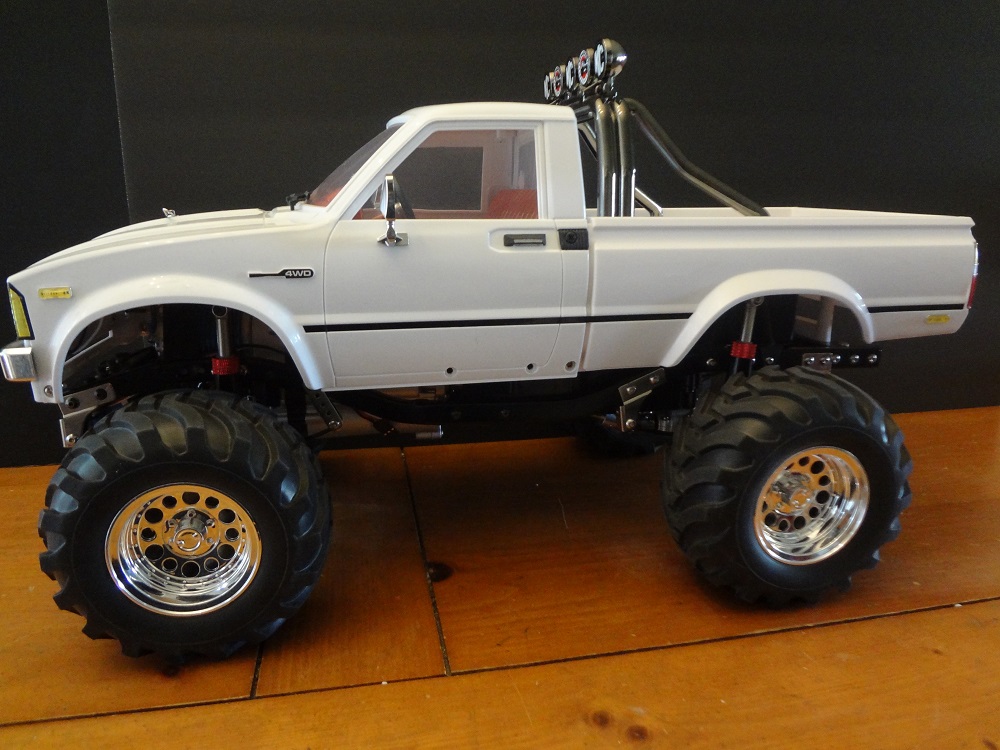

I've taken a few tumbles recently and I've cut away the front arches so far I've exposed the screws that attach the front grill/headlight panel so I had to hot glue them internally but I also cut down the big plastic bull bar front bumper , I just cut off the side parts , I think it looks quite good now .
And does it look better with Willow our border collie or without ?
- Basher67
- Posts: 1056
- Location: Medford, Or
- Has thanked: 44 times
- Been thanked: 160 times
Re: HG-P407 "Bruiser Clone" Arrived Today!
I really like what you did with that bumper.

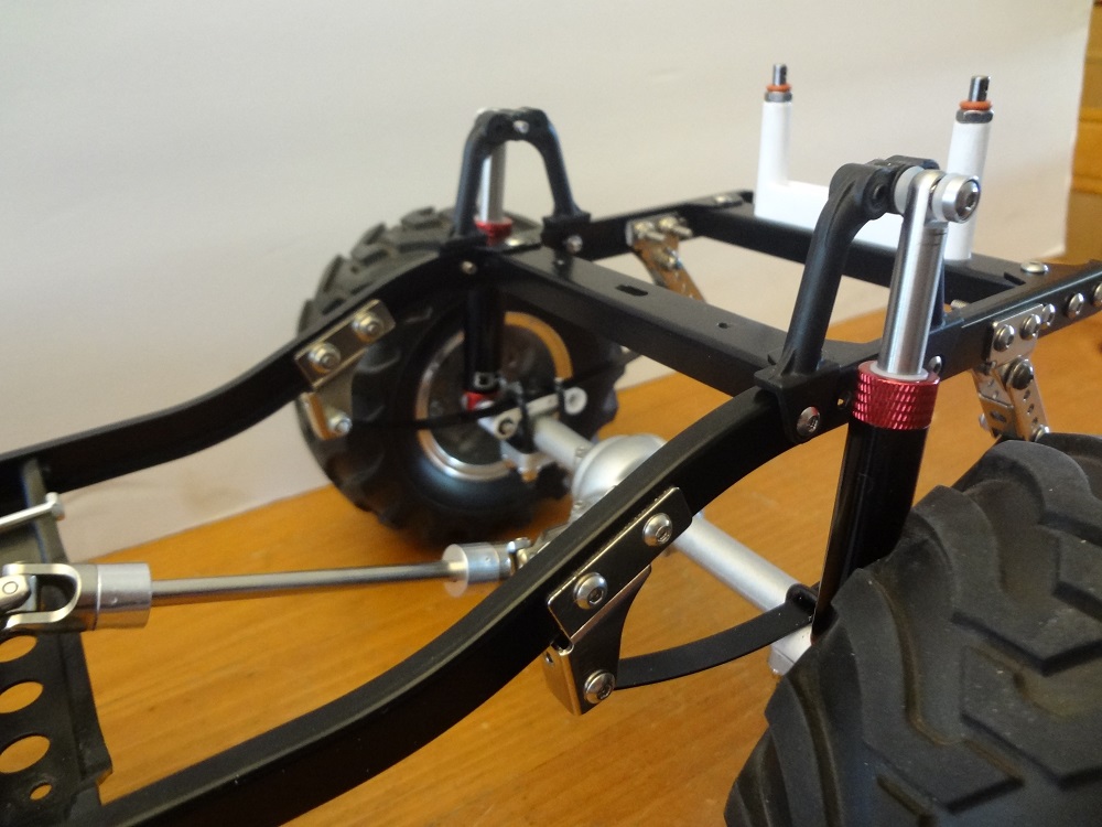

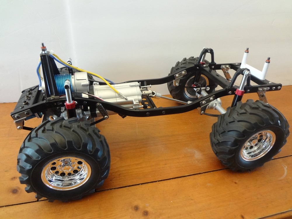

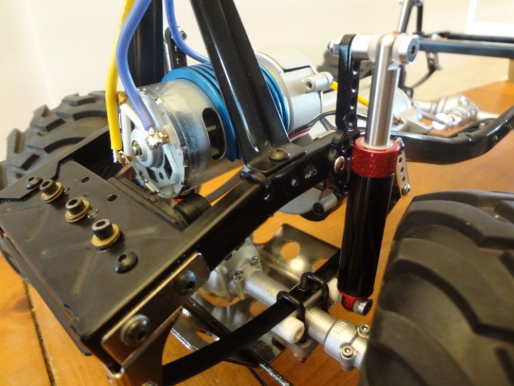

Still waiting on parts to arrive, mainly the tires. I finally got the shocks worked out and they were worth the trouble. They are super smooth. Although the diameter is a little big to be truly scale, I was still happy with the results. I used axial rear shocks hoops and some aftermarket shock mounting plates for an axial up front. I originally was going to use the plates in the rear, but because of clearance issues, I had to use the hoops to be able to space the top of the rear shock closer to the frame. I may change out the front plates to hoops later just because they look more scale.
- Posts: 4072
- Location: Guildford UK
- Has thanked: 2776 times
- Been thanked: 2253 times
That all looks very tidy , I like the hoop mounts at the rear and agree about fitting them up front too, you went for the front shock behind the axle as well , it does give a much straighter track rod to the servo and must be better geometry . Do I also spy a motor change ? What did you go for ?
