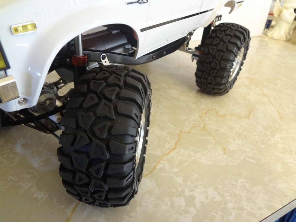

Looking good. That seems to be the most popular tire to swap onto these trucks.
I got my new tires in the mail and finally got them mounted. They don't fit onto the bruiser wheels tightly and it would be easy to accidentally glue one off-center. A little bit of patience and some careful gluing and all was well. I really like the looks of these tires, but I would not classify them as crawler tires. They are softer than the stock ones but still far from the super soft compounds used on modern crawlers. When combined with the locked axles and the flexible suspension, I think they will be fine.
The Hot Bodies shocks have turned out to be really good. Once I got them dialed in, the truck is smoother than I would have thought possible.

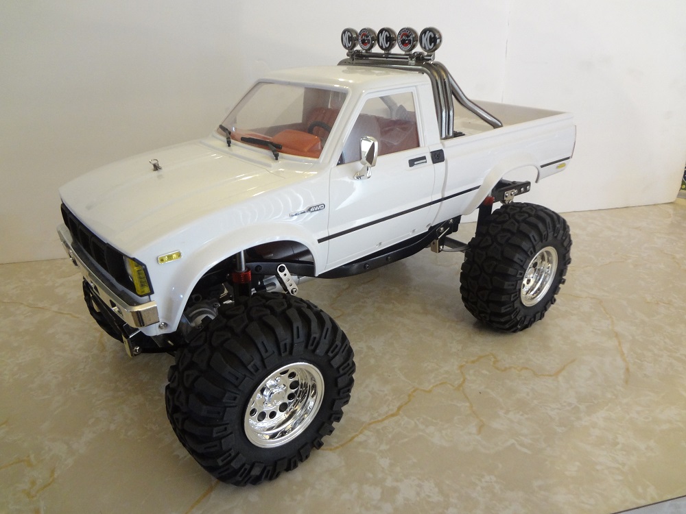

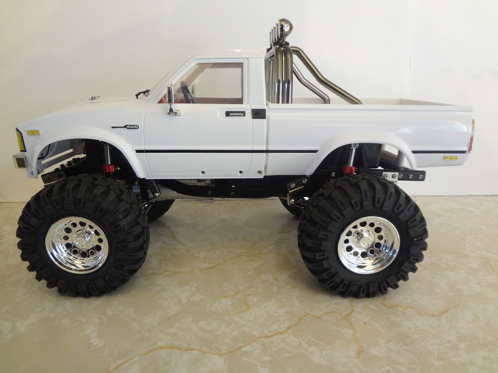

@ Kennyrach , I like the paint job , very nice , what lighting kit did you use ?
@ Basher67 , how much front arch clearance do you get with the front suspension compressed ? With the tyres I fitted I've had to cut back the front arches quite a bit .

Re: HG-P407 "Bruiser Clone" Arrived Today!
Dadio
The light is his one
https://www.ebay.com/itm/New-1-10-RC-Car-truck-LED-Light-Kit-Brake-Headlight-Signal-Fit-2-4ghz-PPM-FM/371806829556?ssPageName=STRK%3AMEBIDX%3AIT&_trksid=p2060353.m1438.l2649
The brake light mounting hole will need to be drill out to 5mm that all i has to do
Basher67
These are tire i on my truck
AUSTAR
AX-5020 1.9 Inch 120mm Rock Crawler Tires for 1/10 RC Car
Cost only $22.00 shipped
What mfg and model of tire on your truck
AUSTAR
So you stretched 1.9 in tyres onto the stock 2.2 in rims ?
Definitely rubs on the rear of the front arch. Waiting to space out the front wheels before doing any grinding on the body. Finally ordered a driver so one of these days I'll get to my interior and get rid of the orange.
