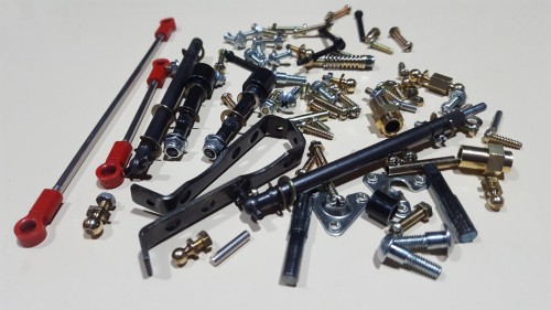

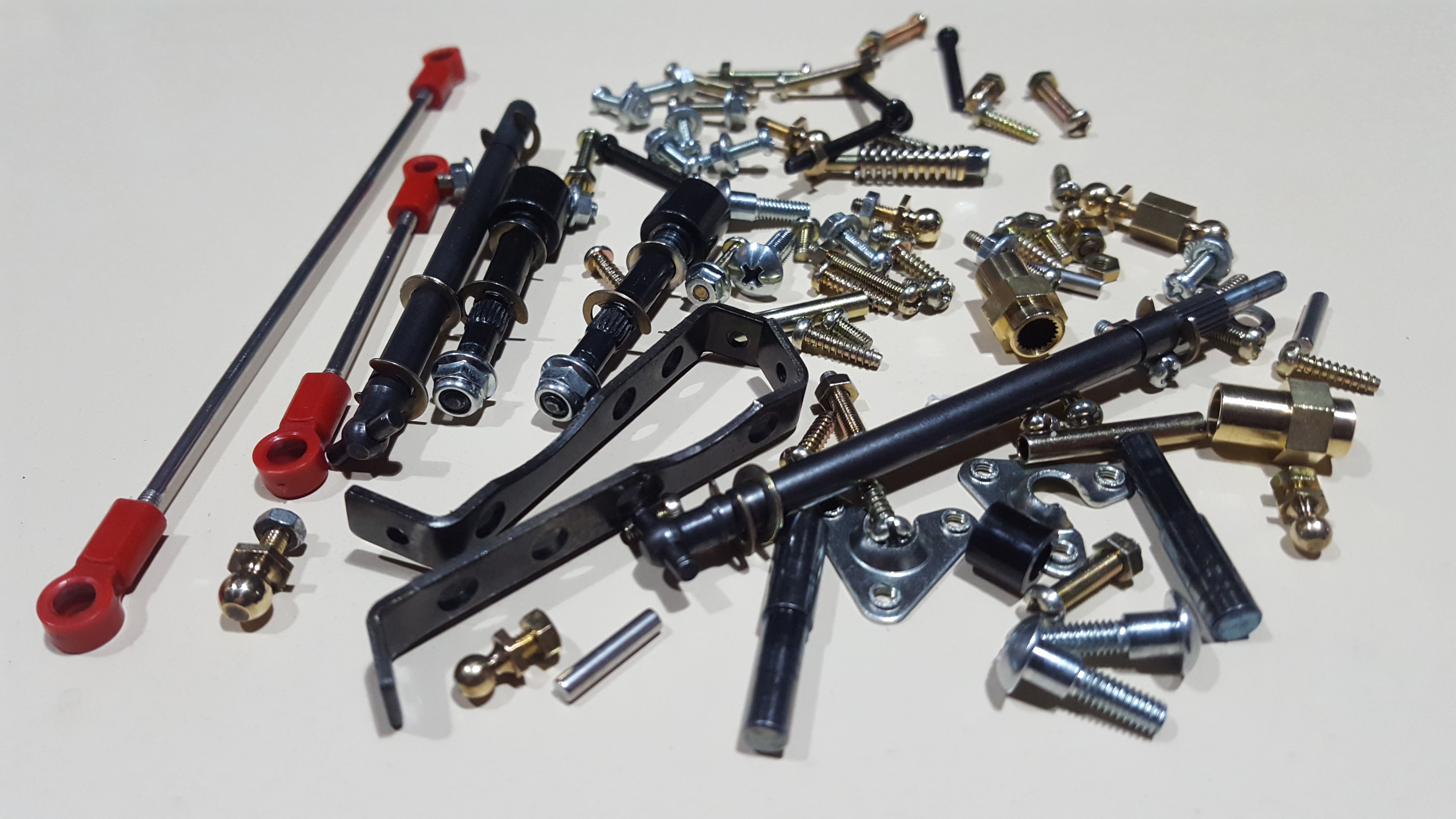

No special technique except patients, each bolt, screw and nut hand cleaned. Everything was in good shape so screws were just chucked in drill and polished with an old t-shirt. I used metal polish on the screws that were more tarnished, except you can't use the polish straight, you need to use the light black residue remnants from polishing somthing else otherwise you'll strip the zinc plating right off the screw.... works pretty well. The nuts you can use a heavier polish concentration due to the less aggressive nature of hand polishing.
Overkill? Probably..... but I want to keep it as OE as possible and Tamiya screw bags aren't cheap or easy to find here.
I finished up the front axle hardware tonight so only have rear hardware to go.

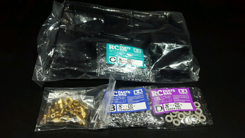

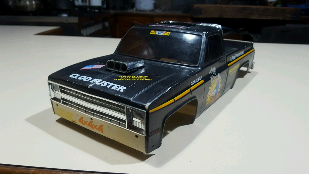

My screws finally came, I only need 1 or 2 things out of each bag which is kind of annoying but that's Tamiya
Just need to work on the body now, kinda sad pulling all the decals off....
