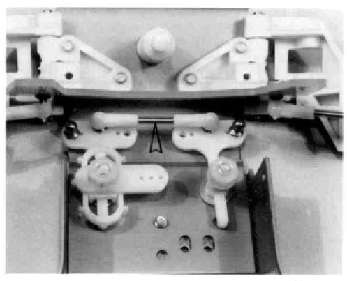

I have RC10's with original 'cranks (like shown below), Worlds, and A&L 'cranks and the ball bearings do reduce steering slop.
However, there's more to it than bearings; worn ballstuds, ballcups and even worn hinge pins can contribute to sloppy steering. Even brand new ballstuds and ballcups, right out of the bag, can be loose.
I've never owned an RC10 with steering as tight as, for instance, a Schumacher CAT or a B2/3.

Yes, the original RC10 servo-saver was notorious for being loose. Many who continue to run them (myself included) have used tie wraps to remove the slop - but of course this negates the "saver" function.dabigboy wrote: ↑Thu Oct 03, 2019 8:07 pm Thanks for the tip on the Worlds linkage, gold! I just ordered the 6254 and bearings. I don't need fancy on this car, just something nice and functional.
The main source of the slop on mine is the servo-saver rig, the steering arm doesn't fit very tightly in the other part of the linkage. There may be wear elsewhere but it was not immediately noticeable (car is in pieces at the moment), I'll give this a shot.
Matt
